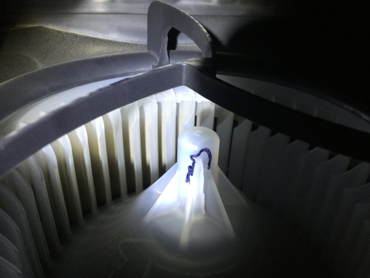

    Just had it done last week i have ACC and was before the letter vin date . they tried to say the crack wasn't that bad , my reply was don't care its cracked and my 3/36 runs out soon so change it..

    Good for you. Hopefully it was the new upgraded unit, but good that you got them to change it out either way.

    I went to the parts counter and looked at it. had a date on it 08/2018
    they asked me how i knew to look for it as it was only cracked and not making any noise (i won't get the letter, to early of a build 2/2016) and i told them i saw it when i changer the filter, i lied and read it hear and looked.. and told them i also know my truck. i want the truck to last 15 years so now i have a 3 year newer blower .
