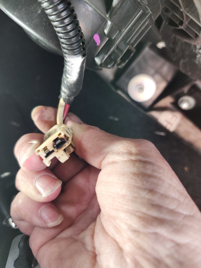

    Well, my buddy got it off, along with the airbag, so Im kinda anxious about that hanging there. Im trying to replace the resistor first, to see if that does the job. At the moment, Ive got the resistor out, but I see no damage to the connector/harness on either side. No burn, melt, discoliration to speak of. Is that even possible, to have a burnt resistor with no harm to the harness?

    17436378044278815857454363316570.jpgBut this little gizmo coming from the resistor that plugs into the blower motor is clearly burnt. Havent seen that mentioned anywhere. Maybe that can be replaced? The female end doesnt show any damage, but Im guessing this is where I have to accept that the blower motor has to be replaced too, not just the resistor.

    I am having the same issue. Did you replace the plug?
