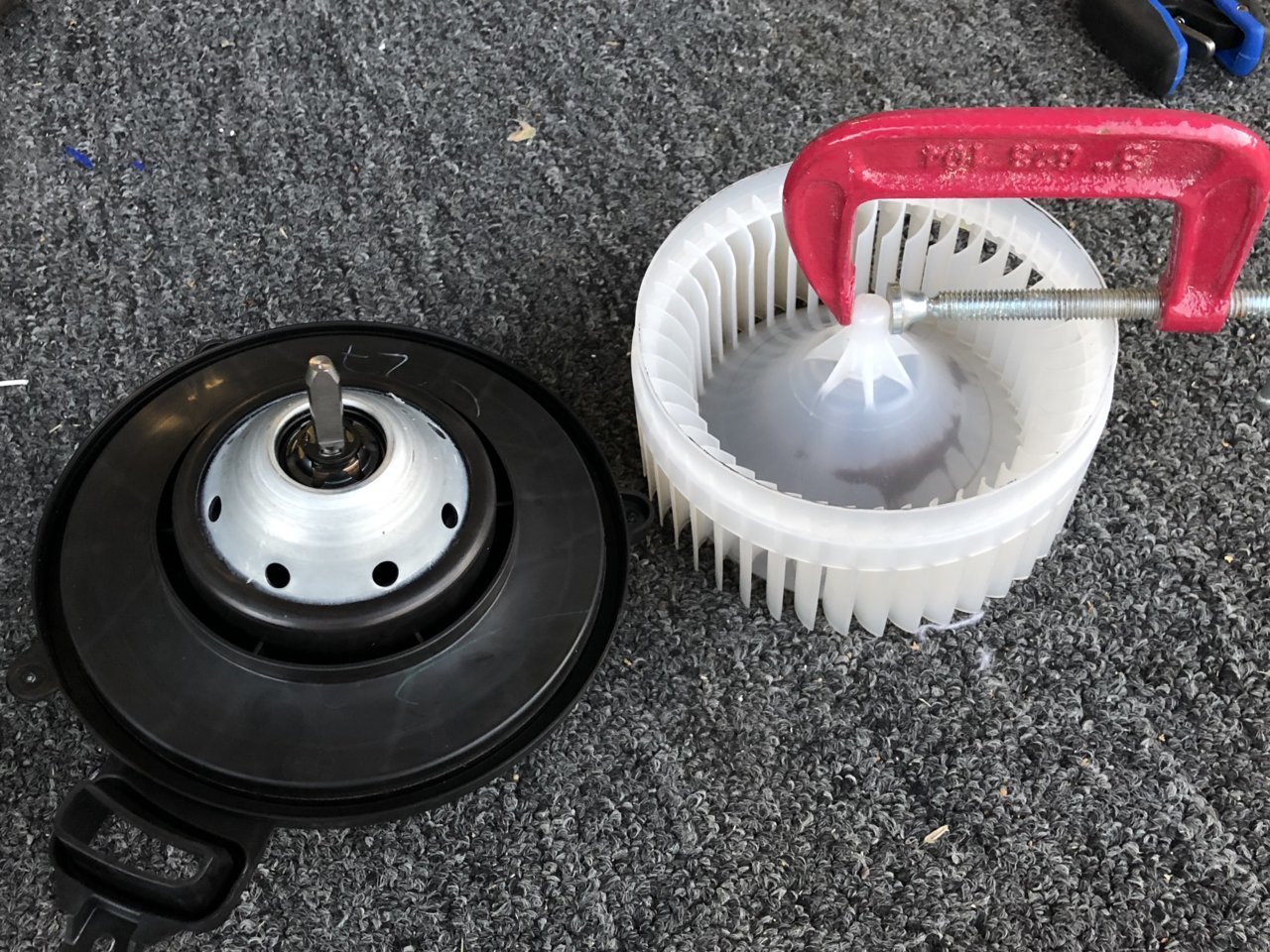

    192

    A few OE parts from fancy trucks
    Its not the blower motor. Or the connectors 2nd gen was plagued with.
    Its the fan. Plastic squirrel cage that sits on the motor shaft
