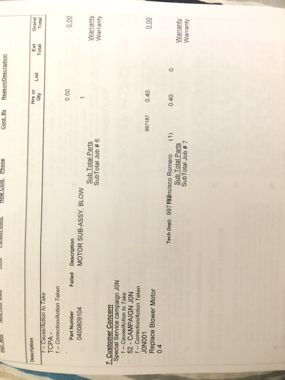

    I took my truck into the dealership about 2 weeks ago because I was hearing noise coming from the glove box area that would get louder as I would crank up the fan. The found that the blower motor was seizing and replaced it in about 30 minutes.

    What’s it doing? Apparently the issue is not the fan motor but the plastic squirrel cage blower attached to it - the plastic shaft sleeve is cracking and the blower doesnt spin so the air slows down comming out of the AC vents, no matter what setting you use.

    Yup, that was the defect- squirrel cage shaft sleeve breaks on the motor shaft.

    Here’s my service receipt for the blower swap:
