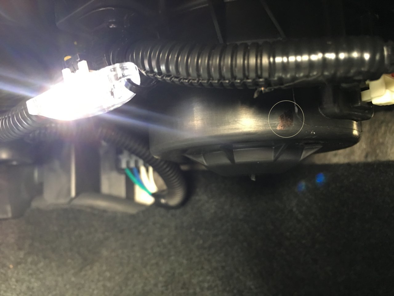

    I took my truck to delaer for the “recall” this morning. And I doubt that they didn’t do anything, because I did a check mark with a permanent marker on the body of blower motor and it’s still there. I am not sure what need to changed, the whole motor or some the part inside?
    Anyone know what exactly they change? Thanks.

    The fan (plastic) and the blower motor constitute one part number. The plastic fan is not sold separately. To replace your plastic fan, the entire motor and fan assembly is what is replaced.
    Your sentence "and I doubt that they didn't do anything" wouldn't get past your school teacher as it's really confusing. What I interpret this to mean is I doubt they did anything. Is that what you meant there? Because if you made a mark on the body of the blower motor, and it's still there, then they didn't put in a new unit for you. I think this sounds rather ominous. Did you get a notification letter? Was your truck within the production dates listed and did all the parameters of the Service Campaign apply to your vehicle?
    What did your paperwork say at the completion of the work? That would be an important document. Photo that and post it up for us.

    Thank you mr. Opili59, I appreciate your input. I am so sorry about my broken english :), I just came to US about two years, I’ll try my best to improved my english.
    And yes sir, I think that they didn't put in a new unit if its as you said the blower motor constitute one part number.
    I did come back to the dealer and talk to the advisor and he told me that they only changed motor inside and not the whole case. So can’t argue with him because don’t have enough knowledge about what to be changed

    Apologies, didn't realize this was an ESL (English as Second Language) issue. Let me be the first to complement you on your abilities to communicate so well in a non-native language. I wouldn't even be able to ask where the bathroom is in your primary language I am certain. You're doing fine, and I'm impressed.
    As far as the motor replacement goes, be comfortable in that they did do your motor upgrade. While I have taken mine out several times, I have not separated the plastic housing you marked from the motor inside. Apparently that plastic housing-the one you marked-does separate from the motor and fan unit inside. I know the motor and fan to be a single unit, but the visible plastic housing must be separate from the motor/fan unit. If I have to pull mine out again, I'll take a better look at it, as my inspection of that aspect has been cursory at best.
