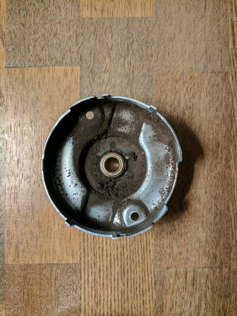

    AC always ran fine. Then it was "maybe my AC will work today." Then it was the "smack the dash" or a "light tap on the AC motor" situation. Now that will barely get it running, so I figured i'd start looking in to the problem.
    - Connector shows no sign of heat or wear.
    - Haven't checked the magnetic clutch relay yet.
    - Started disassembling and wow, it's filthy. A good cleaning may not fix my AC, but it can't hurt when things are this grimy.
    Update: Much to my surprise, a little light brushing with a toothbrush, wiping with a paper towel, and blowing with my lungs, then reassembling and installing...and my AC not only kicked right on for the first time in months but it is also blowing nice and hard. All for the low price of $0 and ~ 20 minutes! Will it last? That remains to be seen, but I'll take what I can get.

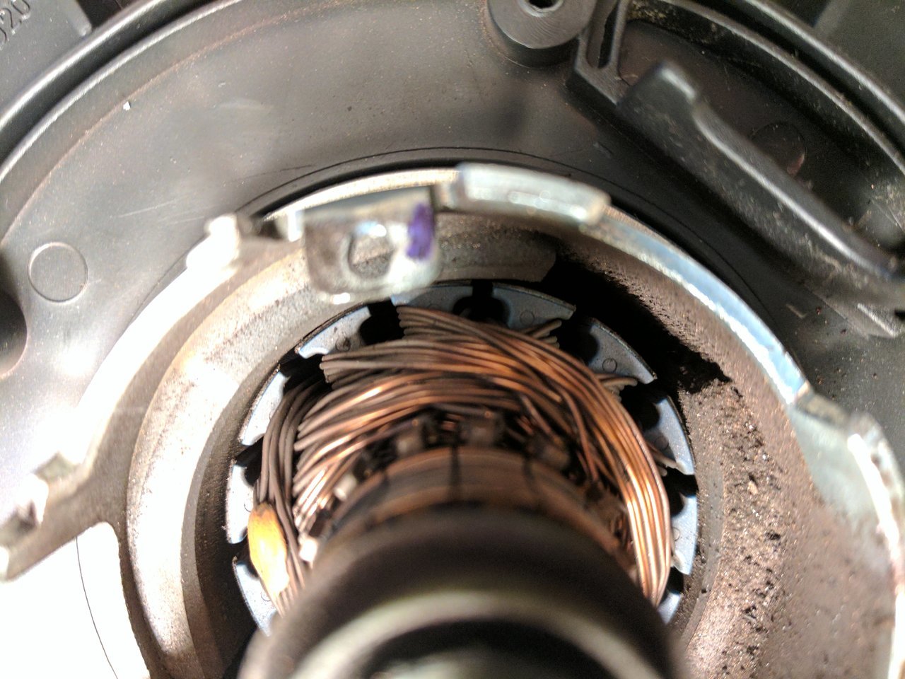

    Great suggestion, I had done the same to my blower before checking this forum. Unfortunately the darn thing started squeaking and slowing way down again just two days later. It may have received too much bearing damage before I repaired it? Anyway, I ended up replacing mine for $45. Decided to make a video of the process and sharing it here- hope this helps some members out
    3 Easy steps to replace your blower motor, plus suggestion on replacement part manufacturers quality and link to buy good replacement blower-
    https://youtu.be/BF3FGGNSgoc

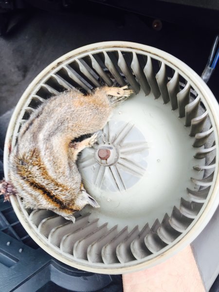

    Well, mines wasn't as grotesque as the guy with the squirrel above, but I did have enough dirt that it was beginning to grow grass/moss...

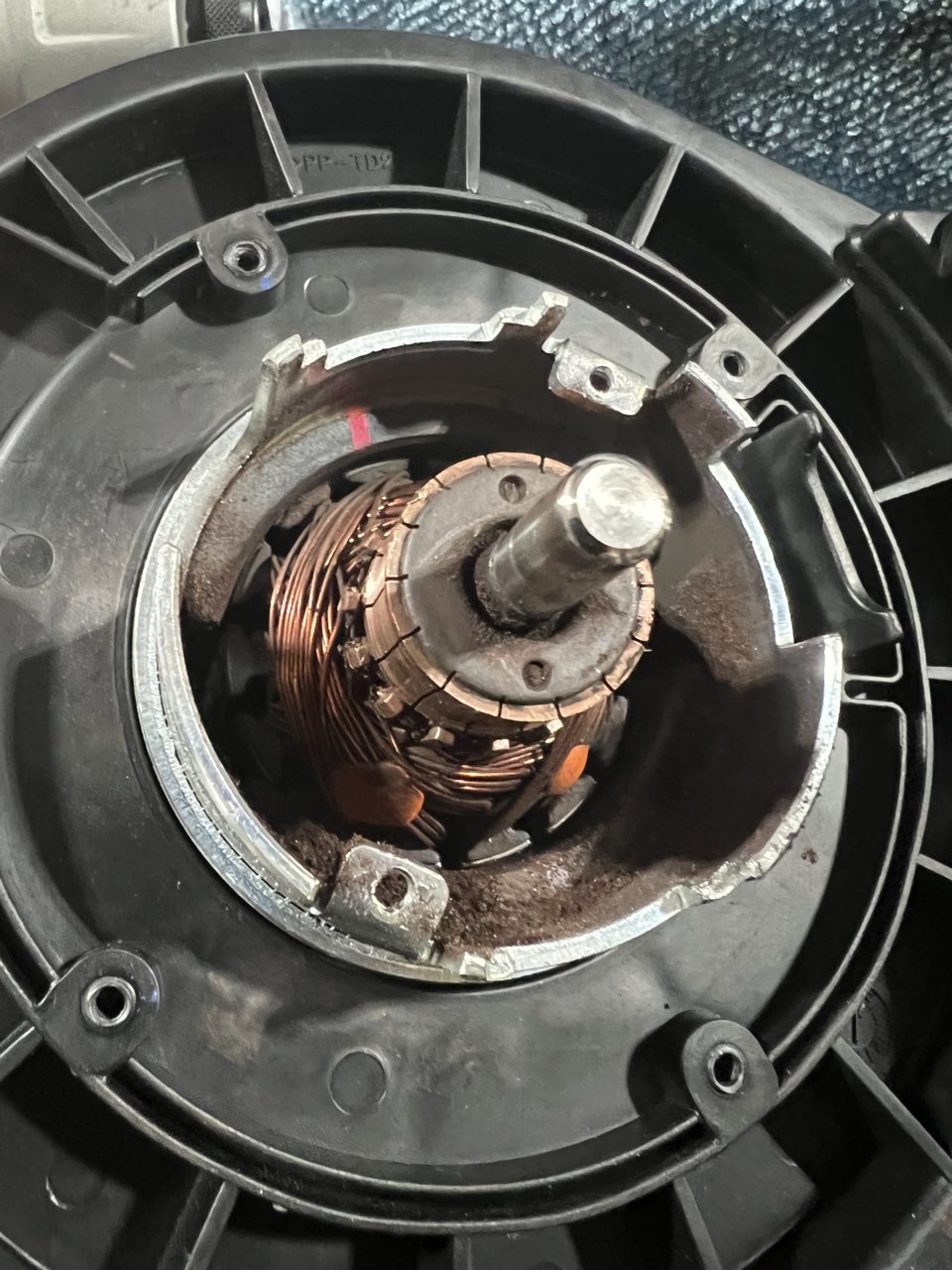

    Anyone take the motor apart? How does it release from the housing. I’m stuck at this point.
