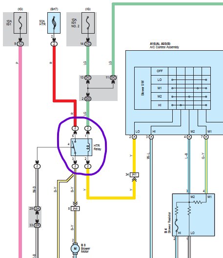

    I don't see that you checked the heater relay? Heater relay causes current to flow to the blower as soon as switched to LO.

    Yes we checked the relay first by swapping it with the one next to it which is the same, still did not work. Ended up changing the resistor which made no since to me since the unit wasn't working on high either... We had the cabin air filter out and spun the blower motor by hand with no resistance what so ever. Like I said changing the resistor worked for 5-6 days and the quit again.. Son is supposed to carve some time out for his old man this afternoon, he can stand on his head longer than I can under the dash...

    How are the wires on the back of the AC control assembly? I've seen those burnt (the heavy gauge wires).

    They looked fine... Not loose not burnt, switch working as it should..
