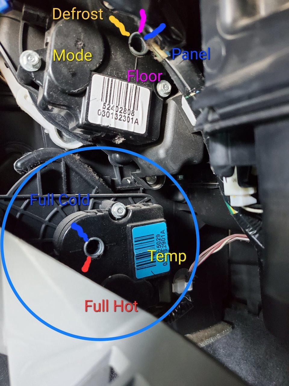

    @Dm93 has a good picture and diagram of the actuator.

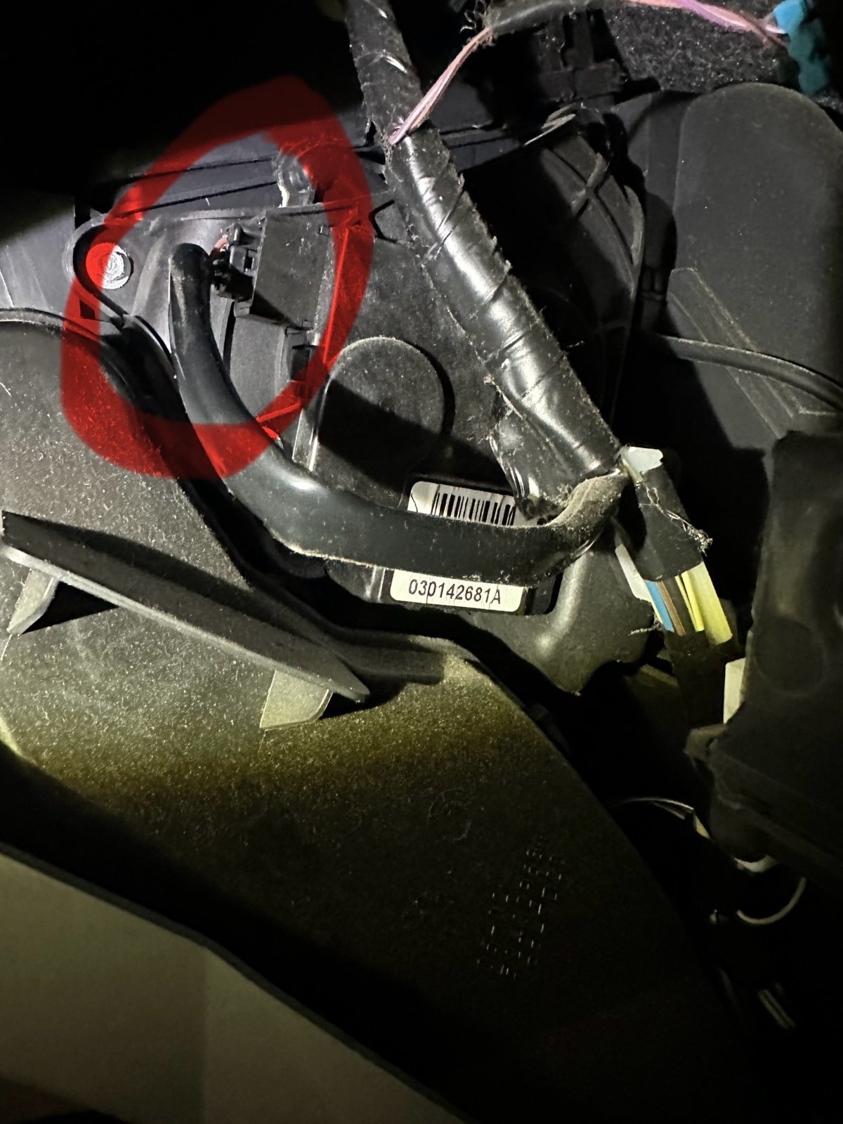

    You can pop the glove box loose and see this. Just took this on my 2015 prerunner so yours is the same. IMG_2030.jpg
