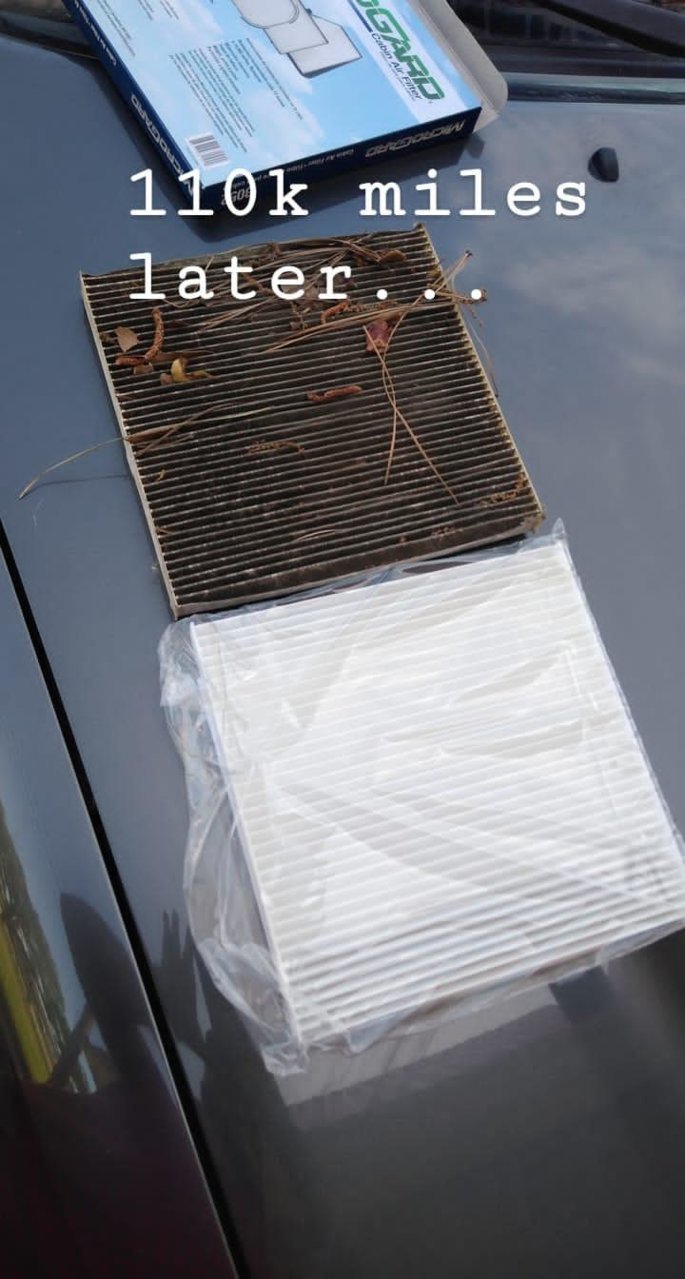

    Just changed the cabin air filter, it was atrocious.
    The speed and volume slows down after about 20/30 mins then it starts blowing warmer air about 10 minutes after.

    I seriously hate to admit this, but I didn't change my cabin air filter for 110k miles. So there's that. I'm sure it made the system run a lot harder than it should've. The filter looked terrible.

    I would've liked to have seen how bad that filter was! Jeez. 110k ....Mine is dirty after 10!
