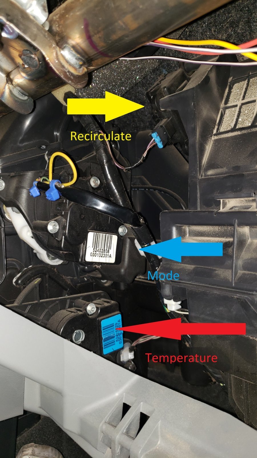

    No the actuators are the motors that move the doors in the HVAC unit, they are located behind the glovebox.

    oh I see, thank you for the photo that helps a lot. Good to know I only need to access the glovebox. Will consider this in the future.

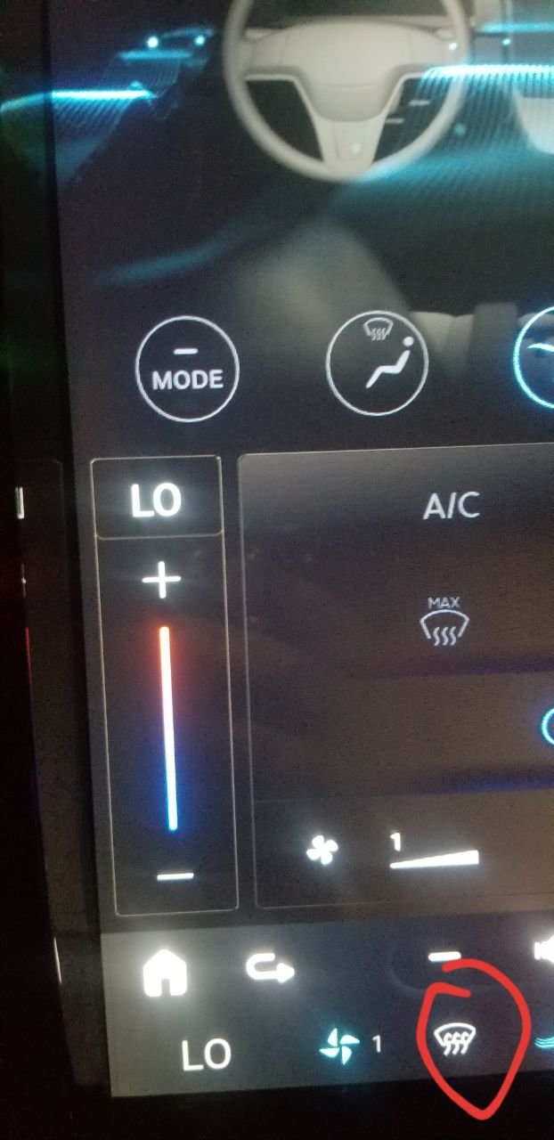

    That's awesome! Thank you, I'll give it a shot tomorrow morning just to make sure you mean this one I circled: upload_2024-2-16_0-39-54.png

    Not the soft button in the screen. The hard button on the right side bezel. That’s the defrost bottom you push and hold for 5

    Oh, I understand! The actual button with this logo! Yeah, it has the two buttons above it with "temp -", and "temp +"
    Thanks!
