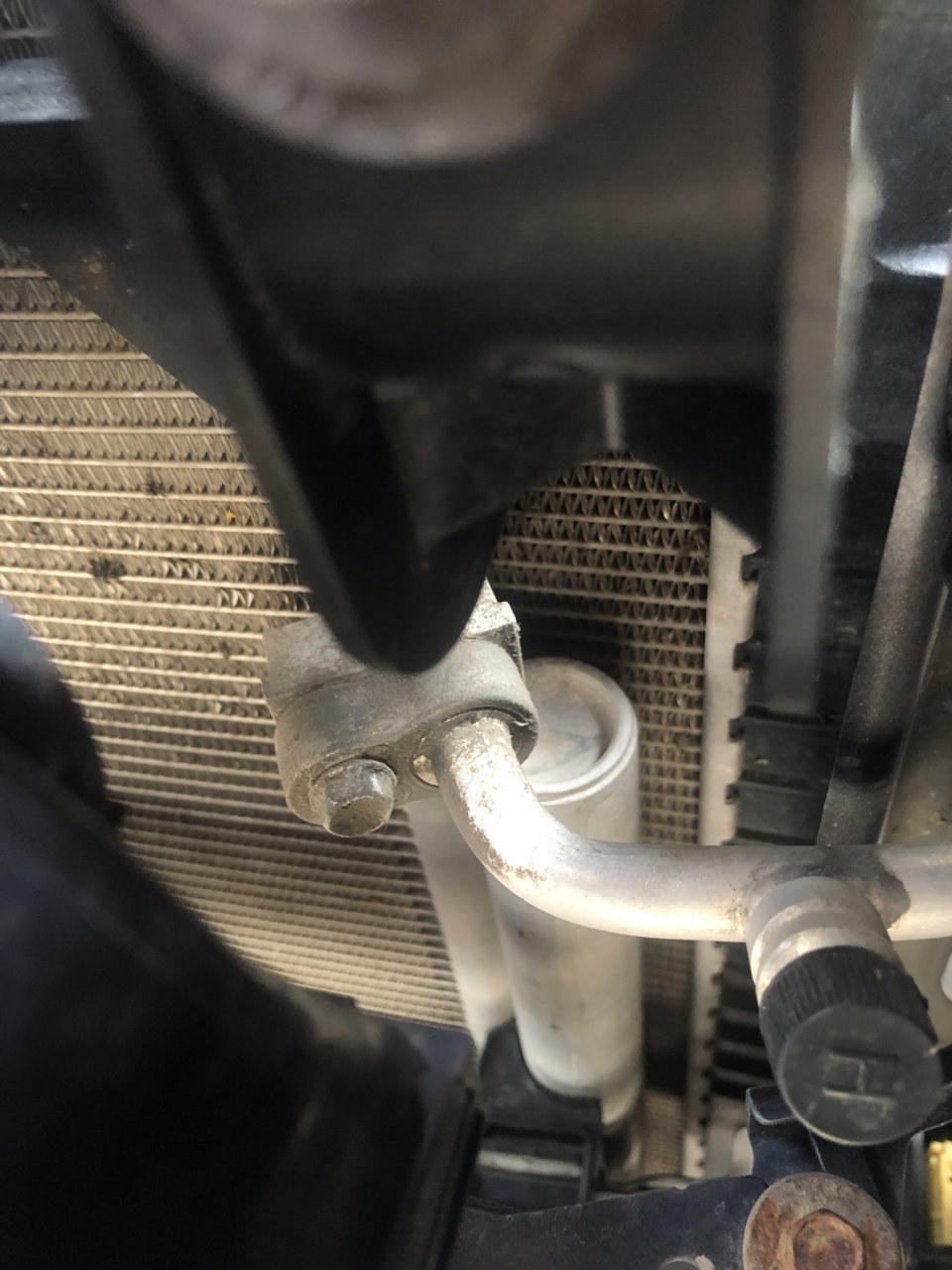

    yes it’s the same seal, if you open your engine bay and look through the top portion of the grill you’ll see a silver line with a black cap and the letter H. If the connection right there is anything like mine it’ll be covered in crud which is the compressor oil leaking out.
    Unfortunately the dealer service is the proper way to fix the problem unless you know someone with a 1234YF machine that can help you out, or if there’s a small shop in your area with a better labour rate.
