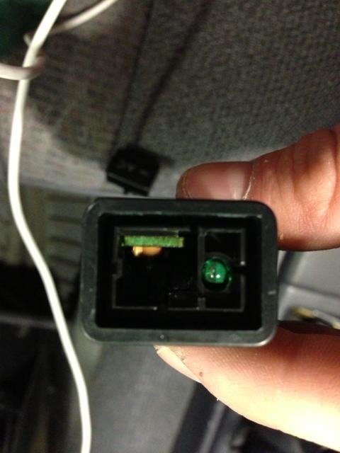

    hey for your question regarding the A/C button specifically, the green light is INSIDE of that rectangular A/C part, my button broke off from the whole part so I always have to glue it back together, let me know if you want a pic next time it falls out....

    Okay well here's the pic, I couldn't help myself but replace the A/C lights so I already had your plug out

    FYI That light is soldered onto the board inside the switch. There is another light that is removable once you take the switch apart. It has a twist lock base that is on the side of the inside part of the switch. One light is for the on/off indicator, one light is for the backlight.
