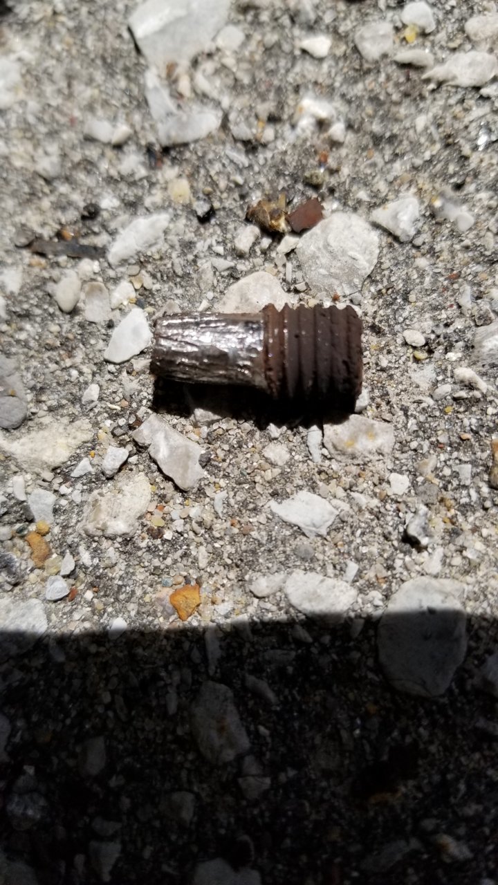

    If a bolt moves then binds, don't horse it. run it back in a bit, then hit it with PB, Kroil, what ever. Work it in and out. Bind again? Repeat. It will come out. DON"T horse it, patience. Then.. new bolt and anti seize. Rub some in your hair 1st, coz it will get there anyhow, somehow. ;)

    Its OUT! Thanks to your good advice. I was about to give up and break out the tap kit...
    Now to find those replacement bolts I bought last year!

    HOMEDEPOT M8x1.25 bolt, good work!!!!!! looks like it was a mother

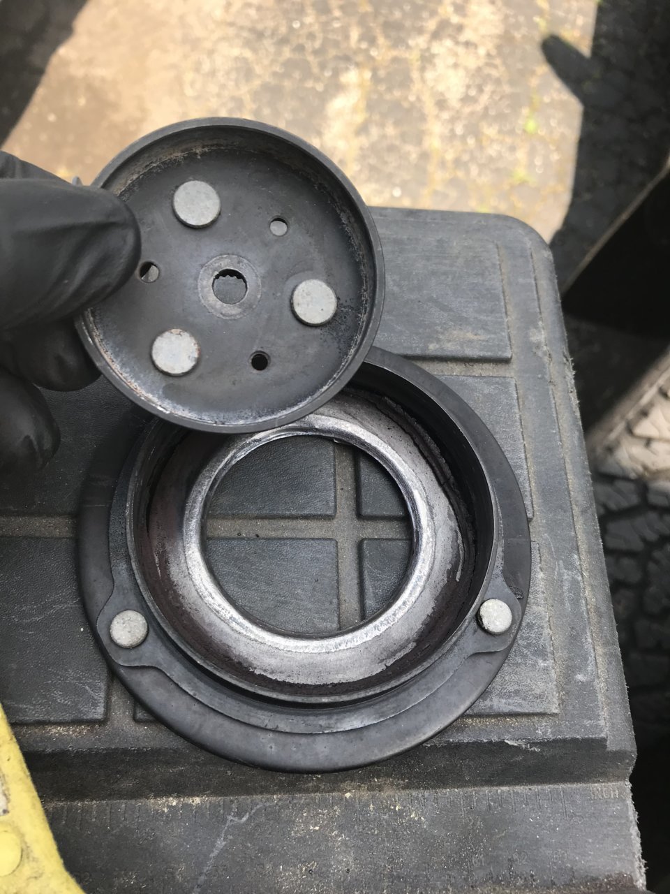

    Pretty sure it’s just the clutch again. Just getting around to looking at it right now.
    I don’t know if this video link works, but the clutch is fuuuuucked. This is less than a year/10k miles on the eBay replacement o_O
    https://vimeo.com/275498080?ref=em-v-share

  16. Jun 17, 2018 at 10:17 AM
    #196
    Sandman614
    Oct 26, 2010
    #45273
    36,044
    Tim
    Garner, NC/Boone, NC
    '06 SR5 Off Road
    Does your compressor spin smoothly? It would seem that there would be a cause for the rubber to wear out so quickly. I.E. As suggested the bearing is going bad.
  17. Jun 17, 2018 at 10:28 AM
    #197
    ChiefBrody
    ChiefBrody Well-Known Member
    Apr 23, 2013
    #102654
    199
    Michigan
    '12 Tacoma TRD Offroad
    I took the clutch off and ran the truck. No noise at all from the compressor/pulley.
    That grinding I heard was the two pieces of the clutch spinning against each other. That pic above is exactly how it came out. There wasn’t a bit of rubber left on it.
    I agree though. There has to be a reason I’ve gone through 2 of these in less than 70k miles.
  18. Jun 17, 2018 at 10:36 AM
    #198
    CurtB
    CurtB Old Timer knowitall
    Dec 30, 2014
    #145266
    7,203
    Curt
    Kansas
    2010 Tacoma SR5
    Make sure you have the proper air gap on the next clutch. Too tight and it will rub and get hot. Too loose and it will slip and get hot. Result is melted rubber. Shims and feeler gauge. :thumbsup:
