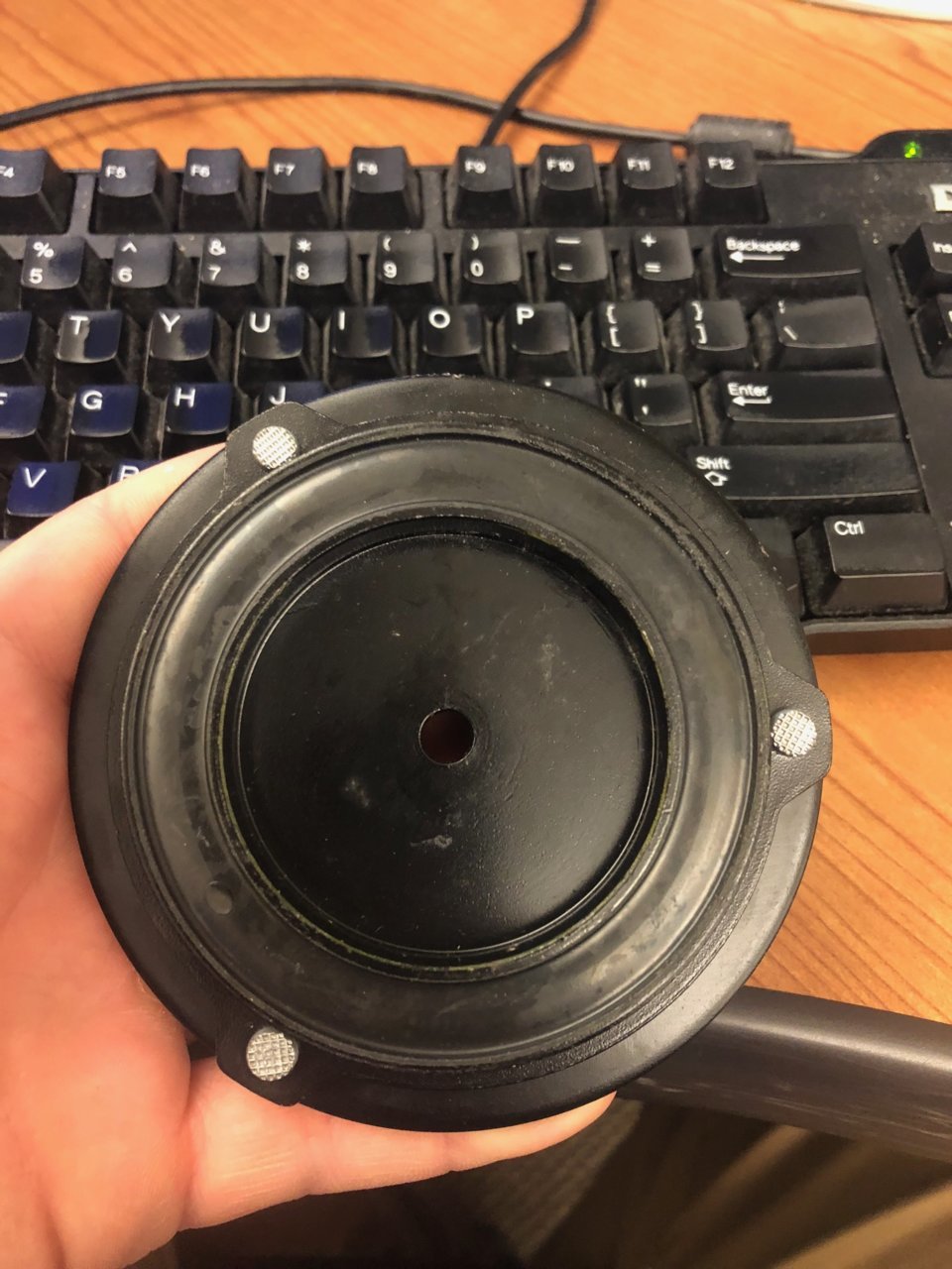

    Just replaced my hub and I finally have air again! Thanks to all that contributed to this thread. $50 and 45 mins work - can't beat that. I removed the skid plate and went from the bottom. Old hub had the rubber ball just as expected

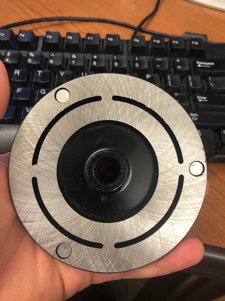

    (Edited/Updated) - This worked fine and saved about $850 from what my mechanic recommended. I just used the old washers and it was a perfect gap. Easy and cheap fix!
    Hi everyone, lots of great info on here. Thanks for sharing. I just received my clutch hub, from eBay, and it doesn't appear to be the same. With the 3 metal dots around the center. Did I get hosed here?
    Also having trouble following the washer spacing. This one didn't come with any loose washers or anything like that. What do those look like? Can I use the original washers?
    The original eBay link in this post is sold out, so I went with this one (https://www.ebay.com/itm/263797071714)
    (but again, what I got in the mail doesn't look like what is pictured in this eBay listing either).
    If it will work just the same, I don't really care. Just thought to check here before I return.

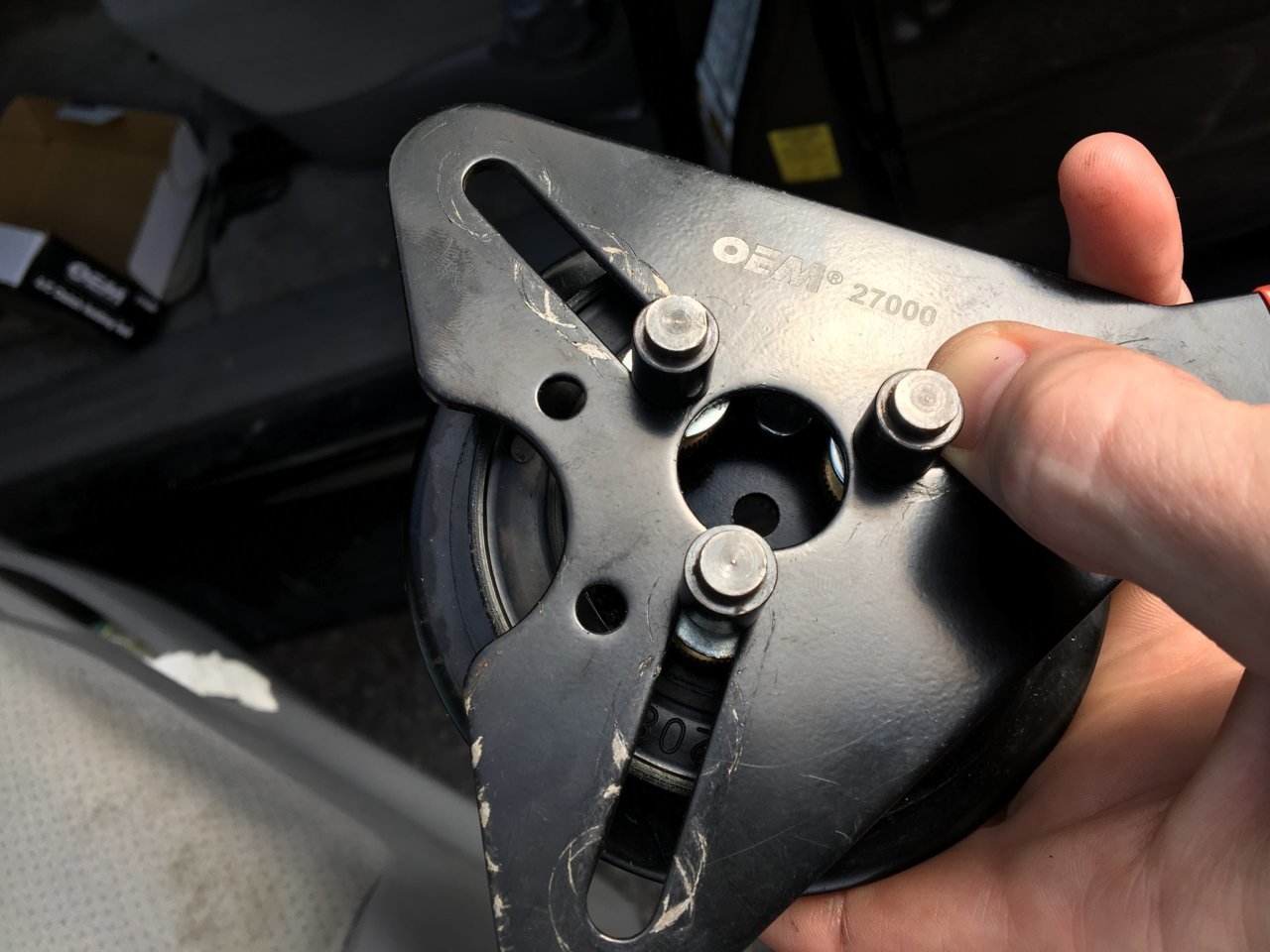

    Here is a heads up for you all...unless I am doing something completely wrong...the "Universal clutch tool" from Autozone DOESN'T fit the tacoma...IT says OEM 27000 on it and when you place the tool on it's smallest setting it's still too big for the gaps between the openings in the busted clutch....And with there being ZERO room to work with in the 2.7L 4 cylinder engine I don't know if I can get a socket in there and a vice grip to hold the broken clutch face to get it off...UUUGHH.

    KKindler
    KKindler New Member
    Sep 20, 2018
    #266880
    2
    2013 Tacoma
    I have the 2.7 4 cylinder engine. I managed to get it done by removing the fan guard and a small pair of vise grips and a socket wrench. I had to use a stool and hang in there a bit. It’s tight, but you can do it.
