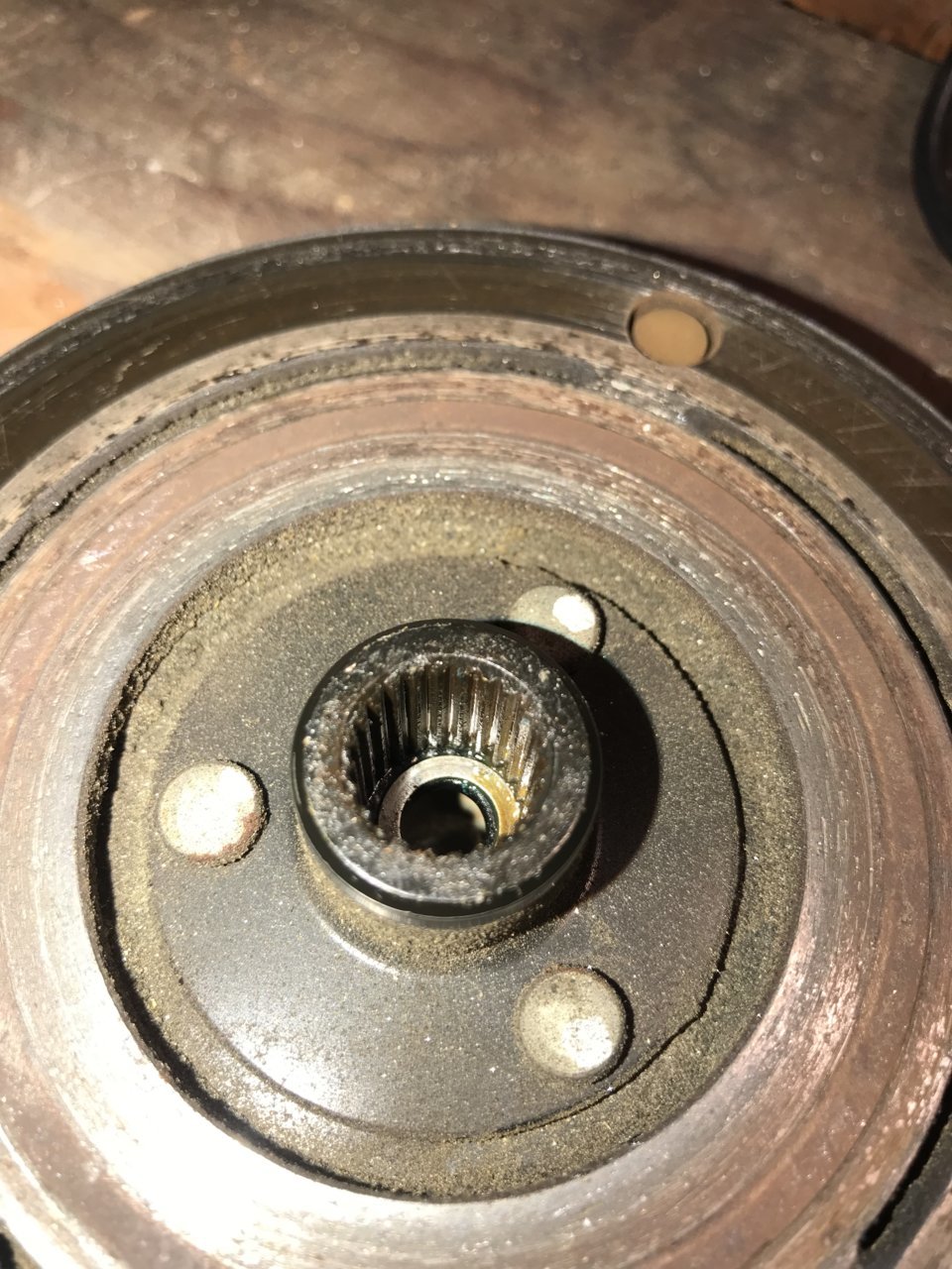

    I had a noise only when the AC clutch was engaged so I replaced it with a UAC compressor. The noise ended up being the tensioner assembly. The clutch wiring failed and the compressor was knocking just few months out of the 1 year warranty so they won’t help me out. I was going to replace the clutch on my old compressor and install that since the compressor worked fine.
    73FB9AA5-996C-4132-8910-E9E1C97AA447.jpg 1E63FE45-9D11-4290-9AD0-3ED2027DE227.jpg A8EAEEBD-FA52-466E-A13F-B870312EBDAC.jpg

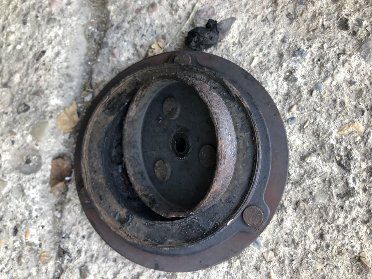

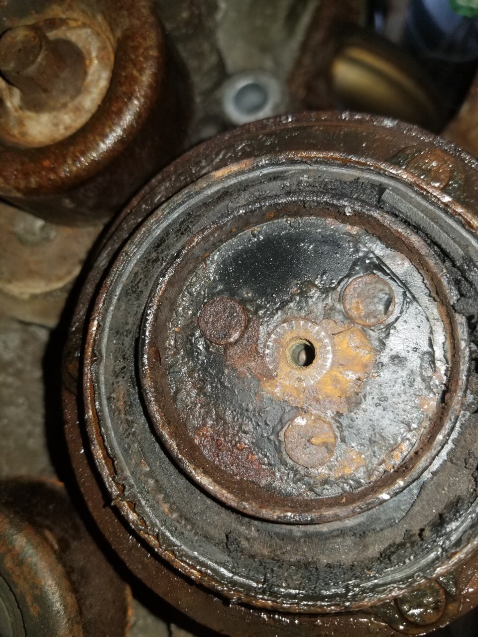

    20190716_155122.jpg 20190716_154529.jpg 20190716_154529.jpg 20190716_154524.jpg 20190716_155122.jpg 20190716_154529.jpg 20190716_154524.jpg 20190716_152501.jpg 20190716_152446.jpg 20190716_152445.jpg 20190716_152439.jpg 20190716_152432.jpg 20190716_152429.jpg 20190716_152312.jpg 20190716_152307.jpg
    Pics from my adventure in AC clutch repair. Easy fix and AC is ice cold again!

    Sorry, the pictures are a bit out of order. But if you are tall enough and have long arms (like me) you can do it all from the top.

    I hope you can see how I used the clutch tool. It doesn't work on our clutches quite how the instructions explain it, but it does work. And it was worth the whopping nine dollars I paid for it!

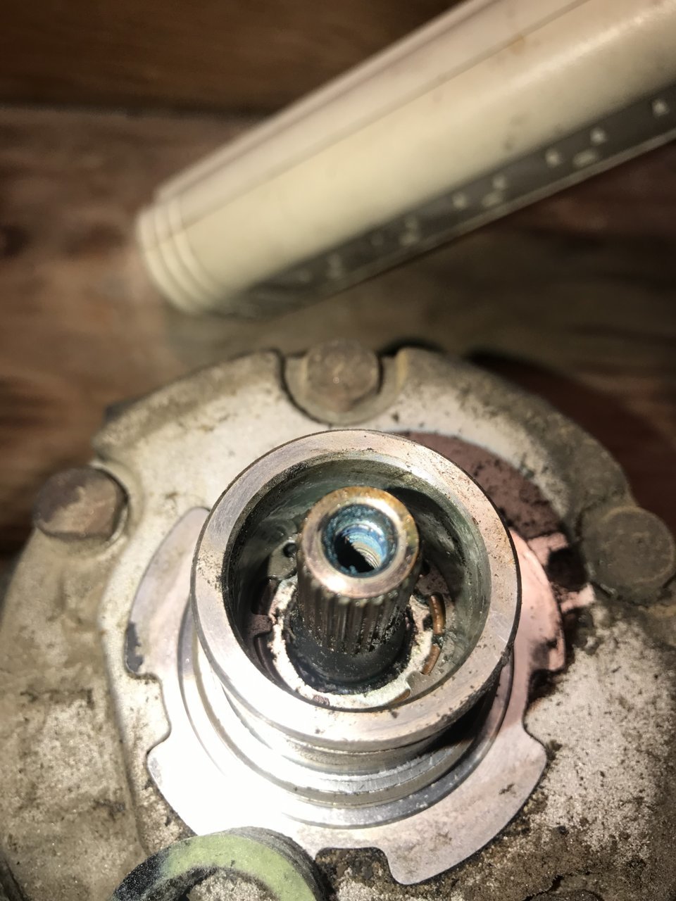

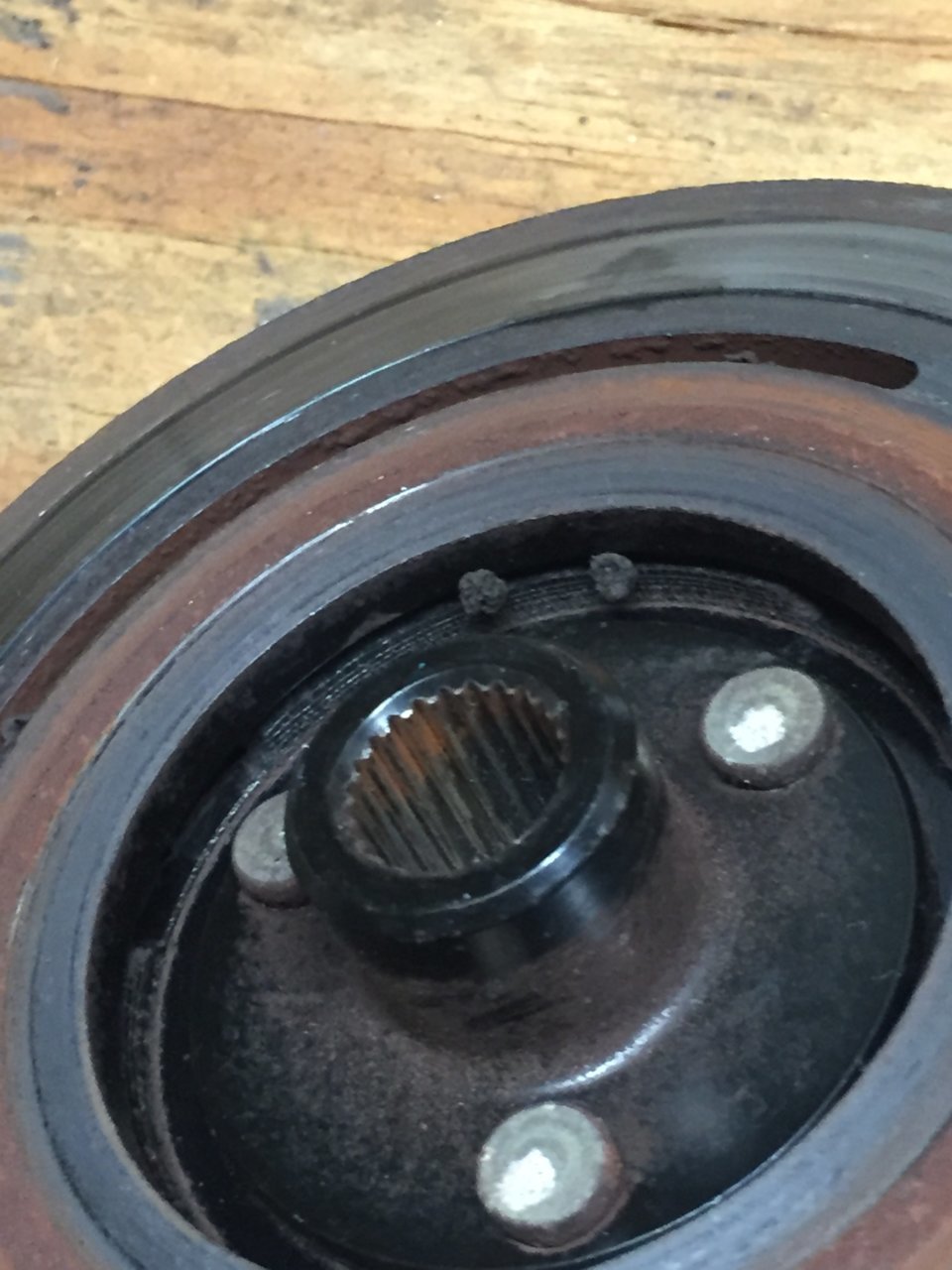

    I can't figure out how to get just that part off. I took the bolt out but it's just stuck on there. I don't see a c-clip on it either. What did you use?

    No clip on that part. Mine slid right off. Yours might have some rust in the way. Pry it off, watch for the shims.

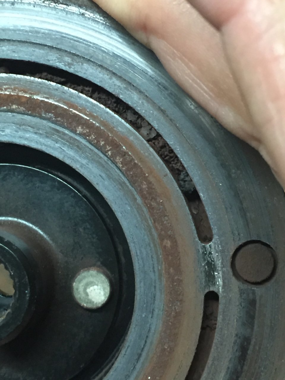

    Had the squeal, then blinking ac light. Ordered my hub with spacers from Amazon ($40) So glad I found this post and it fixed my issue with a huge $$$ savings!! Thank you for posting this when you figured it out!!!6C360619-FB11-4D25-9EC1-5B04E9E080EF.jpg
