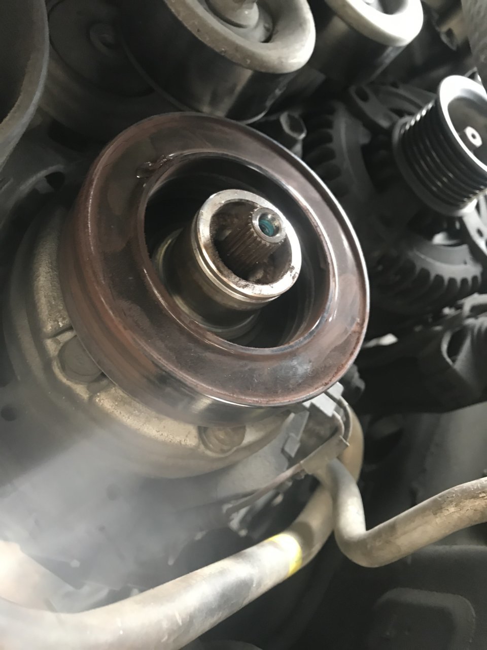

    So my truck is making a noise that seems to be coming from the ac compressor. The noise occurs when turning on the ac or putting it on Drive/Reverse. It did notice a burn plastic smell coming from around the driver side a couple of weeks back. Are these still symptoms of a bad ac clutch? TIA

    Can be a bad clutch yes, check the pulley (WHEN THE TRUCK IS OFF) and feel if there's any loose rubber coming off of it.

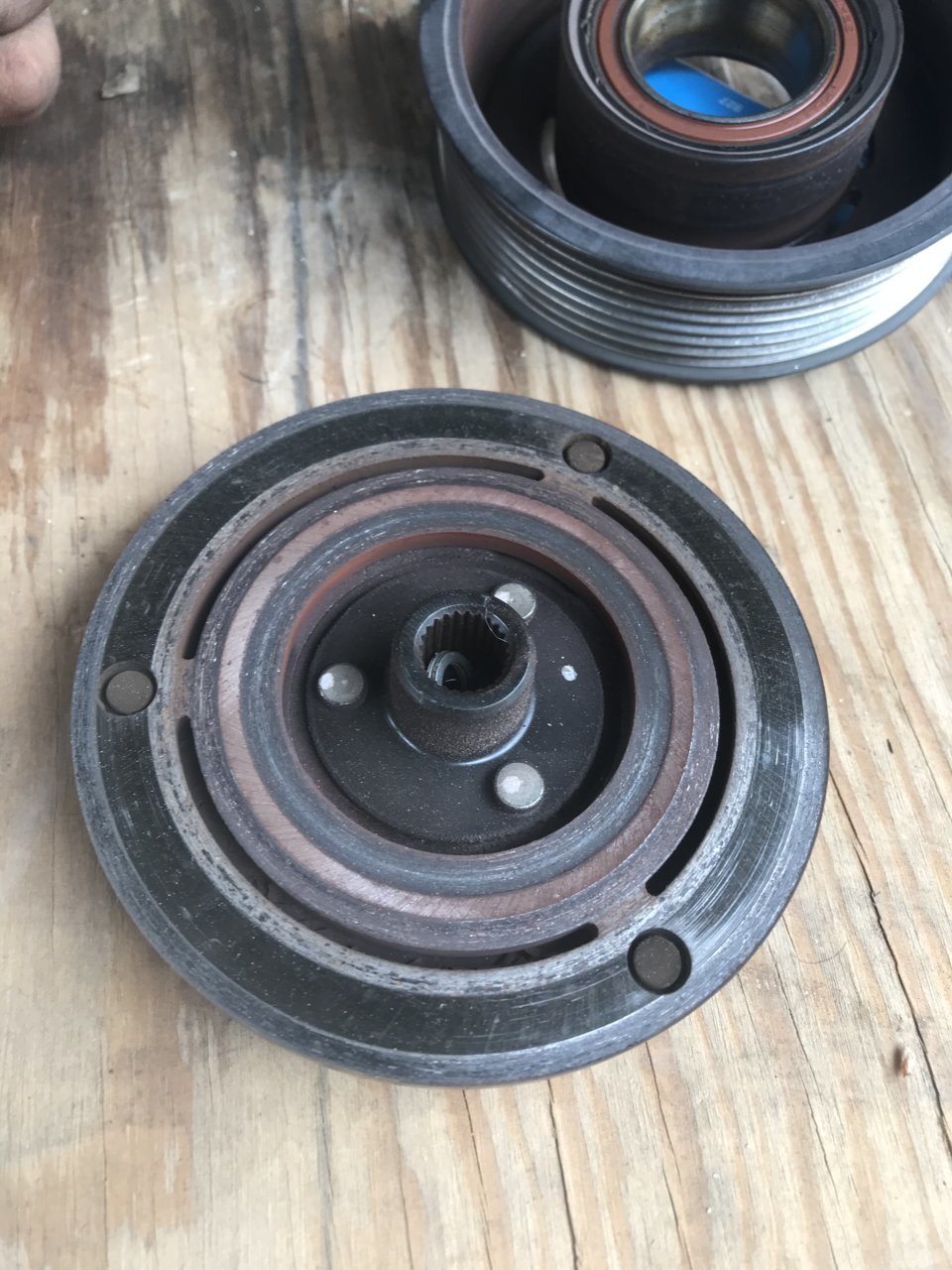

    So I actually got some time to take it off and found lots of red dust but doesn’t seem to bad to be making all that noise.here is what it looks like please can someone let me know if it looks bad before I got any furthers. The first part that comes off does fell a bit roughDF666CB6-57FA-4FA9-9339-7817F53D5928.jpgDCB56598-4A7A-4D91-8A34-1D8C703461B3.jpg

    the front part is the clutch, bottom piece in the top picture. If it’s bad it will either split into two pieces or be able to spin within itself, which means the rubber bushing failed, which is where the noise came from for my case.

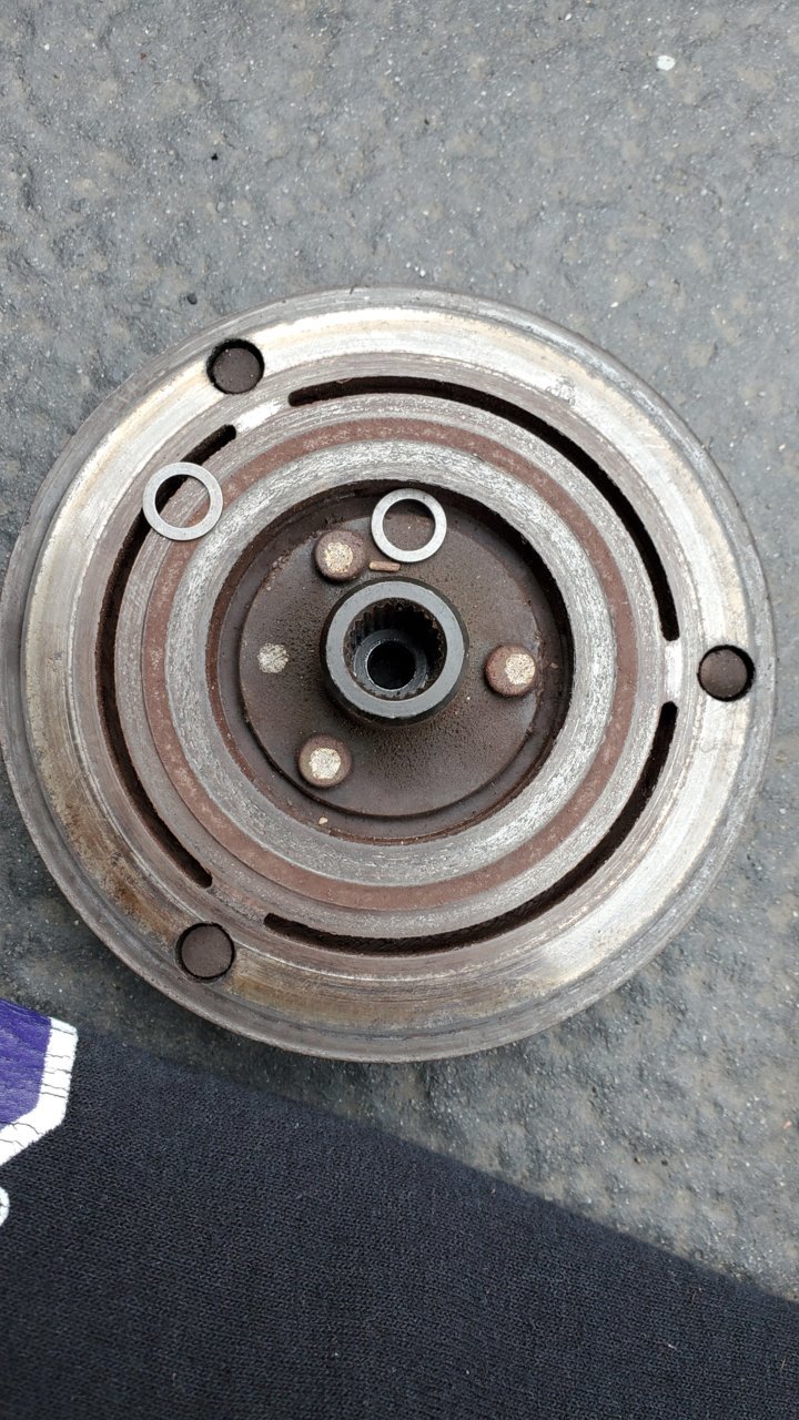

    I had the tell-tale characteristics and ordered a replacement AC clutch via ebay. The one I received only had one washer for the clutch air gap and initial measurements had me thinking that the gap was too large with the one washer and that I'd need to use one of the thin washers from the remains of the old assembly. When measuring the gap I had to measure further down towards the center to get an accurate measurement. For some reason with just measuring the outside perimeter I'd get a looser gap measurement than if I measured down towards the center. Seemed the mating surfaces of the magnet had a slight ridge and tighter fit after the outer 1/3" of the perimeter. I did try a thin washer initially with a gap that was correct on the outer perimeter but the clutch assembly, once activated would not release from the magnet. Switching back to the thicker washer that came with the clutch resolved the problem and provided an accurate gap further towards the center of the clutch.
