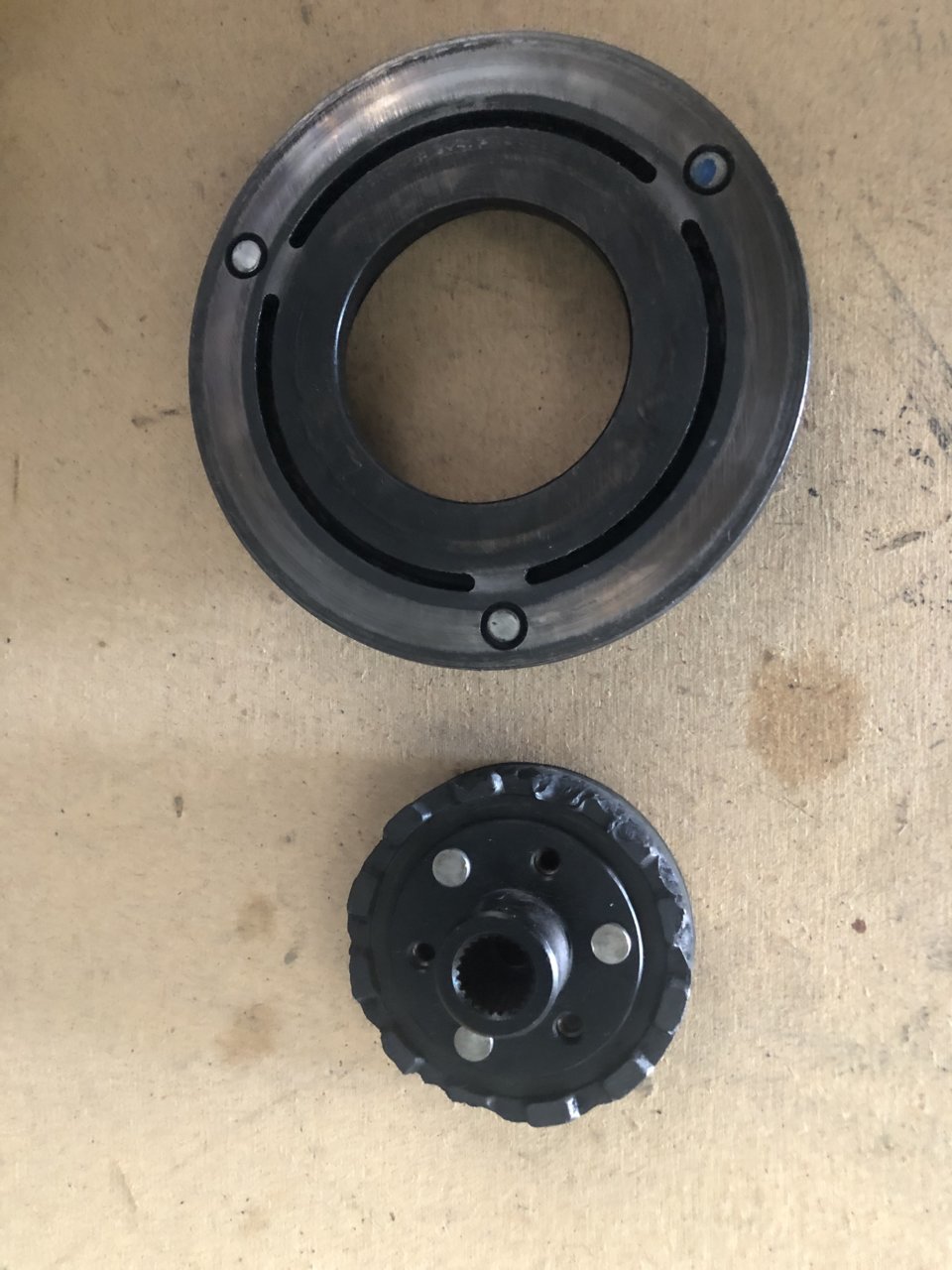

    06 Blue Tacoma TRD-OR 6-Spd STD
    Glad to see this thread is still running, not glad I have to reference it though lol. I have the loud squealing noise then light blinking when I hit the AC button. I am hoping just the clutch. I will try to identify that as the issue after work today. All of the links to parts in this thread are expired, does anyone have a beat on source/link for a replacement clutch?
    And just to make sure I understand correctly - If I see bits of melted rubber, most likely clutch. And if I can wiggle/spin the inner ring then the parts are separated and so clutch again? If the clutch appears to be in one piece is there a way to diagnose the compressor or other component being the issue?

    So I pulled the front half (can’t see to find my snap ring pliers) of the clutch off and found the two pieces separated and bits of rolled up rubber as previously described by others in this thread. Compressor shaft spins smoothly. So seems like clutch replacement is well worth a shot. Anyone have a line on a good source for a replacement?
    Also I saw 3 shims fall when I “carefully” removed it but only found 2. Does anyone know the correct gapping? Since I not longer can pull a measurement from mine. Thanks!

    Well that seemed to be the fix. Thanks to those who contributed good info in this thread! Can't beat a $60 repair for something at a shop that would turn into a new AC compressor assembly.
