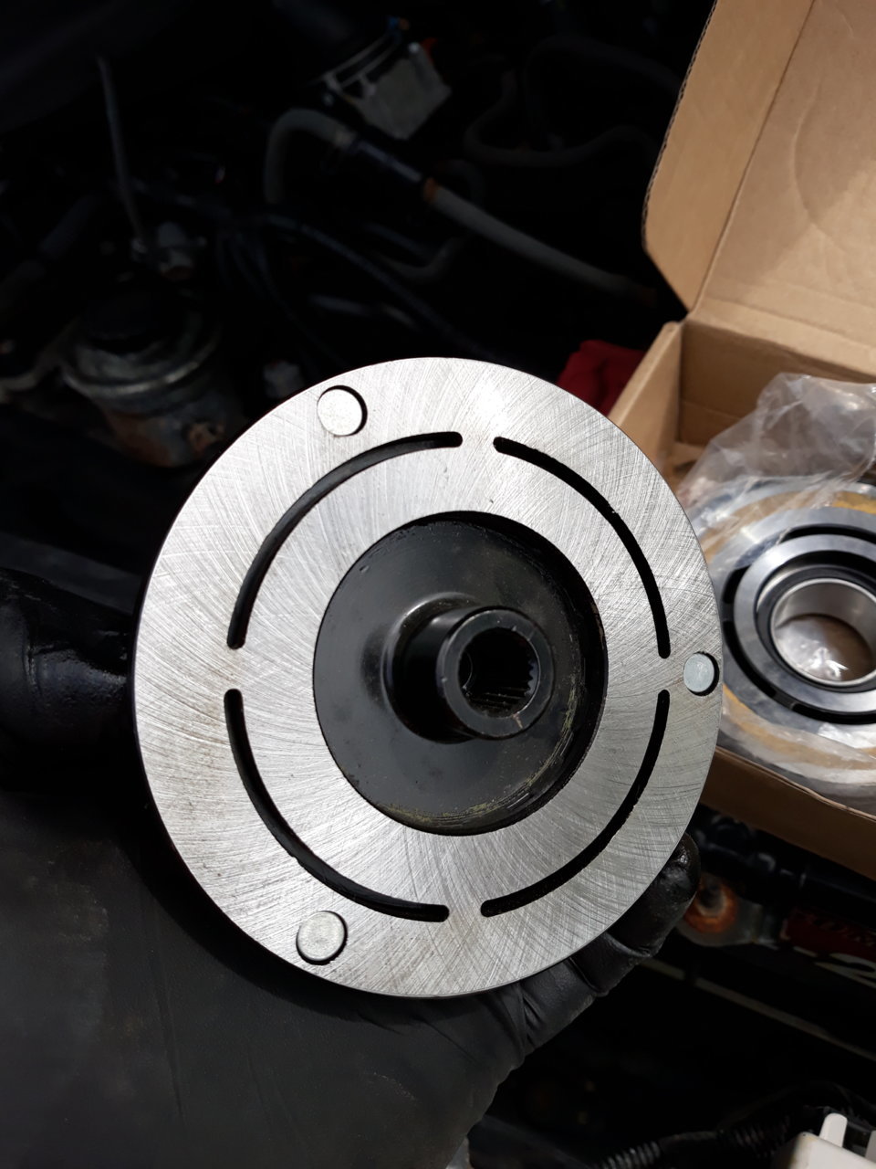

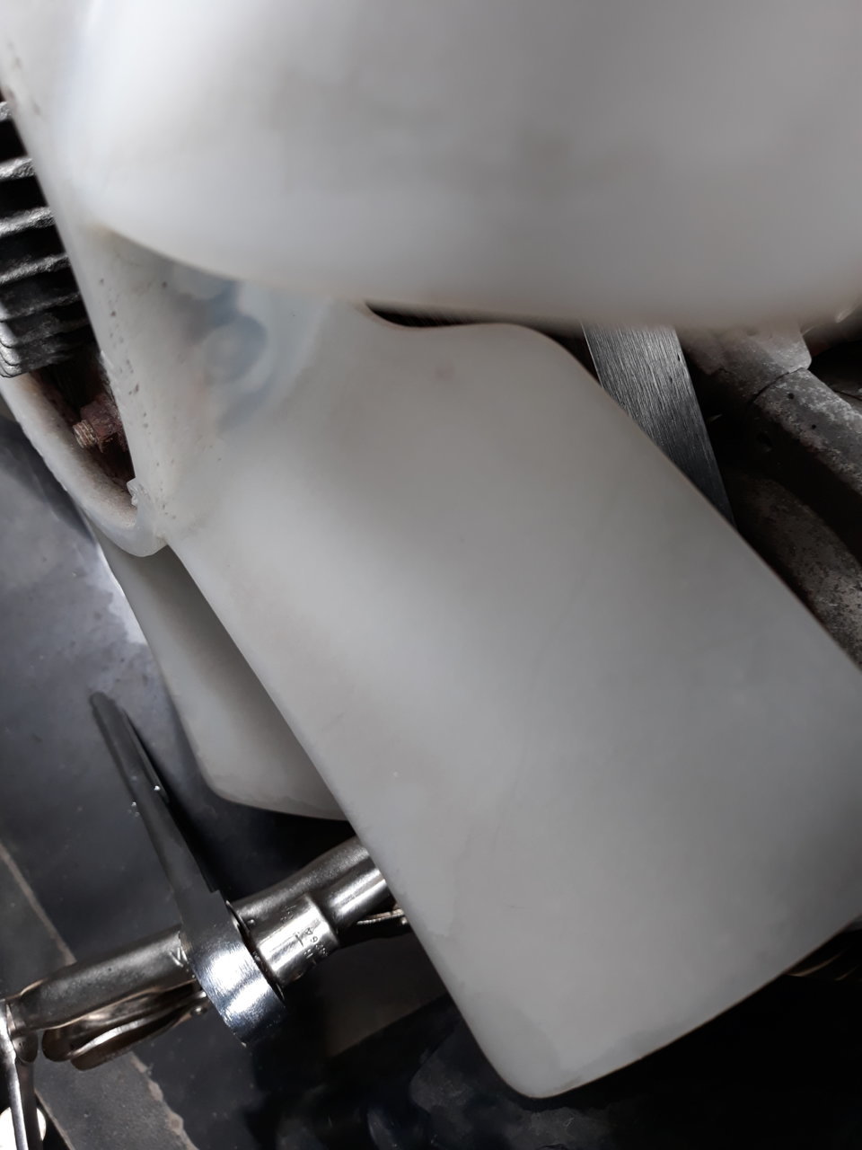

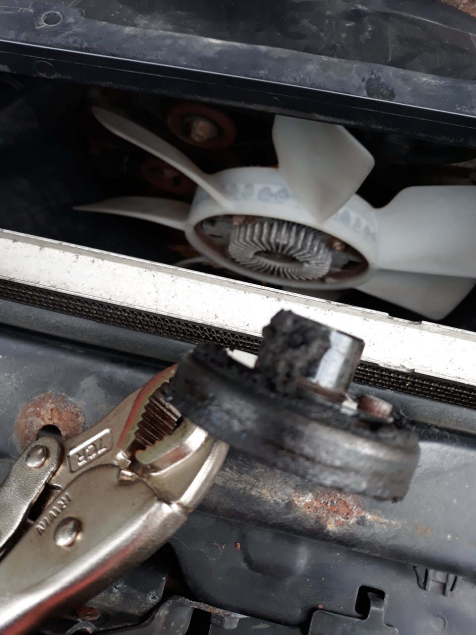

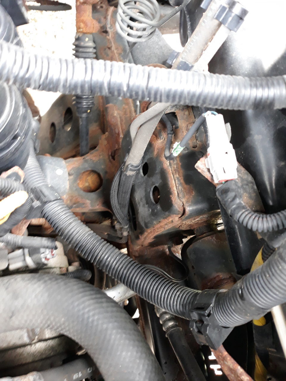

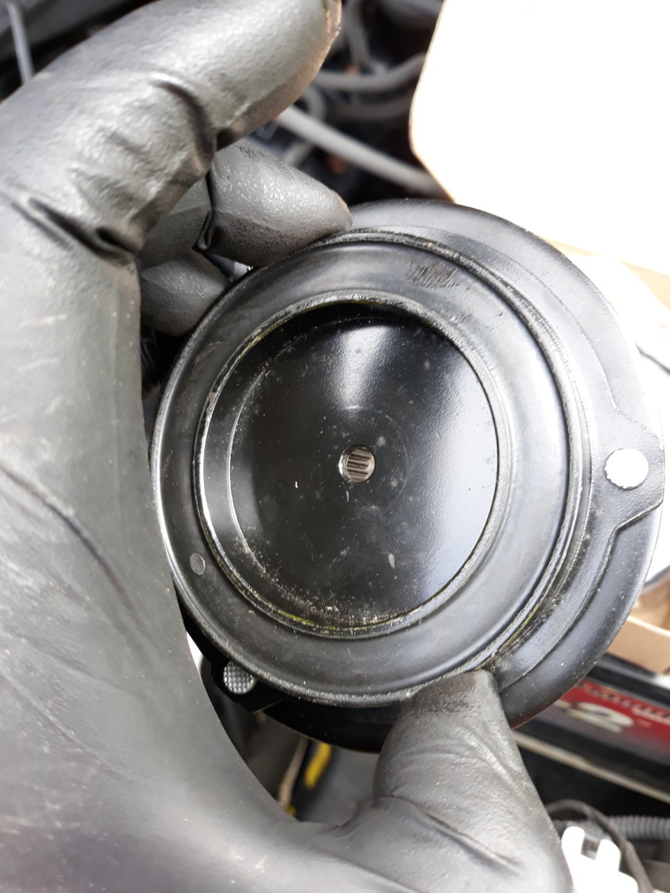

    I just did this repair on my 2010. On one of the hottest days of the year in the Northwest, I got the blinking ac light and then a squeal of death. Found this thread and ordered some snap ring pliers and the clutch off ebay. (I don't normally buy off ebay.) Drove around with no AC and could not roll down the winders because of the smoke in the air. Got the parts and replaced the parts.
    The hardest part for me was the electrical connector screw. It was seized and I had to use small vice grips to get that out.
    I also had a hell of a time getting the pully off. Snap ring came out easy, but I could not get the pully to come off. I tried prying it off and tapping with a hammer. It ended up that I was not pulling the pully straight out off the compressor. After a break and a night's sleep, I got my gloves on and got a good even hand-hold on the pully. I then pulled straight out and it moved. I was able to jiggle it back and forth until it came out. The rest was easy.
    Thanks for this post! Saved me a lot of money, but now it is raining for the first time in weeks and the smoke and heat are gone. But I got AC again, when I do end up needing it. :thumbsup:

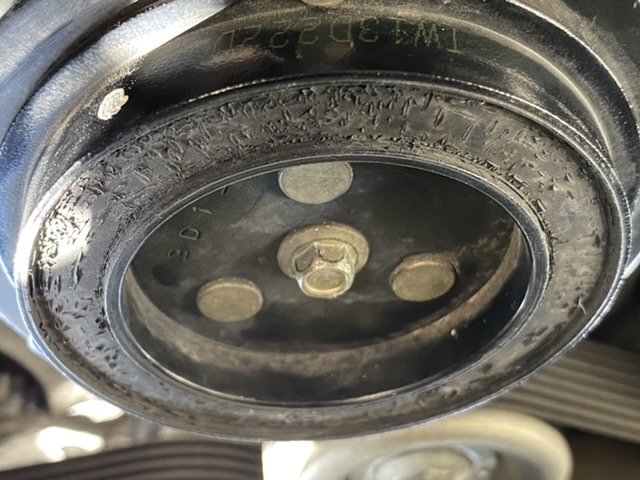

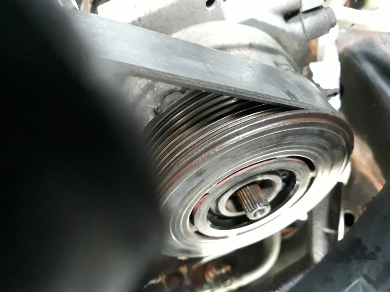

    not sure if people are using this thread in 2021 but i’ve noticed a clunk noise when i start my AC and after a couple seconds the clunk goes away. i’ve noticed it mostly after the AC hasn’t been used for a few days. once the AC has been turned on the AC can be turned off and back on and the clunk doesn’t occur. but if you turn the AC off for a couple days and then on i hear the clunk for a couple seconds then it goes away.
    i’ve been researching this issue and first thought it was the AC compressor either having too much pag oil and slugging OR too little pag oil and running dry.
    the AC system is factory and the refrigerant was evacuated last summer and the correct refrigerant was charged at 22oz for 2nd gen tacomas. no pag oil was recovered during evac in the bottle and no pag oil was added back. i asked how much refrigerant and pag oil was going back in and AC tech stated 22oz is what tacomas call for and the AC tech said ‘sometimes we don’t get pag oil when we evacuate because the pag oil stays in the compressor and condenser and evaporator mostly’ but i’m not a AC expert so i don’t know this is is true or not for AC evac.
    so i presume the AC tech was correct and the correct pag oil type and volume is in my AC system, but then my theory on too much or too little pag oil would not be accurate.
    which leads me to this post talking mostly about AC clutch assembly (clutch hub, clutch face and bearing, clutch magnet) and also in this post about compressor failures, both causing different lists of symptoms.
    clutch assembly failure symptoms seem to be mostly AC light blinking and burned rubber smell. which i did have burned rubber smell one time when starting AC on.
    compressor failure seems to be little more vague. my AC pressures on high and low side are LOW at 40psi and HIGH at 200psi so that looks like the compressor is operating correctly.
    i did an inspection on the AC clutch and observed it’s condition from the outside NOT taking the 8mm bolt out, just looking at the rubber. this rubber degrading state inside the clutch hub appears to be the main problem which AC clutch failure. although i do not see anything in this post saying owners observed clunk on AC start up and hearing a clunk for a couple seconds then it goes away.
    no i am unsure if this clunk when turning on the AC is due to the AC clutch.

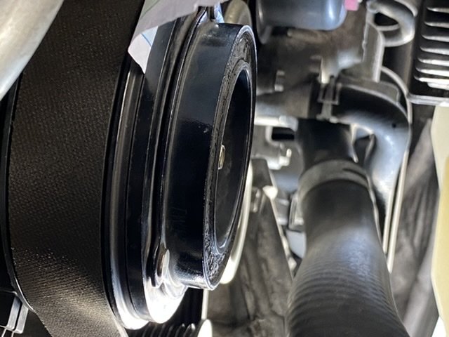

    i’ll try to attach a pic of the AC clutch hub and rubber from the outside, still mounted to rhe AC compressor. the clutch and clutch hub rubber appear to be in good condition.
    i did take a picture of the AC clutch air gap, the distance between the AC clutch hun and the AC pulley as this air gap is important for proper AC clutch engagement and disengagement.
    i’ll see if i can attach that air gap picture as the air gap is about the size of a piece of paper which could be too small, maybe due to worn AC clutch surfaces.
    i am looking into a replacement AC clutch assembly and a AC compressor although i’m not sure yet which may be causing the clunk on AC startup yet. it appears the clutch and compressor commonly come together on new AC compressors also which may just replace both parts at the same time but i would rather not just start replacing parts unless i’m able to determine which part has actually failed. replacing parts to see if that fixes a problem without confirming the failed part is not a wise troubleshooting method.
    not being a AC expert though my troubleshooting hasn’t uncovered much evidence to determine what parts are failing or in a degraded state.
    advice or suggestions from owners having similar situation would be helpful.

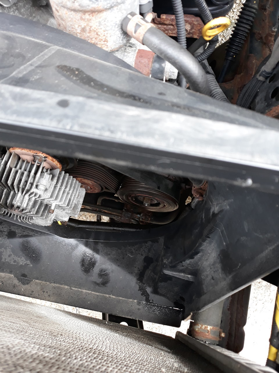

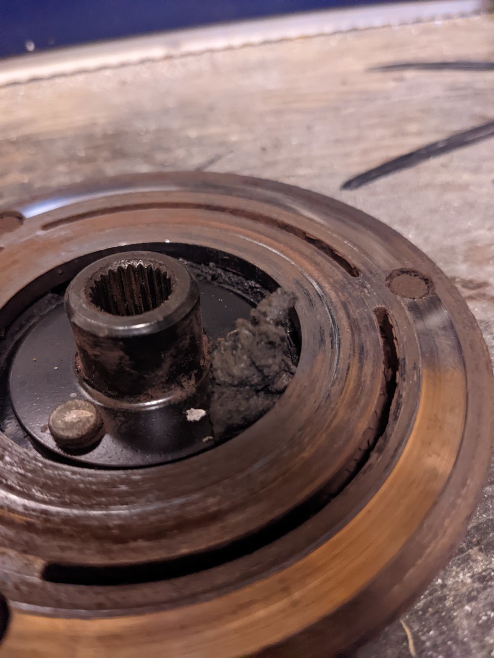

    Had the squeal, then AC light flash. Found this thread and ordered the replacement clutch hub for the front. I did not have an easy time getting the 8mm bolt out despite using vice grips to try and hold the center from spinning then I finally remembered I Owned a pneumatic ratchet. Lol That got the bolt out with the help of a buddy holding onto the hub with an oil wrench from the top down. New bolt going back in has a 10mm head but threads were the same. Used the same spacers and all is good.
    No wonder it failed. Big chunky bit of rubber. Thanks OP and everyone else. AC is working again.
