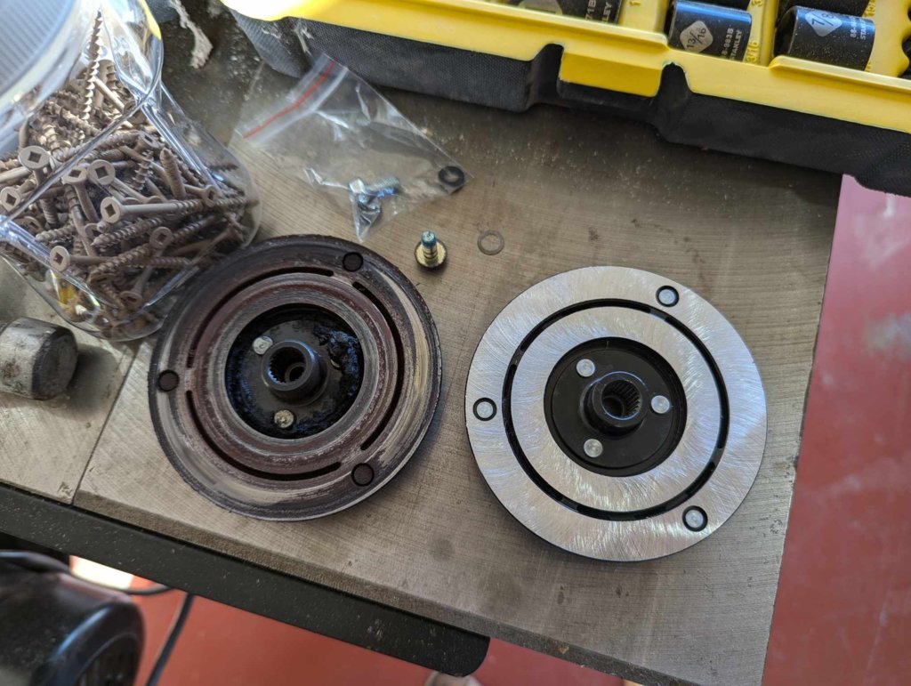

    IMG_2256.jpg Thank you to the OP and poster who put up Amazon link, I got my part from them. I had the blinking AC light since end of last summer, and had a big screeching sound that eventually went away mostly but no AC. Thought for sure it would be compressor. I did this job on my 2011 2.7 and it fixed the problem. I ended up removing the fan blade, and plastic cover.

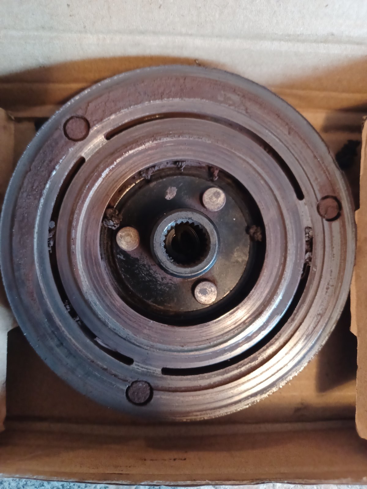

    Hi, update, I pulled the AC clutch off and it came apart in two pieces. I can turn the compressor shaft splines with my fingers and it feels smooth. With the clutch off, can I test the magnet with jumpers? Should I hear a click sound ? I’m trying to decide whether to just order the clutch or This the whole clutch/magnet/ pulley assembly. thanks. JJ
    Update …….Ok , I ran a jumper to magnet wires from battery and then put the old clutch against the pulley and energized the magnet and it sucked the 2 pieces together . So it sounds like all I need it the clutch . Thanks for all the earlier info .

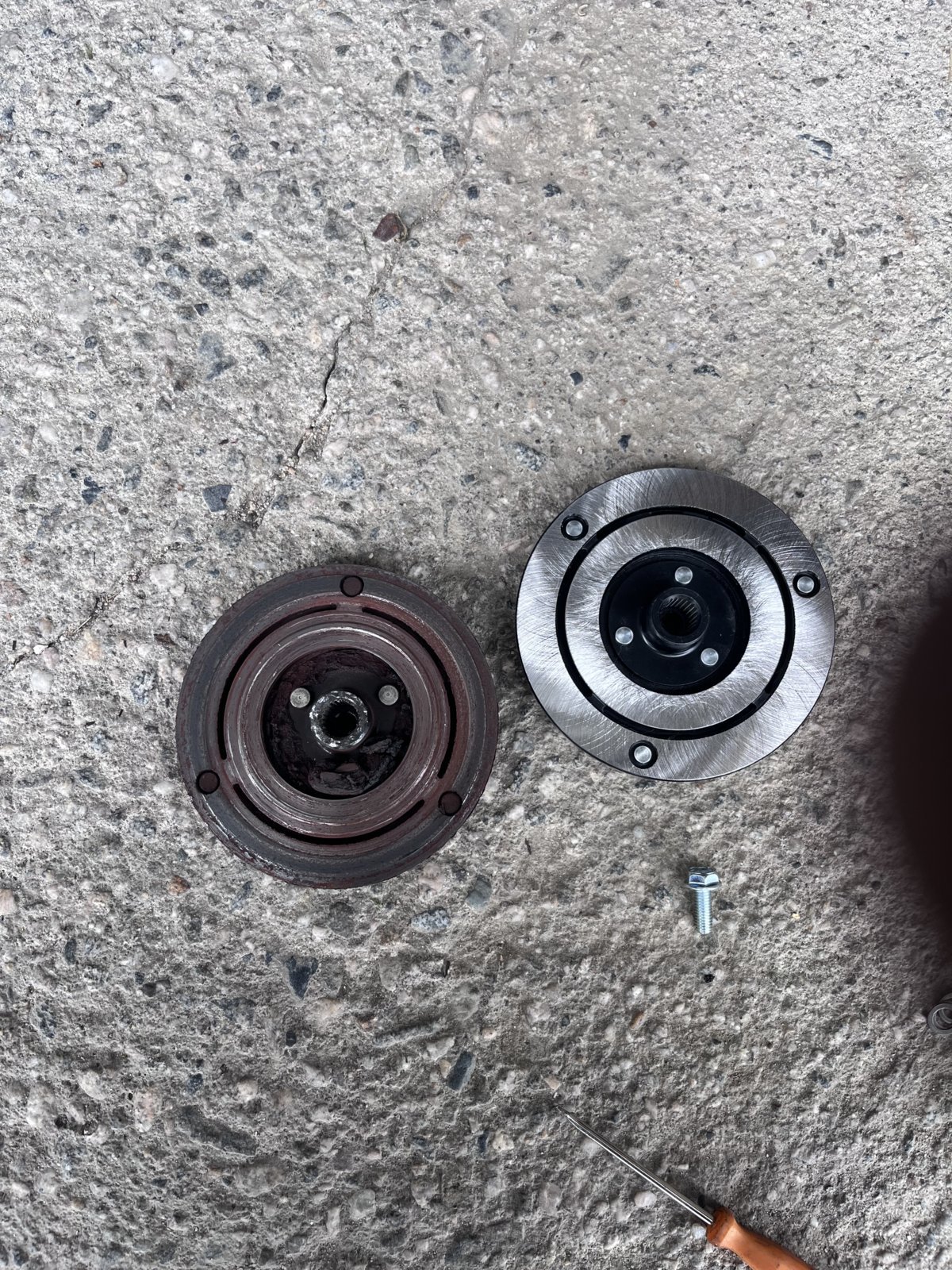

    Well finding this thread prevented my mechanic from getting his next boat payment to replace and purge the whole AC system, I hope you all feel terrible about yourselves.
    $35, 1 bolt and 10min later I took care of it myself. Same as everyone else, death ball of rubber inside the clutch.
