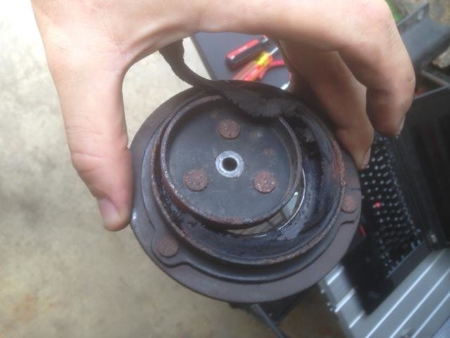

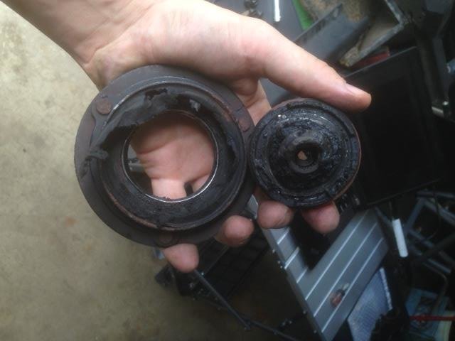

    Here's what mine looked like when I got it out...

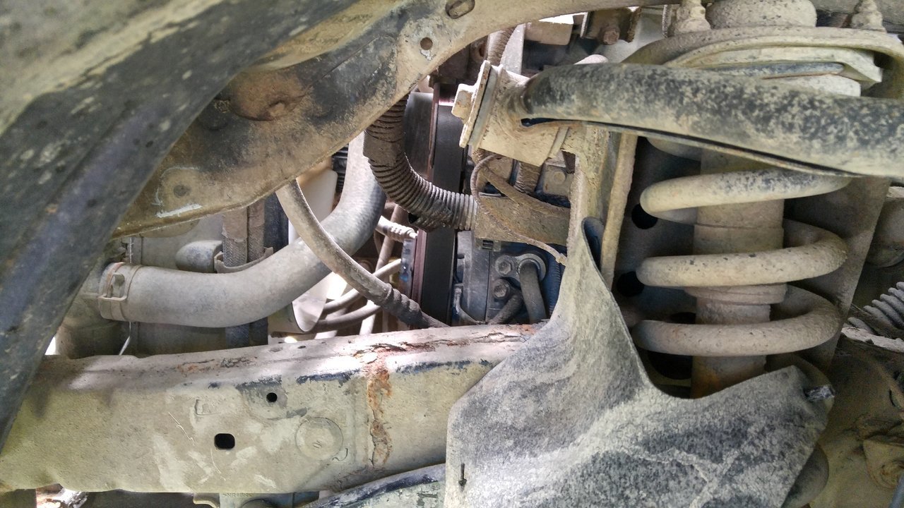

    thirdly, there were a couple things lacking explanation so i thought i would help fill the gaps for anyone ready to pull their hair out. Took me about 45 min -1hr because i tried going first through the fan /radiator way. Then gave up and went through the top of the hood/ underneath the drivers side tire (pics to follow)

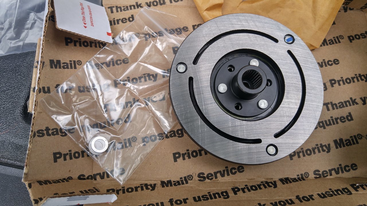

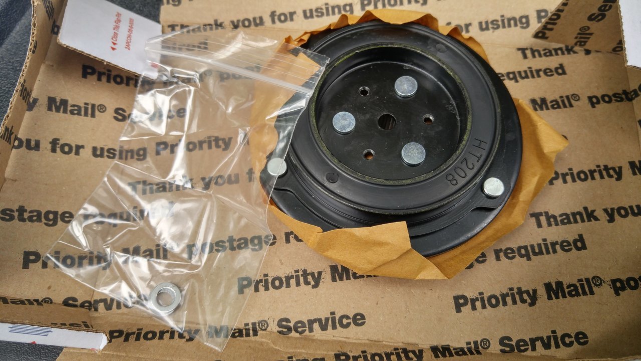

    I ordered the replacement hub about a week ago and it shipped really quickly. This is how it came packed
    the packing contents. Came with 4 spacers. Use them all.
    Location of compressor from the side: i folded back the covering to have access. I found it easier to operate from this angle, as well as the top. For me i could not remove the fan simply because my forearms kept getting in the way, and the there wasnt enough space for me to get the fan out after i had it removed. i did not have to remove a tire, just turn it to the left (i attempted removing the fan shroud and found this to be easier) I went through the top of the engine in between the battery and the oil filter. Just remember to leave the vehicle cool or the oil filter may burn your arms

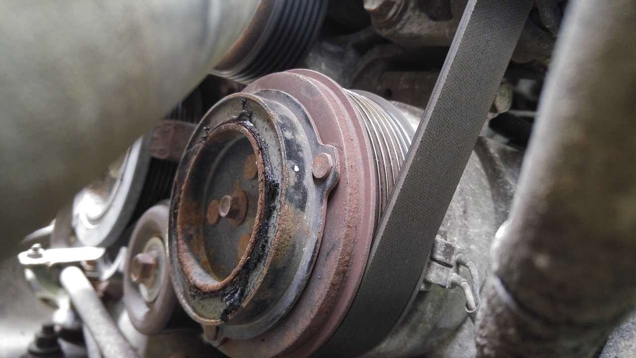

    front shot of the compressor, notice the melted rubber pouring out the side? hub is Kaput, compressor is fine ($500 saved)

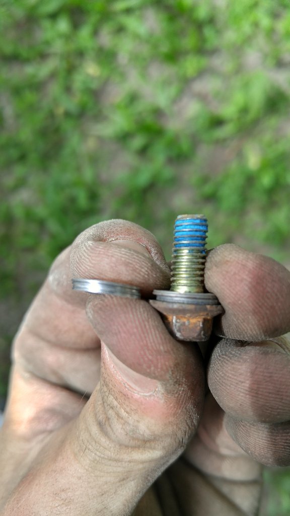

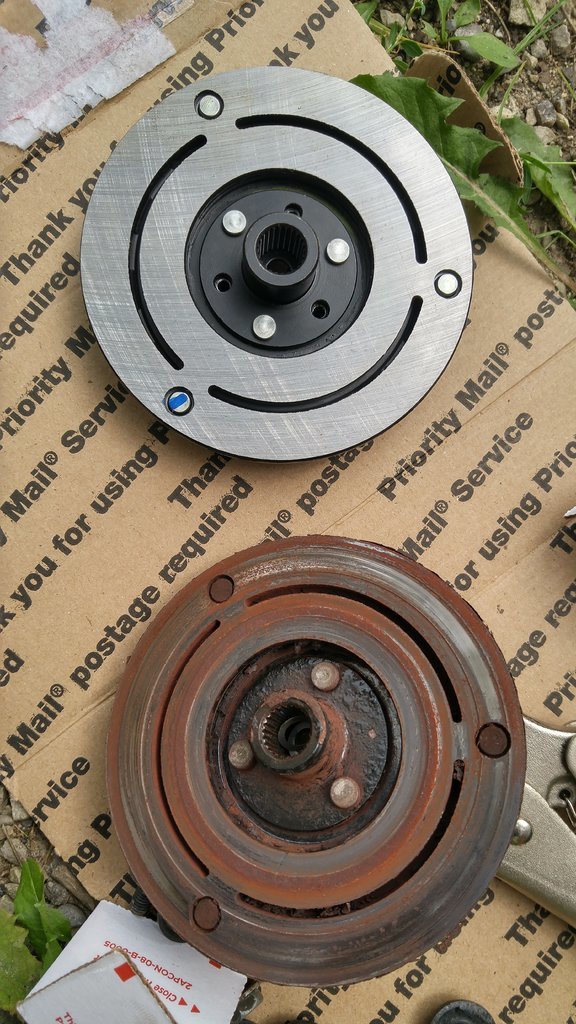

    the front of the hub after removal just as OP said, use a pair of adjustable pliers and an 8mm socket

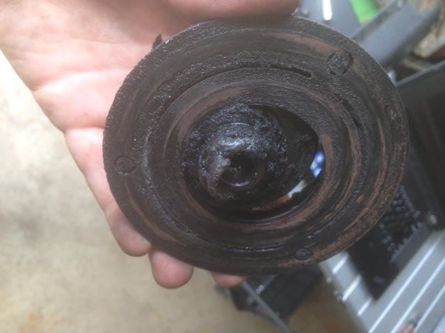

    backside of the hub. If you look closely you can see the spacers when i removed the old unit there were only 3
    New spacers 4 of them on the left......old spacers 3 of them on the right, side by side comparison
    new hub with the 8mm bolt, i used all four spacers and placed it on the same way i took it off.
    after you tighten it, torque the centre bolt to 10 ft*lbs/13.5 N*m /138 kgf*cm
