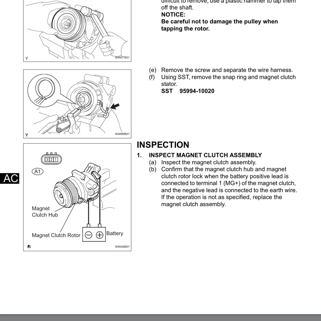

    Had the same blinking light issue, but my problem wasn't the hub. It was the magnetic coil. It would not snap shut when power was applied to it. It was easy to take off the hub, pulley and coil with snap ring pliers and that clutch tool. But it was a pain in the ass to get the snap ring back on to hold the magnetic coil onto the compressor. I basically had to make a tool using a piece of pipe and a C clamp to push it back into place. But it works perfectly. Bought that kit on eBay, but didn't replace the bearing on the pulley, just the hub (even though it was fine) and coil. For $80 fixed my AC. I never even went

    How did you know the magnetic coil wasn't working?

    Shop manual has the testing procedure. See attachment. Also when you push the AC button you should hear the clutch hub snap closed onto the pulley and engage. When I pushed the button, nothing. But I would hear the rpms change like you mentioned. Whether it's the clutch hub or the magnetic coil, you won't know if the compressor is seized, because it doesn't run when one or both of those other two parts are at fault. The belt is just spinning the pulley but nothing is engaging.
    You can also test the coil with an ohm meter. If I remember it should be 3-5 ohms.
    But if you are seeing the black oozing, it's probably just the hub. I tried that first since it's pretty easy, from underneath. But it didn't fix it, so I tested the magnetic coil. It looked fine but didn't pass either test. So I replaced it a few weeks ago. My trucks a 2012, bought it used earlier this year at a lower price since it had no ac. AC now works, it was 93 degrees here in ATL last weekend. Glad I fixed it before then. Compressor was fine.
