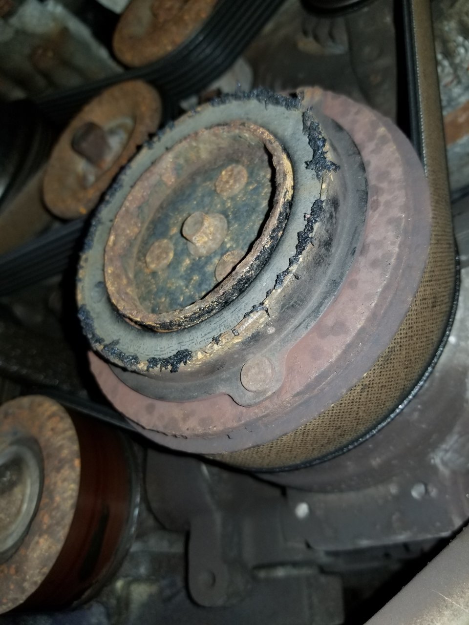

    When
    When the AC button is pushed, the outer clutch hub part spins fast and the middle part spins slower and stops once the ac light starts blinking. Hub must be in 2 pieces. I am guessing the clutch is indeed engaging, hence the huh spinning. Pulley never stops or slows. I guess either the hub wore out, bearing went bad in the clutch assembly, or compressor is fubar which made the hub pull apart.. in a few mins im going to then a wrench on the bolt to see what happens. I am guessing it should spin with some resistance? Like not freewheeling but not seized?

    that certainly sounds like the clutch, if your lucky just replacing the clutch might be the ticket,if not and u need to get a new pulley and magnet too u know what your dealing with and can maybe DIY it, onceu get the clutch off u can see how the other parts look while in there.

    20180517_161607.jpg Ok, just put a wrench to that 8mm bolt and it turned normally. No freewheeling and not seized. Only front of clutch hub spun, not the pulley. Surprisingly easy go access, wont have to jack the truck up. Pic of it

    Yep, new clutch should be the ticket!!!
