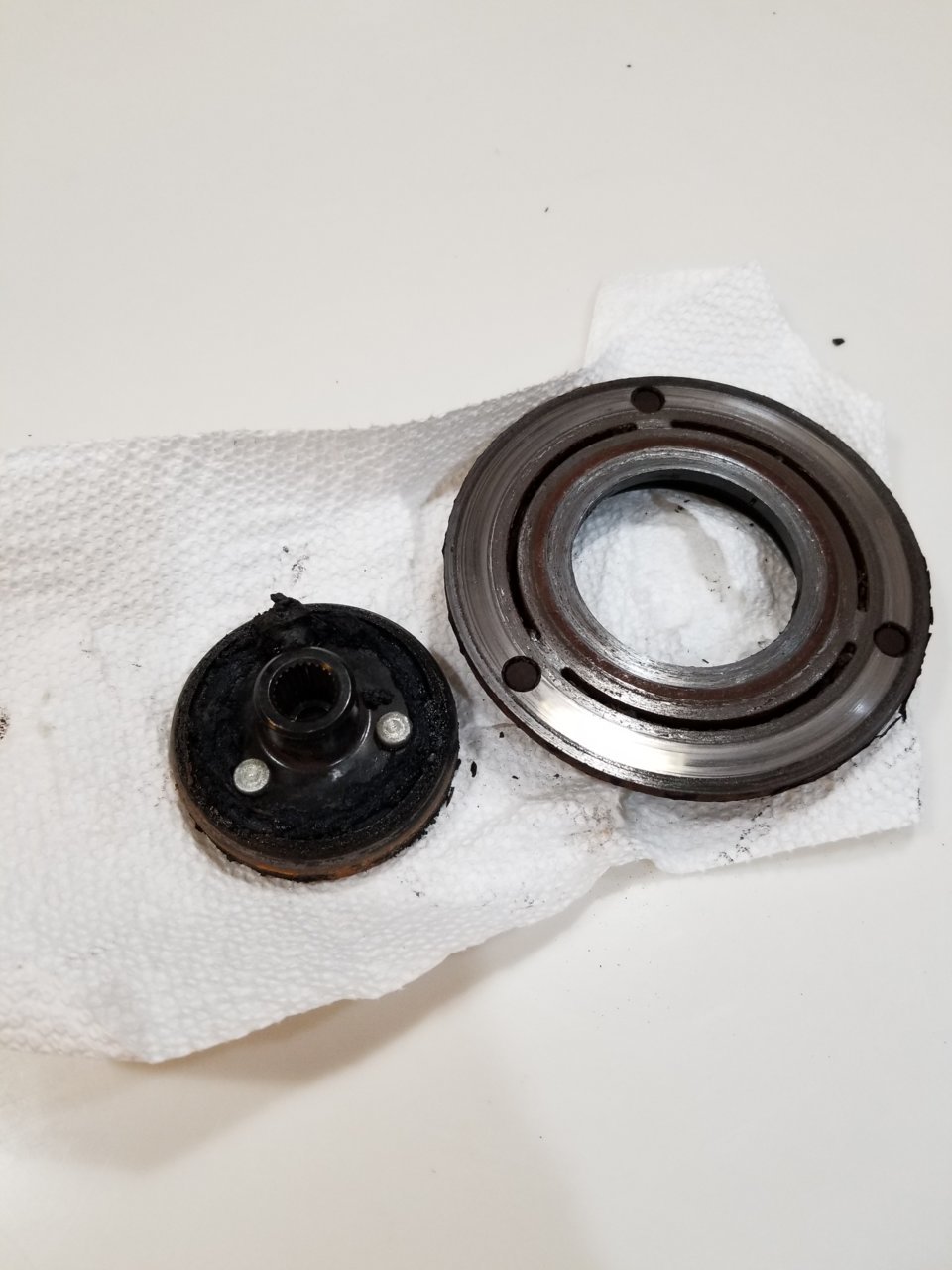

    Happy to report the hub did the trick! Thank you guys for the support and great information. Old hub was in 2 pieces. Borrowed the clutch tool from autozone to help hold the new hub. Those clutch tools are adjustable so the job was easy but involved some contortions. I didnt even bother jacking the truck up. Turned AC on and off as well as defrosters multiple times with 0 problems! Thank you again and if your pully isnt seized and the magnetic clutch engages, try the hub first!!20180519_202754.jpg

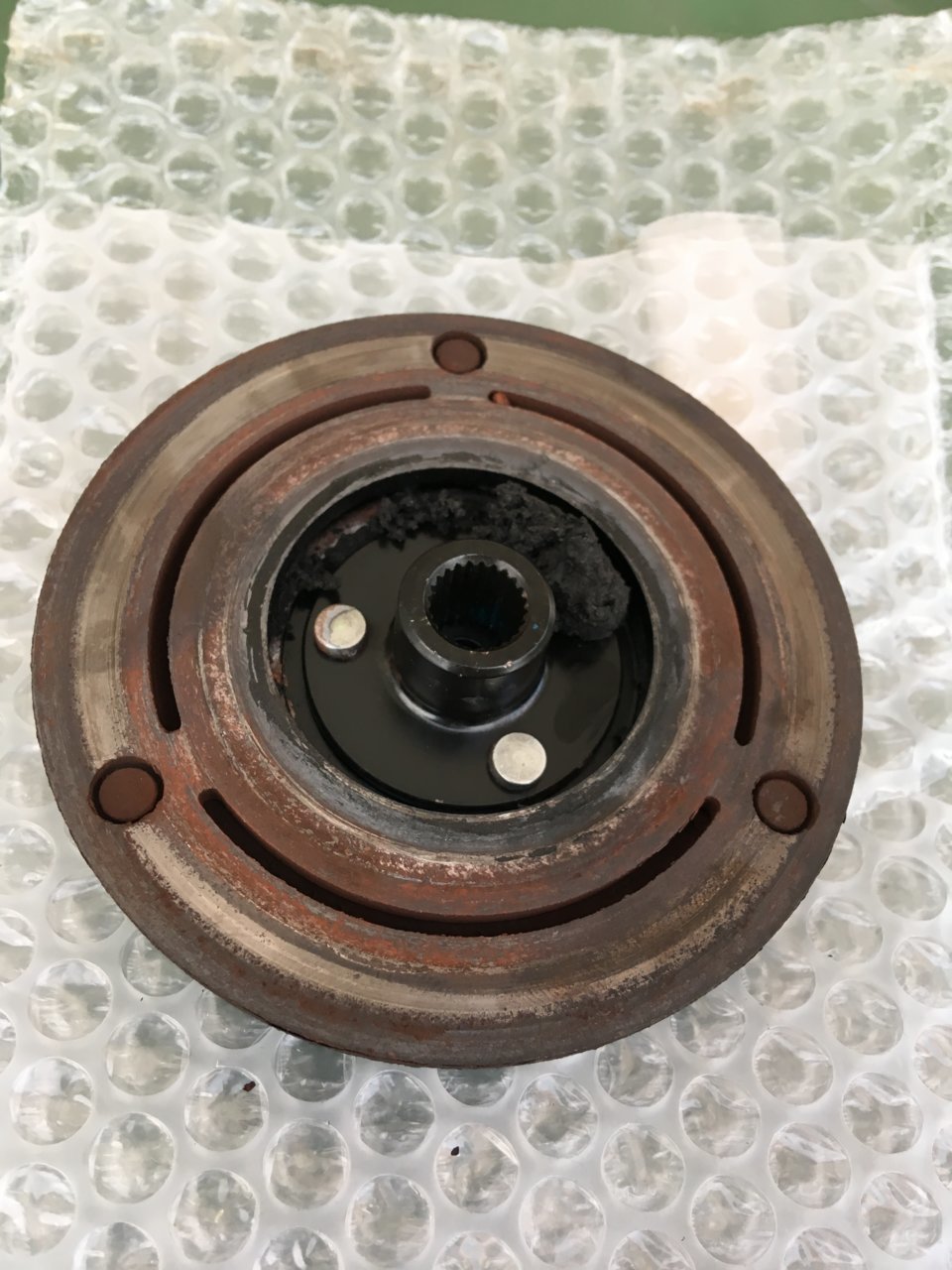

    19920B84-4857-4867-8E35-44444321859E.jpg B15F26B8-C2DD-40CD-80B7-757974A3AC10.jpg Big Thanks for your post !
    I had exactly the same problem and I followed your instructions!
    The problem took me an hour to fix and 95$ Canadian $$$!
    The dealer would not even try to tell me how much they would charge me to diagnose and fix the problem but it did not look good
    Thanks again for this great forum !
    Pierre
