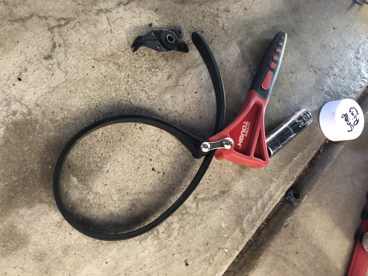

    First step was to take the pulley off, was going to go easy but I rounded the head of the nut off pretty good. Welded a 9/16 nut on the head and along with the heat it came off easy. I recommend using this rubber adjustable oil filter wrench from Walmart to hold the clutch, $6 from Walmart. 53428311-5C55-46C5-A977-C3512E6C304D.jpg

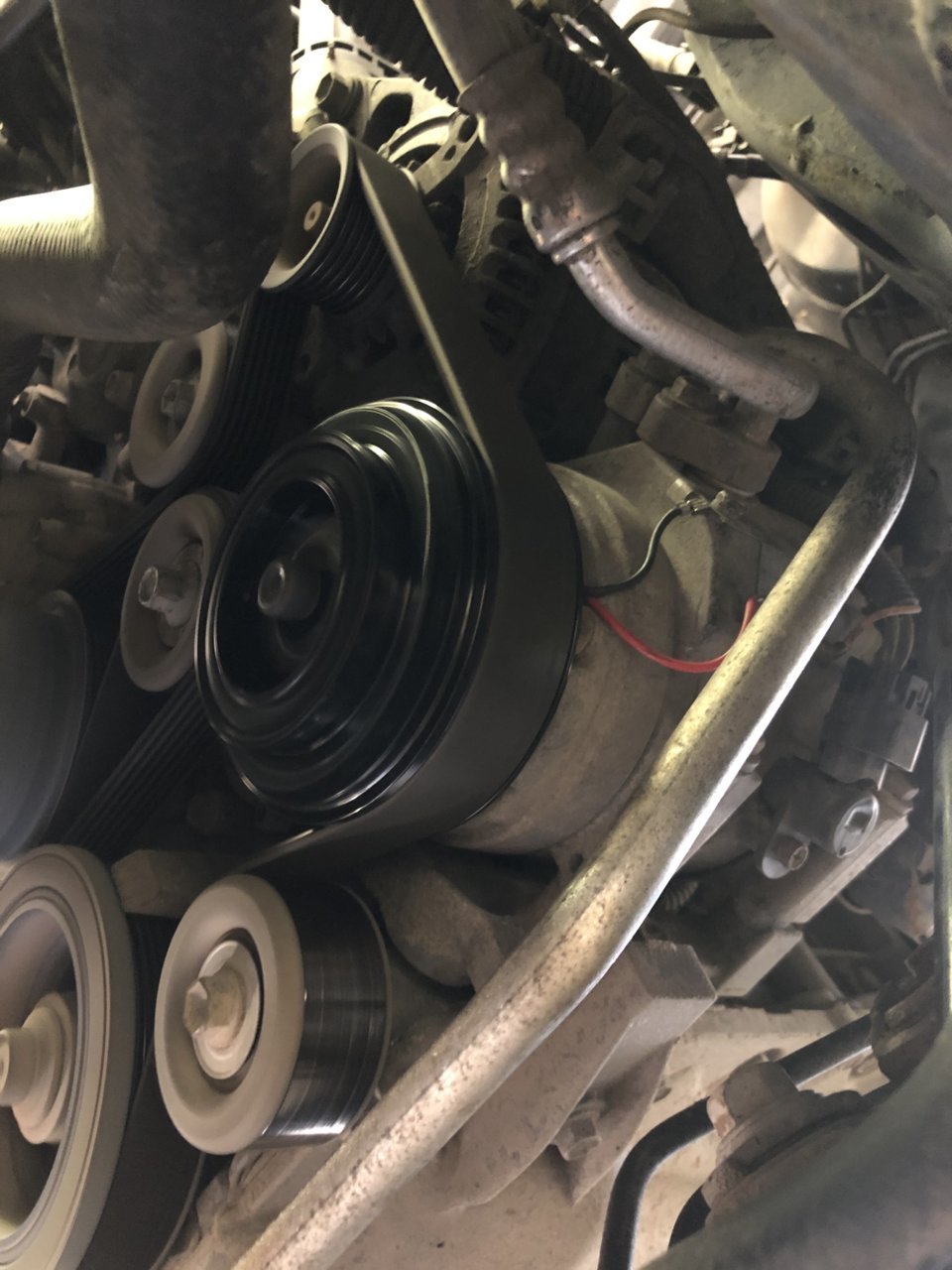

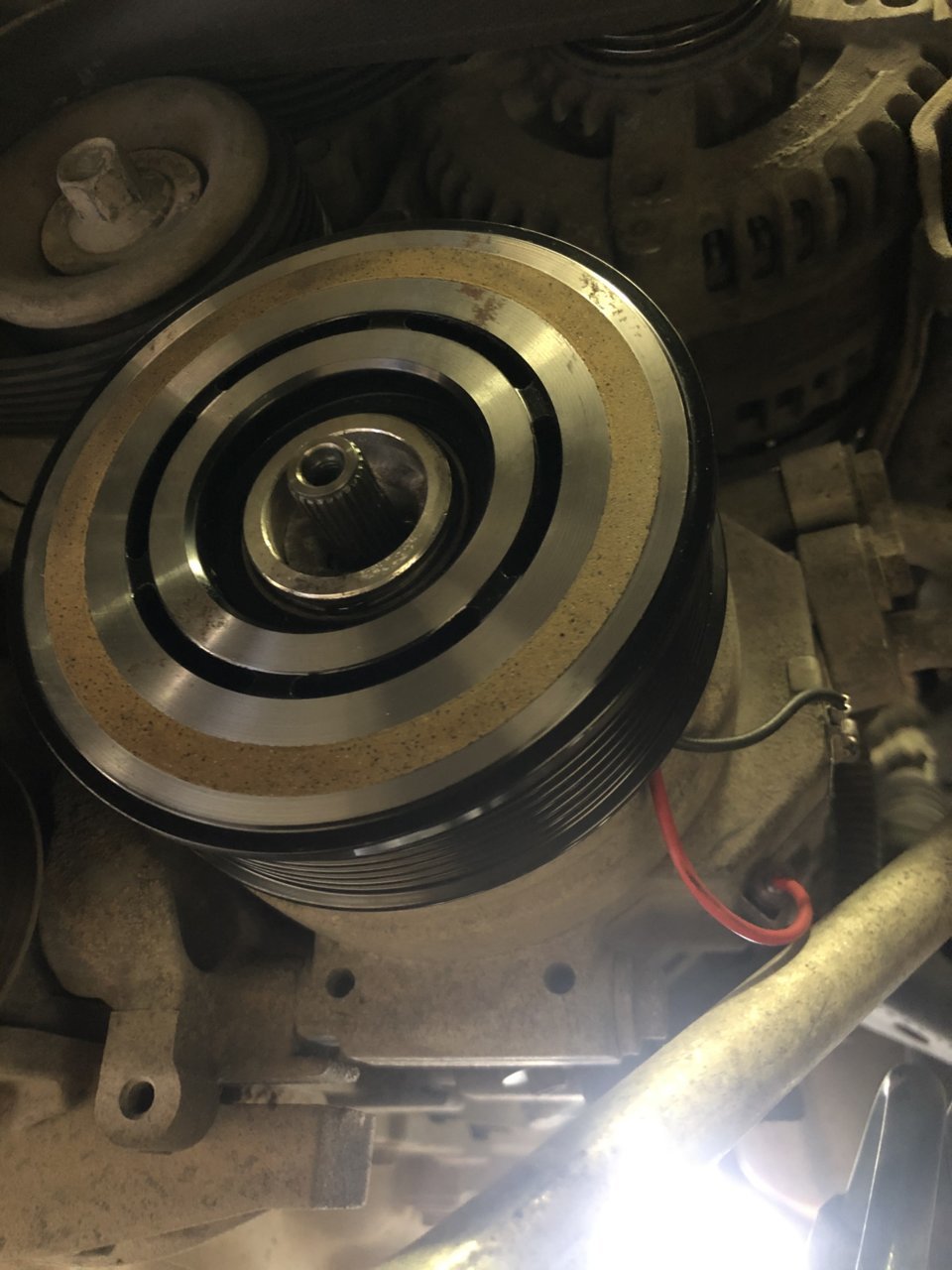

    Pretty straight forward after that, use retaining clip pliers and remove the first clip after the outer clutch part is removed, then there’s another after you take the pulley off holding the magnet.

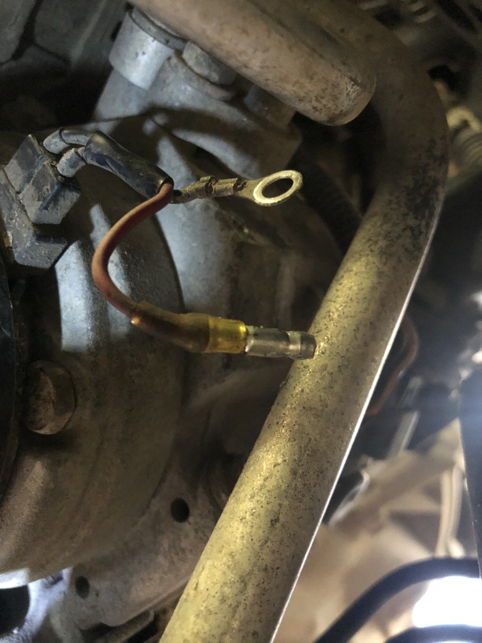

    Wiring is straight forward.

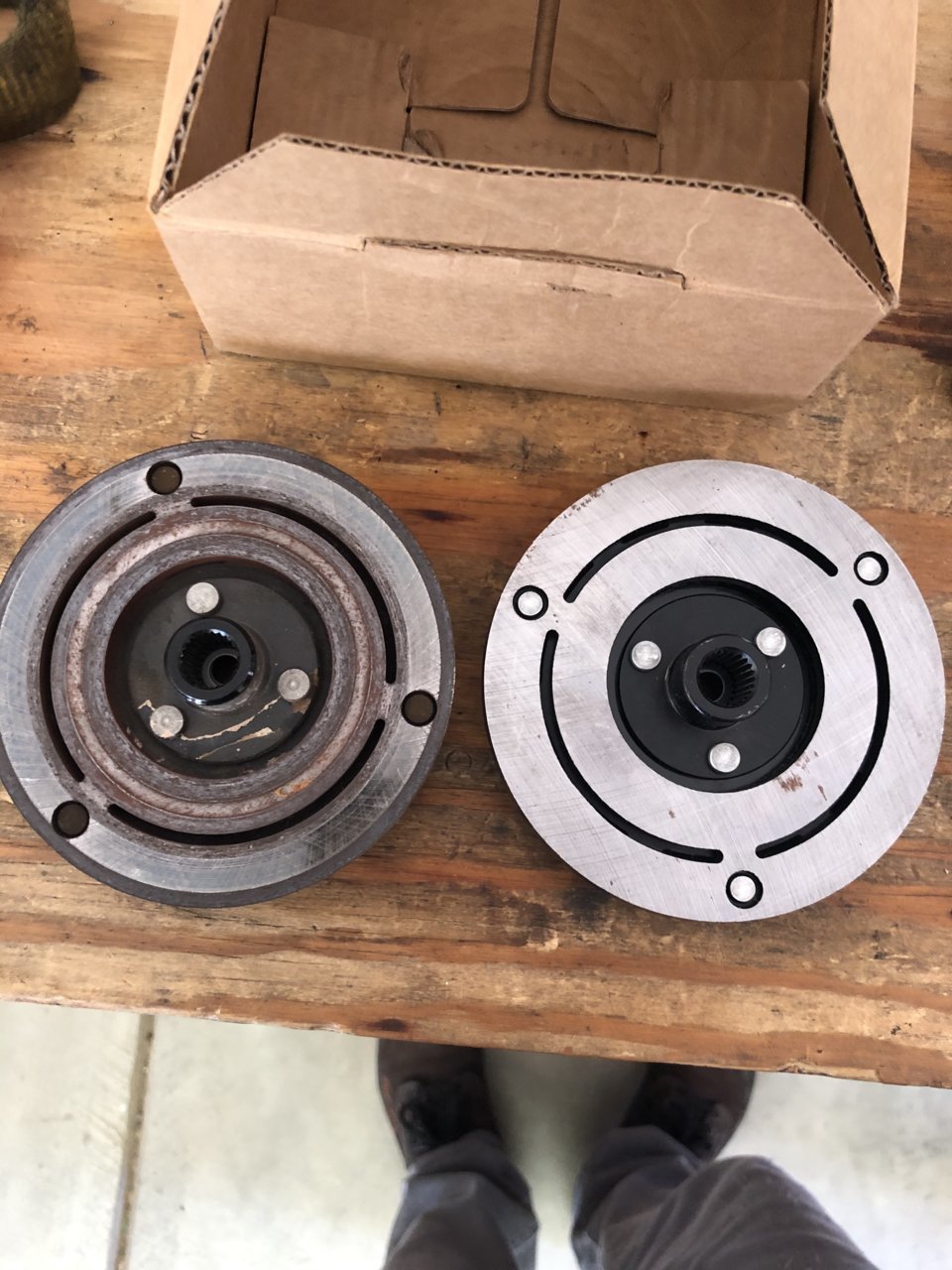

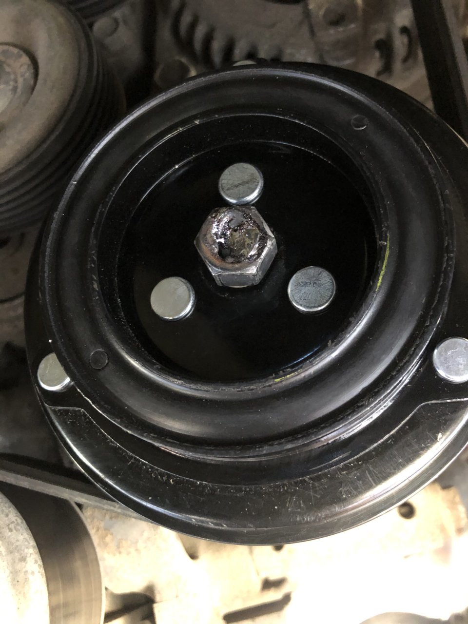

    B00BA260-716A-4731-810F-DB8955198BC3.jpg It is a breeze from there, work backwards. Magnet, retaining clip, wire up, pulley on, retaining clip, then outer piece. Remember to check tolerance of the gap after you have it on, it should be between .3mm and .6mm from everywhere I read. I ended up with .5mm. The part I got on Amazon had 3 spacing washers in which I used all three to get my tolerance. Ended up using my welded nut because I didn’t have another, it’ll do for now lol.
    Got everything put together and it rips now! No intermittent on/off and it get colder quite faster (probably from it not slipping?). Anyway I know there was a guy on here I think @cardinalfan is his name, thought I’d do a simple write up on how I got mine installed.

    the kit I got off Amazon listed above had 3 shim washers in the hardware bag, super small. Surprisingly I had to add all three since the oem one that was there didn’t get me the proper gap. Be sure you are within the tolerance. If yours doesn’t come with them, put it together and check your tolerance, but do not start your truck if it’s not within those parameters. I’m sure if you needed they probably sell at Napa. Hope this helps!
