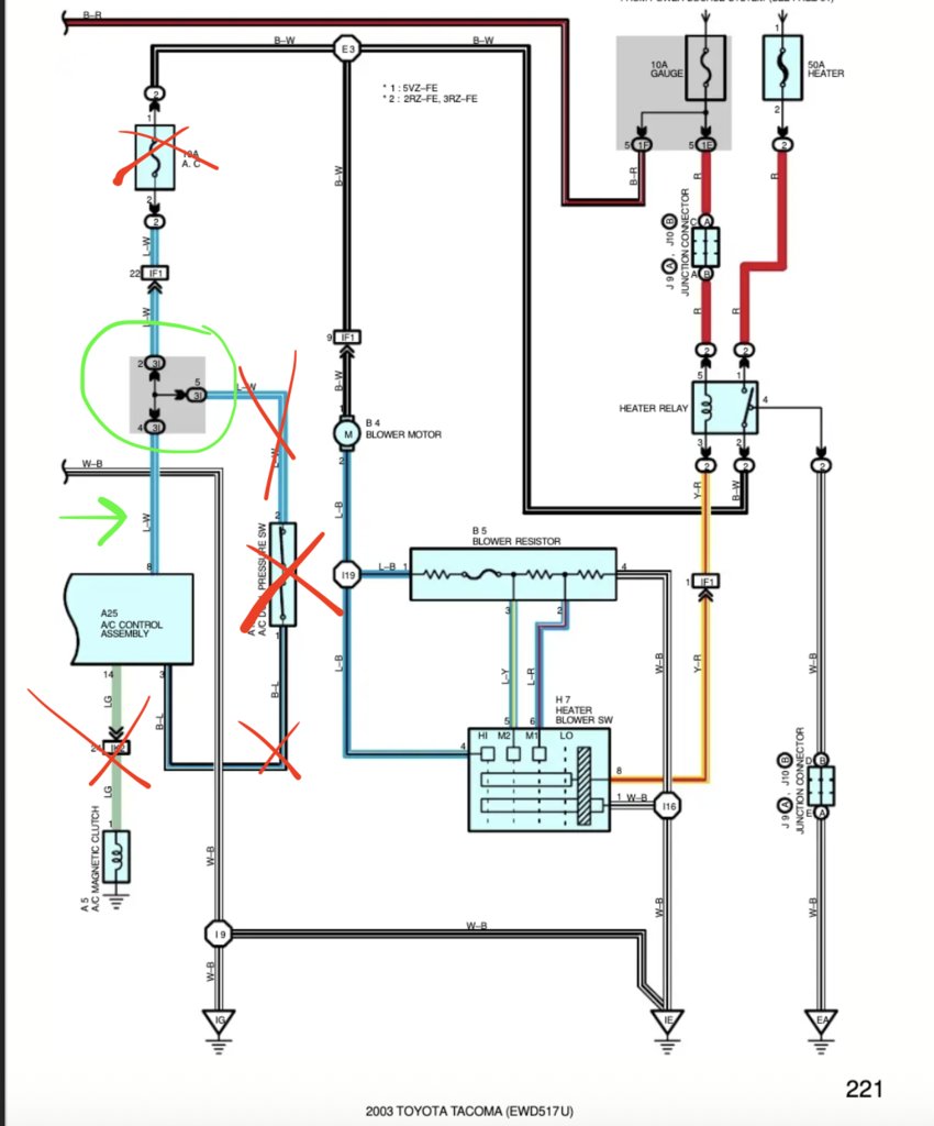

    Update have checked the following for electrical continuity:
    Input and output of dual pressure switch - All Good
    AC Control to Clutch/Compressor Switch (Light Green Wire) - All Good
    Output of Dual Pressure Switch to AC Control (Blue wire whitel line) - All Good
    AC Fuse - All good
    With AC fuse removed:
    AC Fuse to Dual pressure switch - All Good
    AC Fuse to AC Control - No Continuity
    In the wiring diagram below I have crossed out what I have tested so far. I'm not sure what the item I circled in green is or how to test it.

    Update 2:
    I noticed there was no power getting to the AC fuse. Replaced the heater relay still no power to the AC fuse. Checked that power is getting to the heater relay terminals when engine is running so heater fuse is good.
    Checked continuity between relay terminals (all of them) and the AC fuse (both terminals) think the connection between them may be messed up.

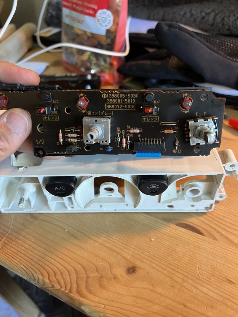

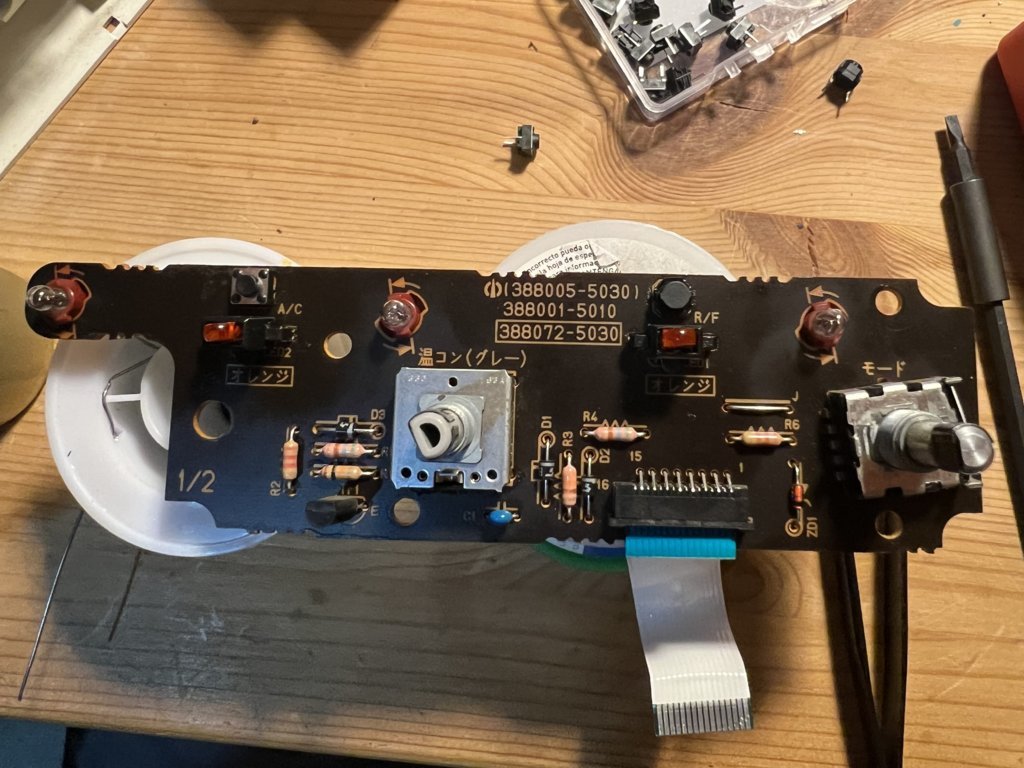

    Update fixed the issue. I was being dumb and did not realize the heater relay would only be triggered on if the blower was on. Once I turned the blower on I got power to the ac fuse. Still did not have power to the compressor though.
    Eventually figured out that the actual AC button itself was bad. Did this through a combination of continuity testing and checking the voltage on both sides of the button. And comparing to the recirculation button which has the same toggle behavior.
    Desoldered/removed the original button from the circuit and replaced with a generic from Amazon. Works fine now.
    If others have this same problem some photos are attached and the amazon link to buttons I ordered is below.
    Button link: https://www.amazon.com/dp/B07WF76VHT?ref=ppx_yo2ov_dt_b_fed_asin_title
    Before button replacement
    After button replacement
