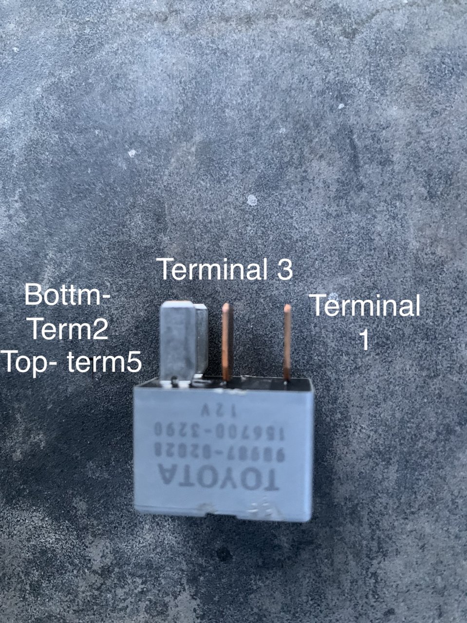

    may be I'm mixing up the terminals. are these the correct terminals (image)? the one I labelled terminal 1(socket), is the one I'm getting the readings from.

    I am talking about reading the relay socket terminals. What you are looking at are the relay terminals.
    Pull the relay out completely. You should see this and as you can see your labels are wrong on the relay image above.

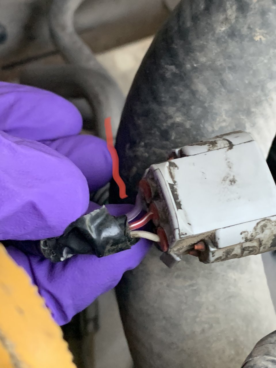

    See the Violet ( purple ) wire attached to terminal # 3 of the relay socket. We need to turn on the AC and check that wire for voltage down on the AC Compressor Clutch Connector if you can get to it. It should read the same as above at the relay 13.67 volts.
    If it doesn't then the relay is not closing or there is a problem with the purple wire. This is either due to a defective relay, the AC Amplifier isn't connecting a ground or the wire is broken

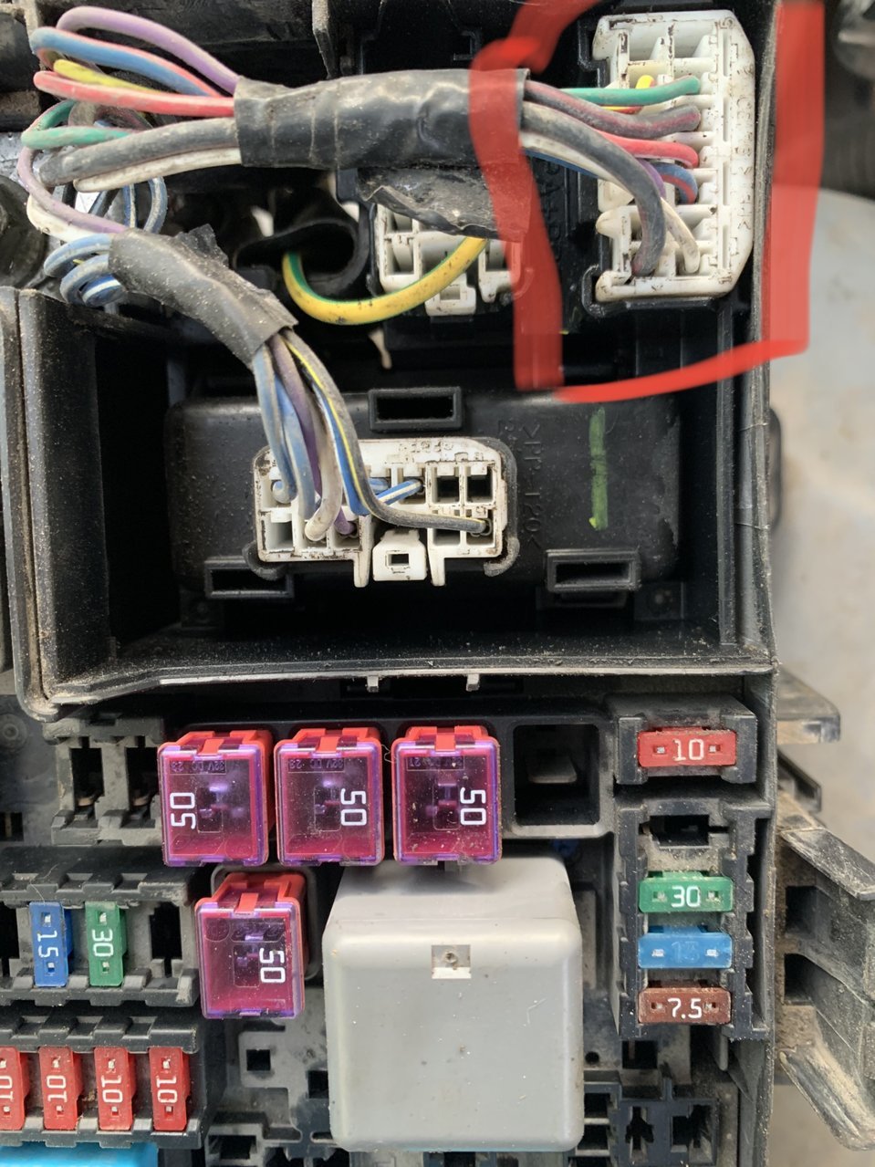

    -Finally, installed the Blower resistor. the ac fan dial is working fine now, but the same problem exist( clutch not kicking in). I guess that wasn't the cause.
    - the purple wire you referring to is it this one? pictures below.
    -I tested for voltage - I'm getting 0.3V.
