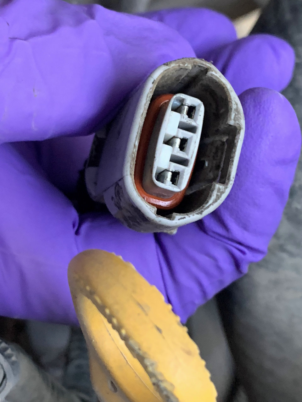

    I have a 2010 4 cylinder Tacoma The AC compressor spins freely without making any noise but the magnetic clutch will not engage. The magnetic clutch does spin freely when I turn it by hand.
    In the past when the clutch has failed I get the blinking AC light in the cabin. The AC light is steady now but the clutch does not engage.
    I read through the blog and here is the testing I have done so far.
    Tested voltage at magnetic clutch relay terminals (inside fuse box under hood) #2 and #5 with AC on: measured 13.2 volts.
    Tested voltage at magnetic clutch relay terminal #3 with AC on: measured 0.0 volts.
    Tested purple wires in two main wire connectors in fuse box with AC on: measured 0.0 volts
    Tested voltage at purple wire socket on inlet side of grey three wire connector atop of AC compressor: 0.0 volts.
    From these findings, can anyone tell me what the next steps in the diagnosis would be and what is the likely failure point(s).
    Thank you very much.

    Have you checked if there is refrigerant in the system? A/C Amplifier won't turn the clutch on if there isn't.

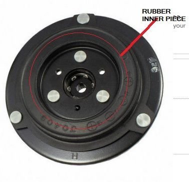

    Sorry to bump and old thread but on these clutch issues. What would cause a clutch to be able to just free spin essentially? It takes 1 finger to spin it easily. My buddies Tacoma takes some muscle to spin.
    I’m also just getting warm air from the vents
