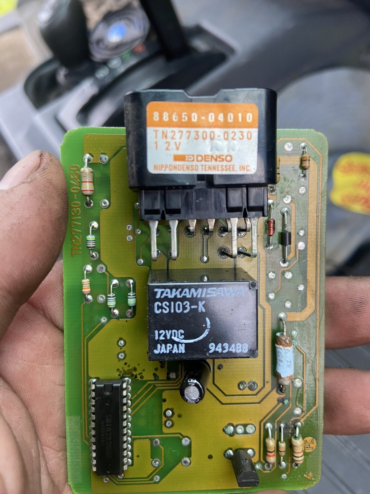

    I think i burnt something on the AC Amplifier. I use to be able to jump the pressure switch to kick on now I cant and doesnt it go through the AC Amplifier to tell the compressor to turn on? heres what my AC Amplifier looks like right now. I pulled it out while trying to figure out why I cant jump the pressure switch anymore.

    I can't see anything from this image alone that looks like its been overloaded, but that can be hard to do. But I will say that you've got multiple points of corrosion on that board. If you have electronics experience, I would test traces in that area for continuity, and test that 2 watt 240ohm resistor. It looks to be in poor health.
    Here's a seller that sells them, should you decide to replace it:
    https://www.ebay.com/itm/125871833775
