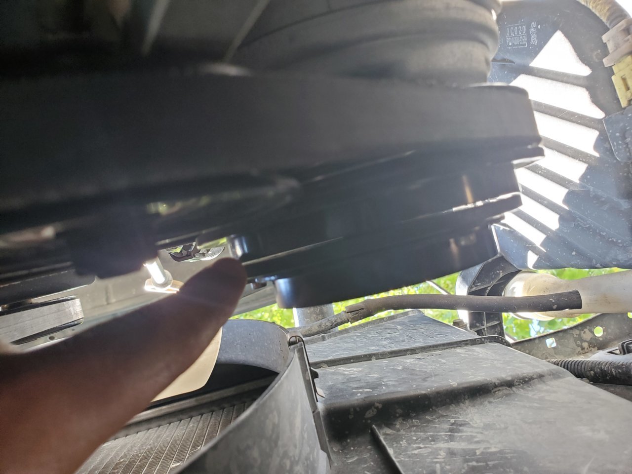

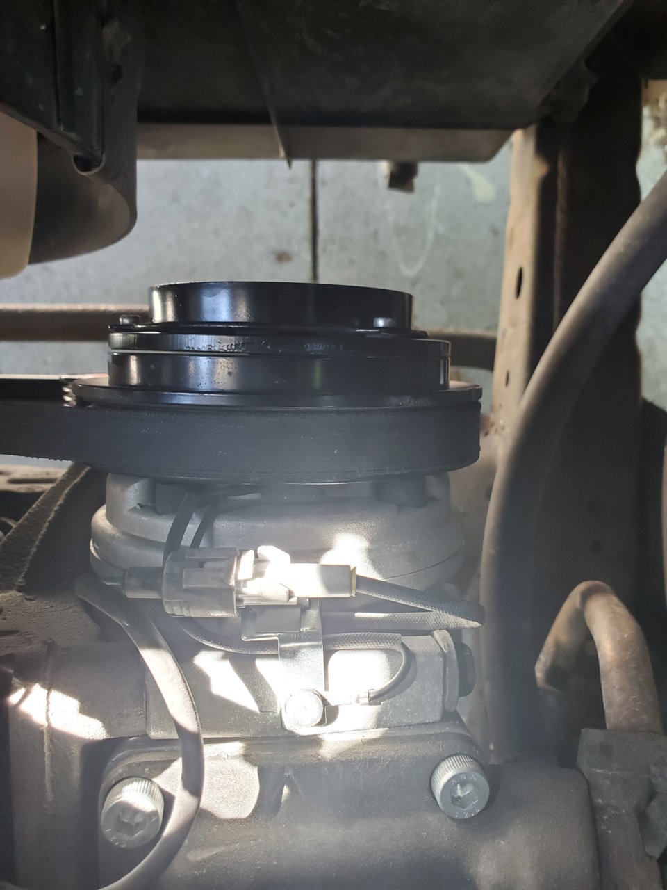

    if the screech is only when the magnetic clutch is engaged I would check belt tension first and if that is ok spray some a bit of carb cleaner, brake cleaner on the belt to see if the screech gets louder, goes away or does nothing different. We are trying to determine if this is a belt issue, a magnetic clutch issue or a compressor issue. Look at the air gap between the magnetic coupler and look at the condition of the faces of the coupler too. I want to say the air gap is .020 to .025 inches IIRC. Yes the clutch can be pulled off and replaced depending on your selection of tools/snap ring pliers. It might be necessary to take the compressor off its mount and swing it or twist it so that you can get at what you need to get at. The 4 cyls are a little easier that the V6 but they all require patience. I this was me doing the job and it was more than 2 years since a coolant change, I would pull the radiator and 2'fer it, now you have LOTS of room.

    Belt tension seems fine to me to the best of my ability. Has small play and then a few extra turns on the tensioner bolt. When I crank the vehicle (AC off) the belt is spinning along without any delay as well as the AC compressor's pully. Then, turning with the ac compressor and producing the noise, the belt starts to stop and go its revolutions every two seconds with a major delay. This is also when the center portion and front face of the AC compressor starts to turn with the belt (I'm assuming this is the AC clutch assembly) also in a stop and go fashion. Center portion referred to can be identified as just below (towards the bottom of the picture) my finger.
    The airgap looks fine to me (estimating something in the 10ths of an inch). The above picture is from the bottom looking up. Below picture is bottom down.

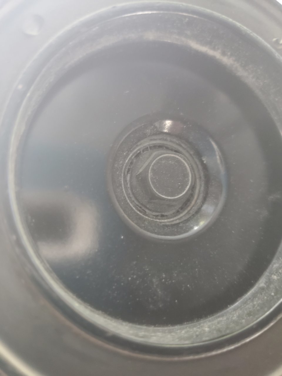

    annnd finally the face, with an almost shiny reflection of my phone case.
    I don't see anything that's jumping out at me. Let me know if you see anything.
    Also, upon recommendation, I can always tighten the belt a fair ways more/crank down on it and see if it will drag it along and stop the noise. As for the brank cleaner on the belt, just spray it on there and see if that affects the noise in anyway? Yeah I can, just to clarify, we are talking about the belt and not any part of the AC correct?
