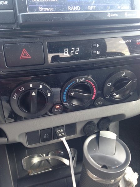

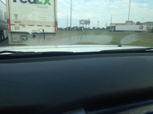

    So for a while now, when running AC. a small ammount of very cold air seeps through my defrost vent, and causes fogging on my windshield.
    Any ideas?
    thanks
    See attached photos

    Is the fog inside or outside the window?
  5. Sep 14, 2016 at 9:21 PM
    NMTrailRider
    NMTrailRider Well-Known Member
    Sep 28, 2009
    #23469
    5,293
    New Mexico
    Condensation on the outside, right?

    The water on windshield is from condensate on the outside of windshield due to window getting cold. you can feel a trickle of cold air constantly coming from the defrost vent. I had the interior fogging on a colorado a few years ago, and it was heater core leaking, so i know what you mean about checking antifreeze and pooling.
    I'm wondering what the vent layout looks like under the dash, and if possibly i've got a bad actuator not sealing off the vent properly. i hate to tear into the dash, or take it to dealership for a nuisance thing like this.

    Mine does the same, but only when its very humid outside and I run the ac on higher settings.

    ^^ yep. I sometimes get this too. This doesn't fix the problem, but I often just turn the temp control down just a tad.

    yes, the only way i can get it to stop is run defrost and turn up warmer, to flood cold trickle with warmer air. It sucks to do that when hot outside, so i end up running the windshield wipers on delay all the time.

    Living in Florida, my windows get condensation on them all the time. Try switching over to recirc, not outside air on the ac , and crack a rear window slightly. Lowering the temp is the only real cure.
