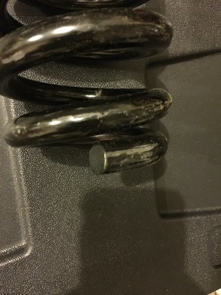

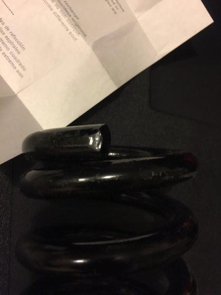

    Morning gents! I bought a set of AC Delco coil springs to compliment my new Billy's that are about to go in. When they arrived, I noticed both ends are rounded vs. tapered like the factories. They came with an advice stating they're compatible, but I'm weary and don't want that rounded edge digging into the seat.
    Anybody have experience or thoughts? Thanks!

    Just a quick thought.....the seat on the 4600's have an offset and appears as if the lower end should fit nicely.

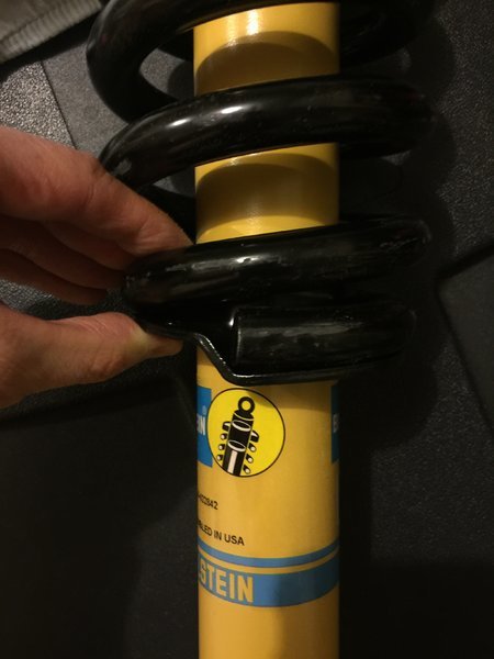

    IMG_5759.jpg I appreciate the insights, guys.
    I can't find the spring rate for them. With that said, AC Delco says these are OE replacements.
    As far as price, the OEM springs are about $350 new....ouch!
    I got the Billy's in today and mock built the strut to make sure the rounded edge sat in the seat okay. It does actually, and very easily.
