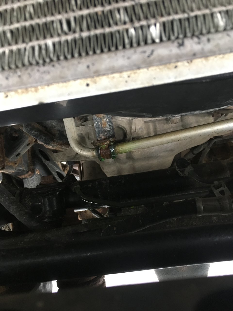

    I don’t know if it’s common, but I had a failure right where a clamp secured the line to the crossmember. I noticed yellow/green drip in the snow and followed it upwards. I hadn’t used A/C in at least 6-months prior, so it was only good luck I spotted the drip.
    6FA70E22-B738-494C-ACFC-B10A66D54681.jpg 528D69AC-056F-4120-8C04-5A2167116B34.jpg

    That looks like the low side. But that’s another good point to look out for failure if the rubber isolator has broken down and it’s now metal on metal.
