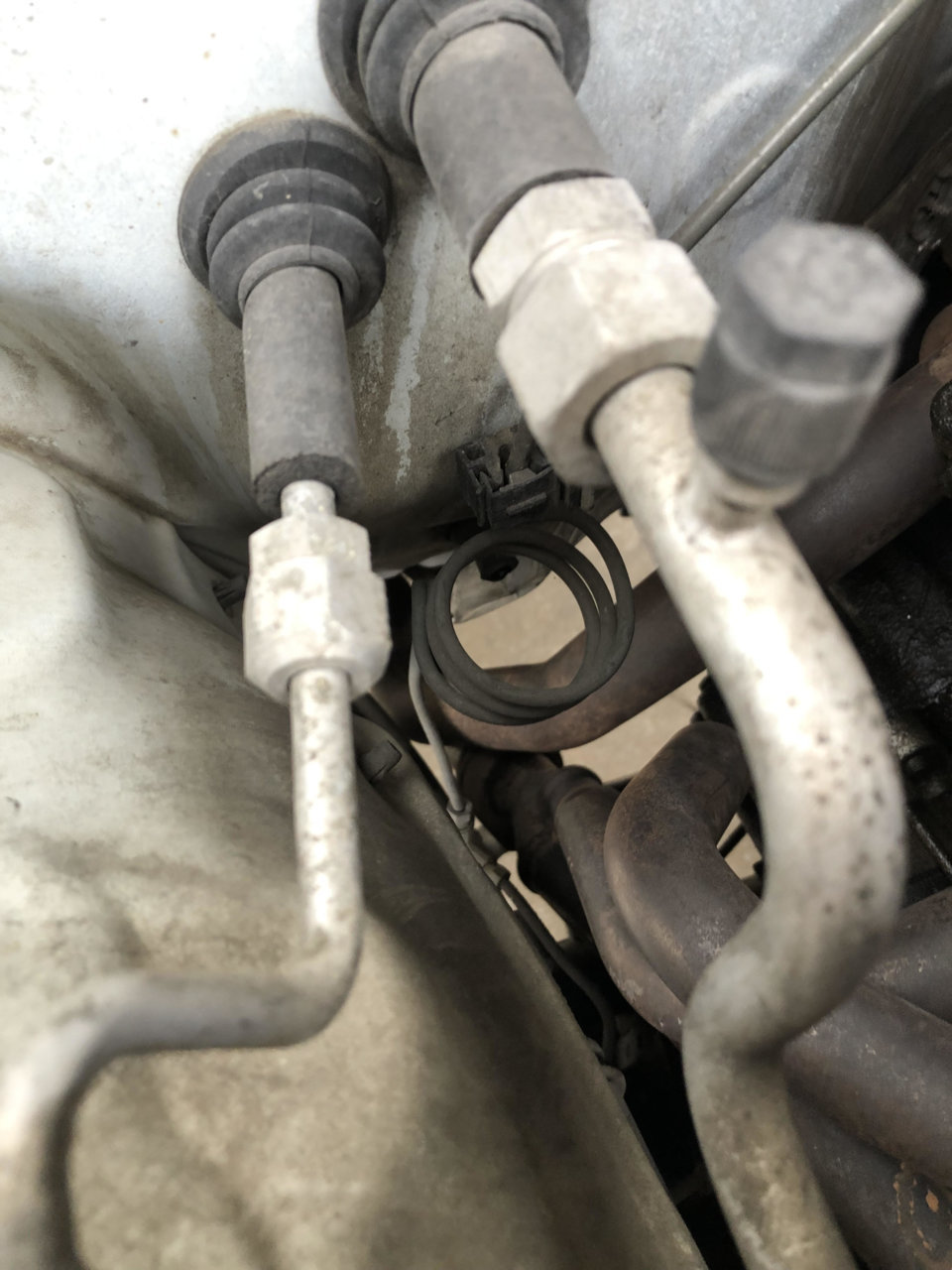

    my issue,
    Any reason it would drip out of that hose port on the fire wall during the winter? (if that is the AC drain hose- condensate drain port)
    on fire wall, actually circled in pic by the coil.
    passenger side:
    I recently just did my water pump and this "new" water leak comes at a interesting time.
  13. Dec 7, 2022 at 5:49 PM
    Black DOG Lila
    Black DOG Lila Well-Known Member
    Jun 14, 2019
    #296344
    9,116
    Virginia
    2003 Tacoma SR5 2.7 5 speed 4WD
    Stock. EZ pass.Dump pass.Inspection sticker.Convict printed lic.plates.FG cap.
    AC runs when defrost is on
  14. Dec 7, 2022 at 8:39 PM
    O'Silver_Taco
    O'Silver_Taco Well-Known Member
    Aug 26, 2021
    #375390
    4,239
    MD
    98 Dlx Sr5 ext AT Rwd
    3rz to 2Rz bebuilt block and new heads
    Its either that or you might have a leak in the heater core.....
    in summer its bypassed.......winter it re-awakens.....
    andywear likes this.
  15. Dec 13, 2022 at 3:23 PM
    andywear
    andywear Active Member
    Aug 23, 2022
    #404167
    44
    Tulsa, OK
    '99 TRD manual
    thanks gentlemen, not dripping anymore and the rad is staying full, ill call it a waterpump/radiator grimmlin and see if it comes back.
