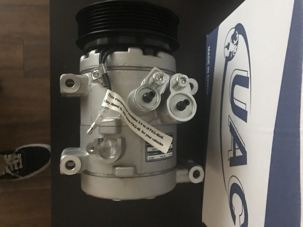

    I did notch it. My ac has always sucked. Recently the compressor started making some noises
    Just got this today

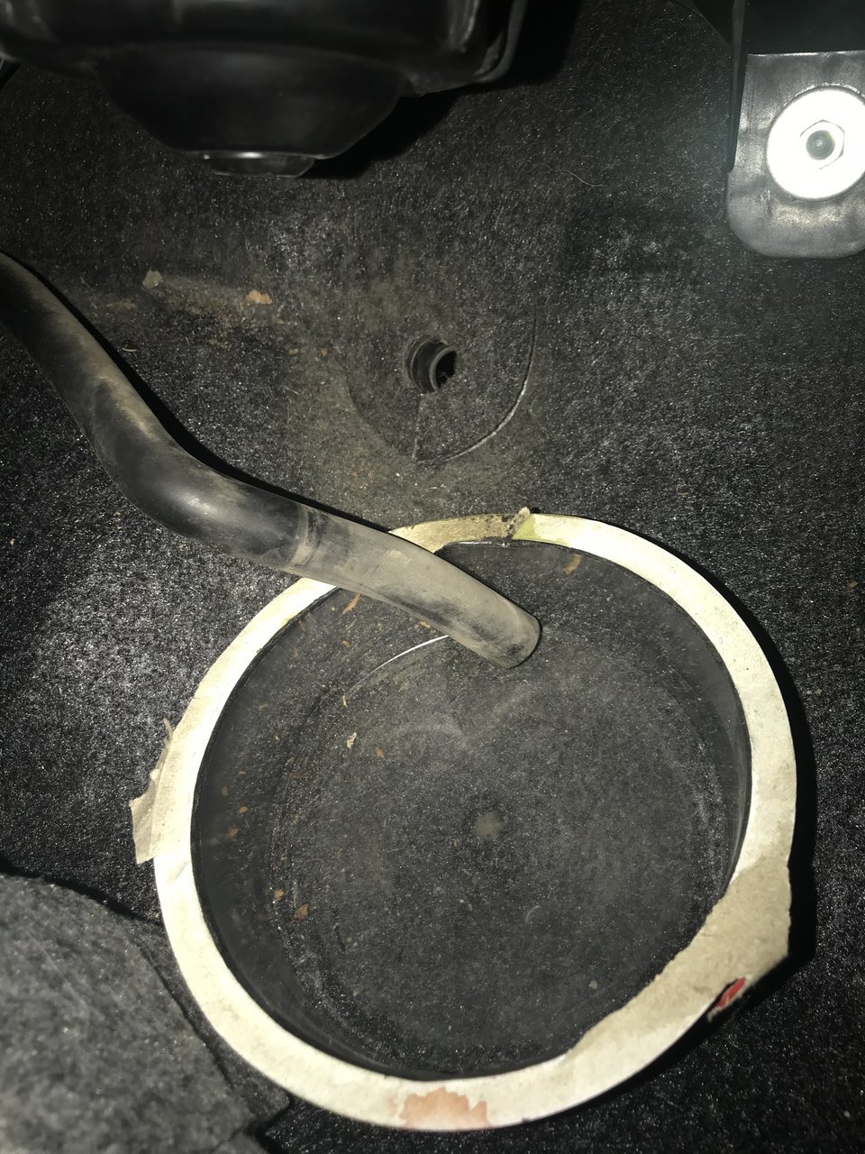

  14. Mar 15, 2018 at 9:05 PM
    anthony250f
    anthony250f [OP] Well-Known Member
    Feb 18, 2012
    #73066
    16,666
    Anthony
    San Diego, CA
    2008 dcsb trd offroad 4wd
    Ok what the hell!!
    Drain tube isn’t clogged, was able to easily blow air in with my mouth.
    Drain tube is super dry and didnt leak a drop. Floor mats never got wet and neither did anywhere under the dash. Ran it for over 15 mins too. I could feel slightly cool air blowing from the drain tube

  17. Mar 15, 2018 at 10:17 PM
    #17
    anthony250f
    Feb 18, 2012
    #73066
    16,666

  19. Mar 15, 2018 at 10:26 PM
    #19
    anthony250f
    Feb 18, 2012
    #73066
    16,666
    Anthony
    San Diego, CA
    My new compressor came with 5.4 oz of pag46. It looks like the ac compressor for a tacoma calls for 5.6
    Think I’ll be ok ??
