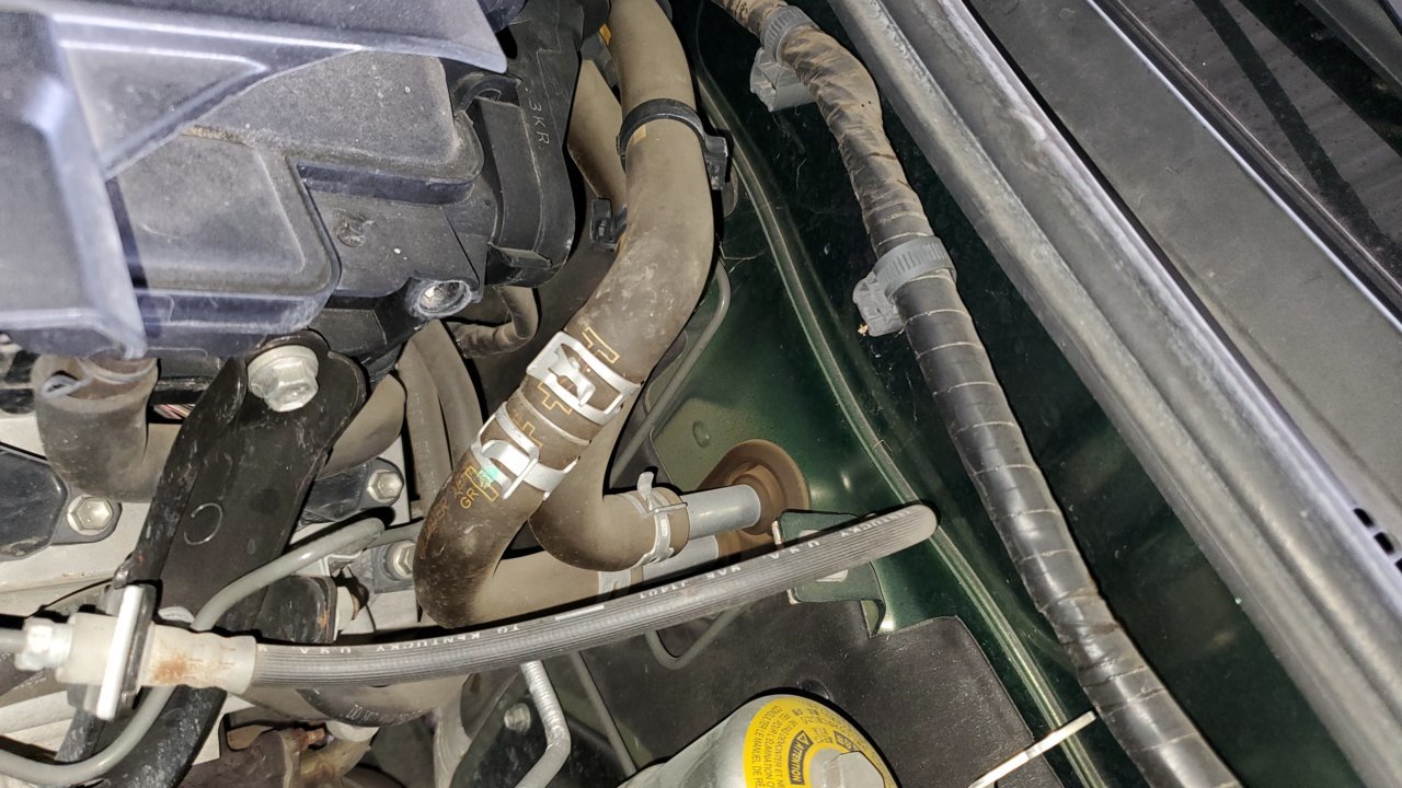

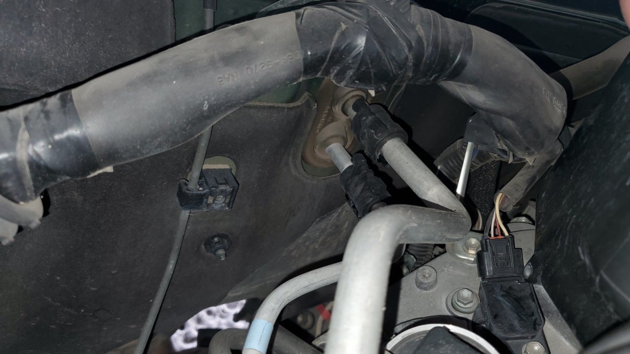

    These are the A/C lines, make sure the system is empty before disconnecting them.

    Yep, that's it! Thank you!

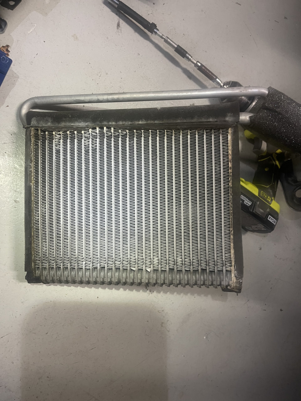

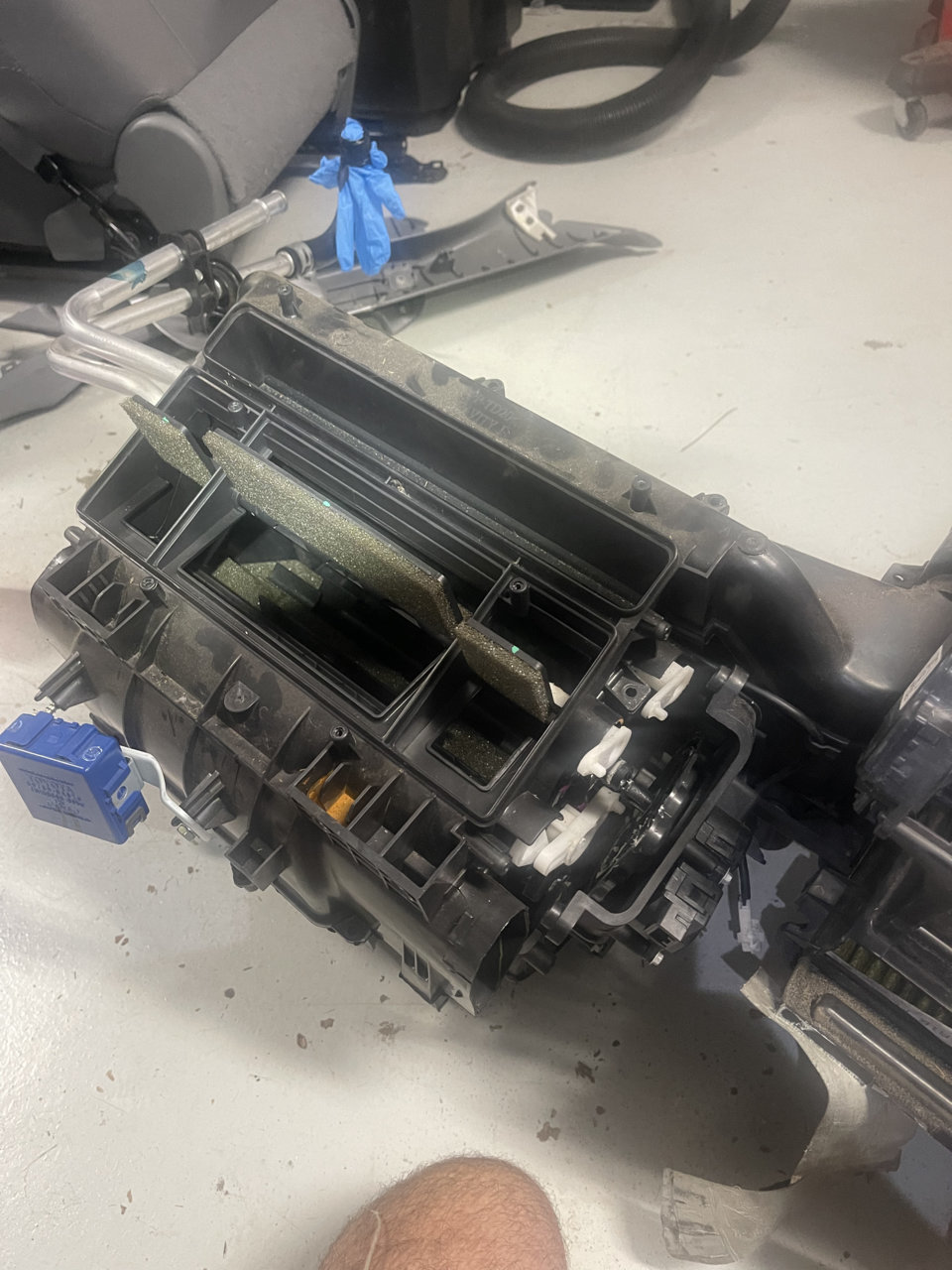

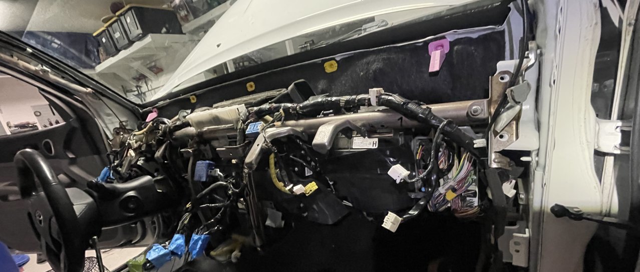

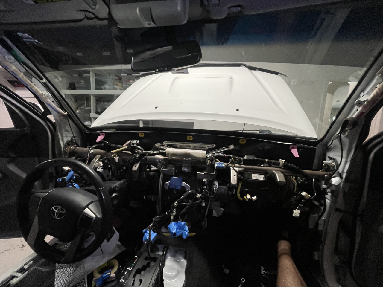

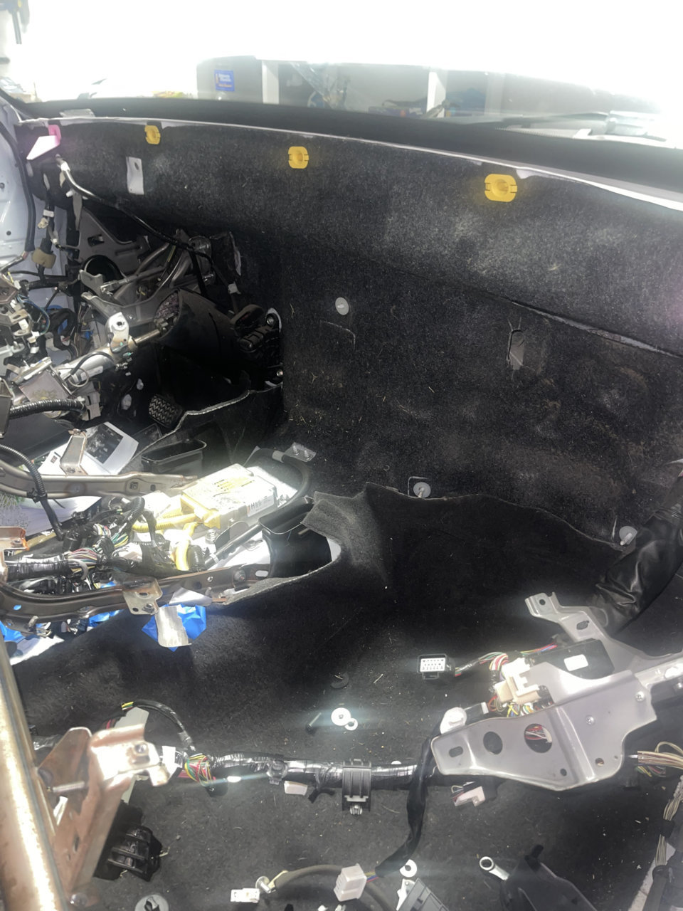

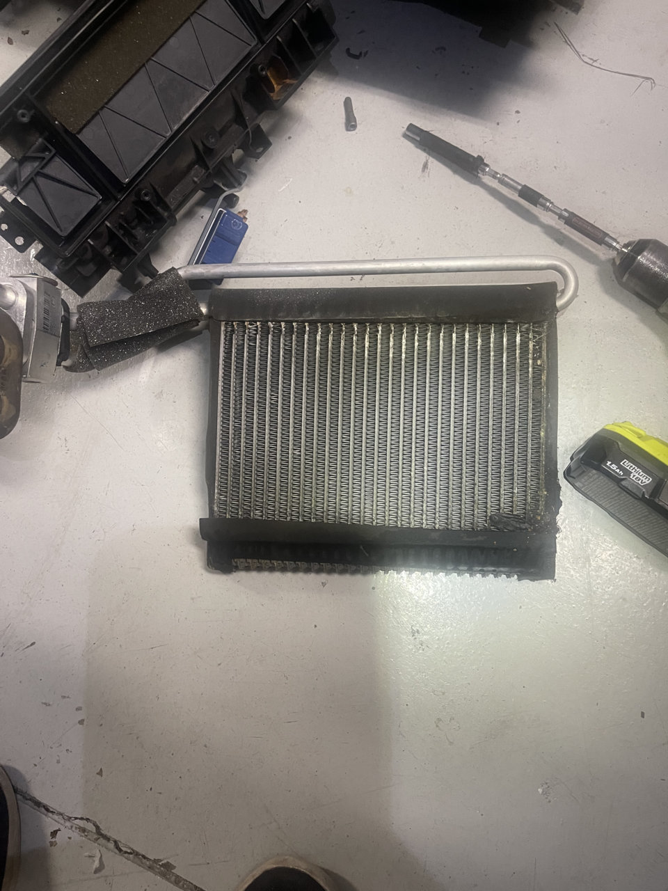

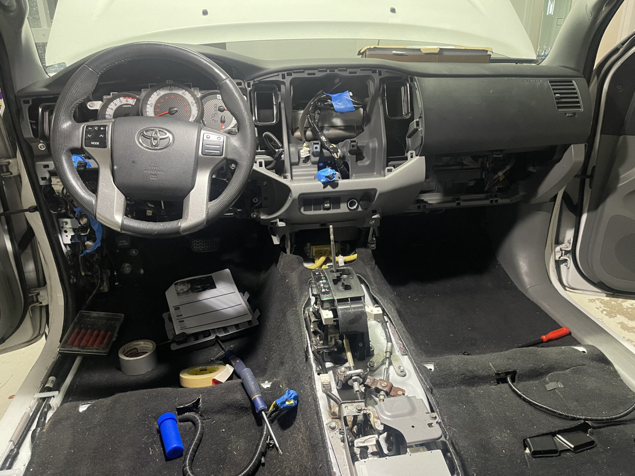

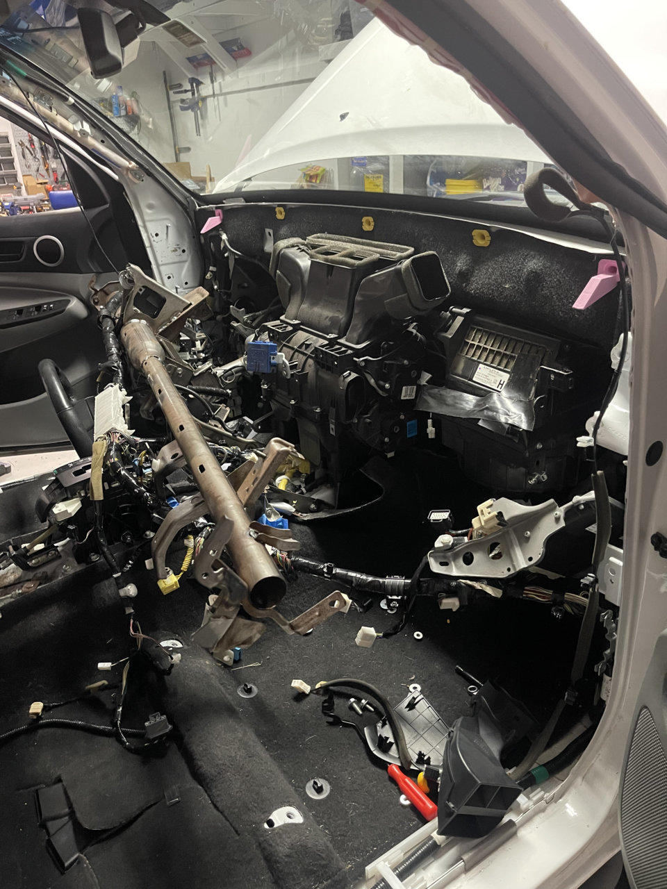

    Well, I've got it all taken apart and replaced the evaporator and heater core. Still have to put the expansion valve on and reassemble this mess. Then I'll replace the condenser. Nowhere near as organized as I'd like it. Let's just say it has been a bit frustrating.
