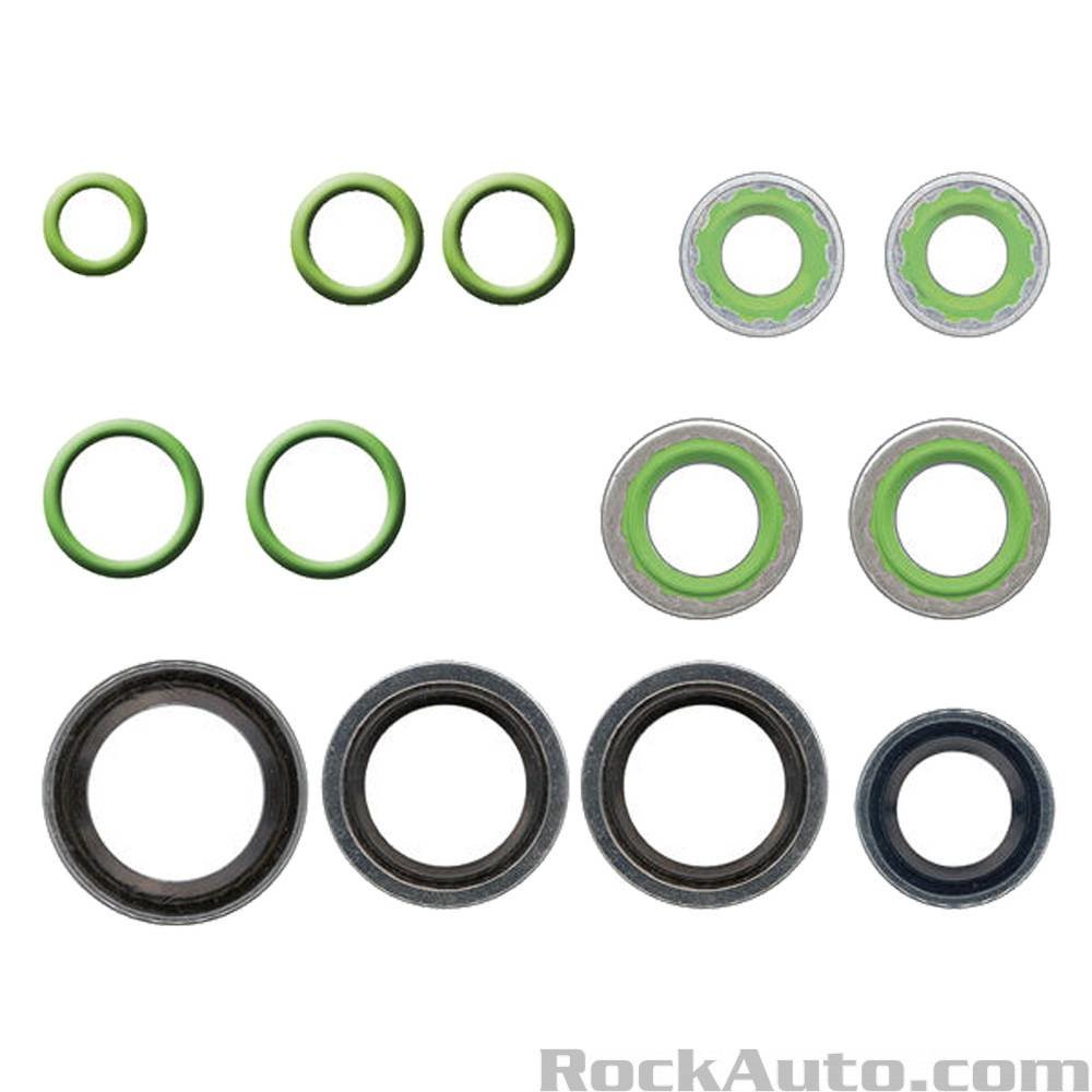

    Can you tell me where the seals and o rings go?
  16. Jun 13, 2023 at 1:23 PM

  17. Jun 13, 2023 at 1:43 PM
    #77
    Sfcmcmahon
    Sfcmcmahon [OP] Well-Known Member
    Nov 30, 2016
    #203721
    121
    Central Florida
    2013 Tacoma TRD Sport 4x4
    These are the seals and o rings I am using. Unfortunately I forgot which seal or o-ring is on each side of the expansion valve.
