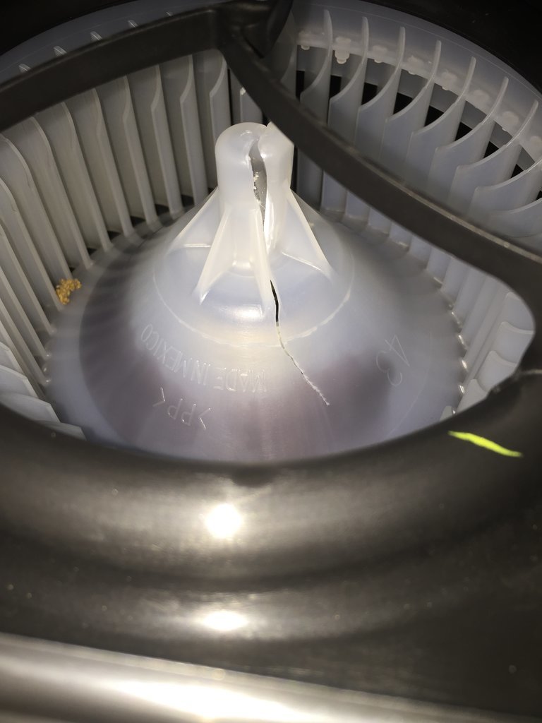

    Before you go, did you pull the AC filter and check things out? May save you a trip of annoyance...........

    Yep it looks cracked in half in the middle of the spindle. Still makes the sound as it currently sits. It's toast.

    Talked to the service rep. Busted blower motor is confirmed. Luckily they have 5 in stock.

    Fixed. Still have the bitter smell when it first starts up but I'll put up with it... For now... My front emblem came up missing after service so they replaced it for free. :mad:

    I have the exact same problem as you. Just happened today.
    I can still run AC on 1 or 2. 3 or higher and it rumbles. They did say this part is backordered and I refuse to drive a rental that's not a truck so I'll keep driving it til they get the part. No idea how long that will be. Here in Austin, TX it is still approaching 90s in afternoon but I think it will be tolerable.

    I just cleaned it up and super glued it and a couple of zip ties and more super glue it is all good works fine.
