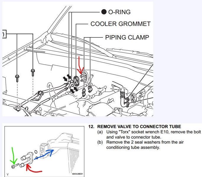

    I also replaced the high pressure hose 2 weeks ago because the connector was leaking. However I planned to replace the small screen filter but I never did because I was in rush and I didn’t want to risk causing another leak.
    Now I think there might be a blockage because my system is still not running as good as before. I’m thinking of changing the filter now. Would you mind telling me the steps? Do I have to remove the expansion valve to get to the filter or is it inside one of the hard lines?

    Disconnect the coupler at the firewall on the smaller line, pull out the screen filter.

    Yes, I highly, highly recommend changing that filter. Mine had very small fine metal shavings coated near the tip of the filter, wasn't much but I'm sure it doesn't take much to restrict the flow in such a tiny cavity.
    You need to remove BOTH the big and small hose going into the firewall to remove that filter. The filter is inside the manifold that the small hose plugs into (not the small hose itself). You need to completely remove both hoses, AND the manifold from the firewall. The manifold must be removed because the filter can only come out towards the rear of the truck (hope that made sense).
    Filter is located inside manifold (RED arrows).
    Filter only comes out one way (BLUE arrow). (Use an E10 socket to remove the bolt (GREEN arrow))(You may not have this socket as it's not common, I had to go buy it).
    It's really not that difficult once you get those round plastic clamps removed. I taped 2 flathead screwdriver bits together to help me remove those clamps.
    Once you remove the hoses you will need to remove the rubber grommet on the firewall to see the manifold.
    I highly suggest replacing those O-rings on both metal hoses as they are known to leak. There's 2 on each hose.
    Larger hose O-rings part #: 90301-A0006
    Smaller hose O-rings part #: 90301-A0012
    Good luck. See pic below for arrows and location of parts.

    That's not where I thought it was. I thought it was in the tube just before the manifold. This is not the first time I've been wrong, nor the last. Sorry for the bad info.

    Thanks I appreciate your very detailed information.:) I’ll try to attempt it next weekend when I also change the condenser.

    @CurtB no problem. I also made the assumption that it was in the small hose too and was perplexed that it wasn't in there and thought maybe toyota forgot to install one. Had I not planned to replace the expansion valve, I would've never taken apart the manifold to find it inside there. Funny thing is I was trying to figure out how I was going to shove the new filter in that small hose. So glad I didn't try it lol.
