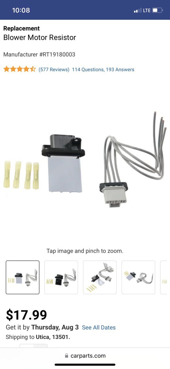

  9. Jul 31, 2023 at 7:15 PM

    That will probably work fine.
    But that isn’t the updated one.
    I’ve not seen the updated resistor and connector sold as a package.
    So you may have to buy them separately. That is if you want the updated parts?
    The ones you linked will probably be fine though.
    The updated parts are in the link below.
    https://www.tacomaworld.com/threads/2nd-gen-information-diagnostics.784008/#post-28042158

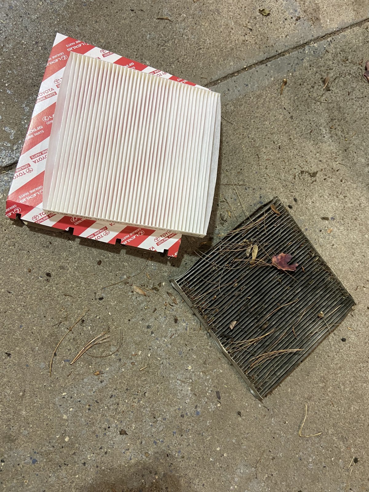

    Thanks for the help, picked up parts from the dealer. From the videos it looks like we’re on the third or fourth version of harness/resistor combination so splicing the harness is the slowest part of the task. Replaced cabin air filter while I was in there…shame on me. IMG_4074.jpg
