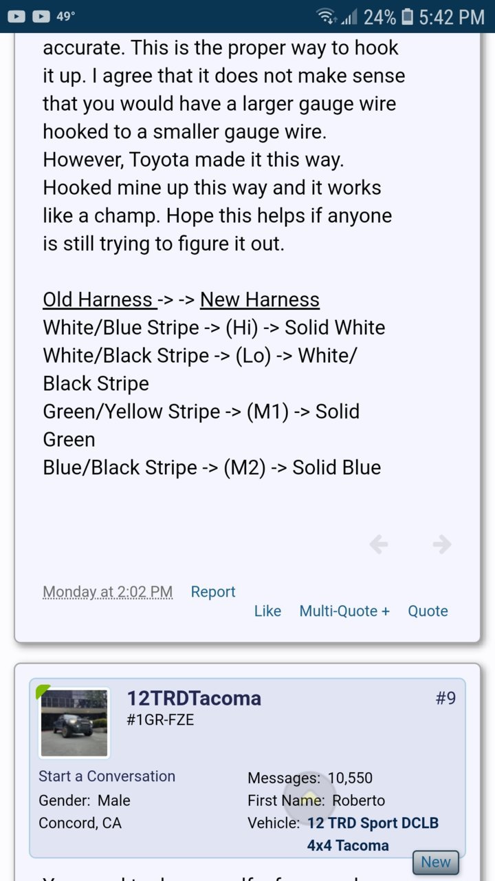

    Noticed this morning, my fan is not working on low..med..med high...but is on high.
    Pretty sure it worked the last week or two when I cut it on..I know it did last month..had the AC on low..med...
    Any ideas? Switch?

    It is the blower motor resistor/plug. You need this from Amazon, it comes with both parts. The new plug needs to be spliced on. Here is the simple wiring diagram. This has been happening off and on to me for months. I just did this and it fixed it. The new resistor is different than the original, so hopefully it never burns up again Screenshot_20191003-174242_Chrome.jpg
    Genuine Toyota 87138-04052 Blower Motor Resistor

    I fixed it yesterday... Skiergd hooked me up...got my package Sunday morning from Amazon

    How easy is the R&R? (Remove and replace) Thanks gents!

    Simple job...the back screw kinda hard to get to..lol...
