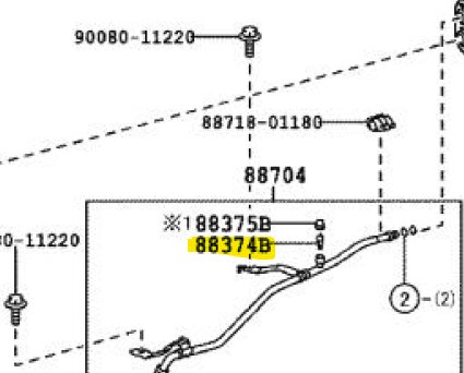

    I try to purchase OEM parts and am trying to find the Schrader valve(s) for my 2013 prerunner 4.0 auto.
    Do you happen to have an oem part number and are the high and low valves the same size?

    I had trouble finding the OEM part number when I did mine so ended up getting the Four Seasons part 26783 for my 07. They valve cores were the same on my truck.
    But here is a screenshot of a parts manual that shows the partial part number which may help you:

    This looks like the correct part. Thanks man!
    Toyota 88374-04030 Valve, Service
    2008-2016 Toyota Tacoma 8837404030
    $20.52

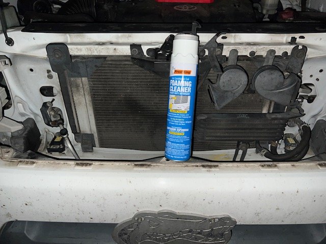

    Doing the UNI, engine & cab filters tomorrow and will include visual/cleaning of the radiator and condenser. Great reminder TT1.

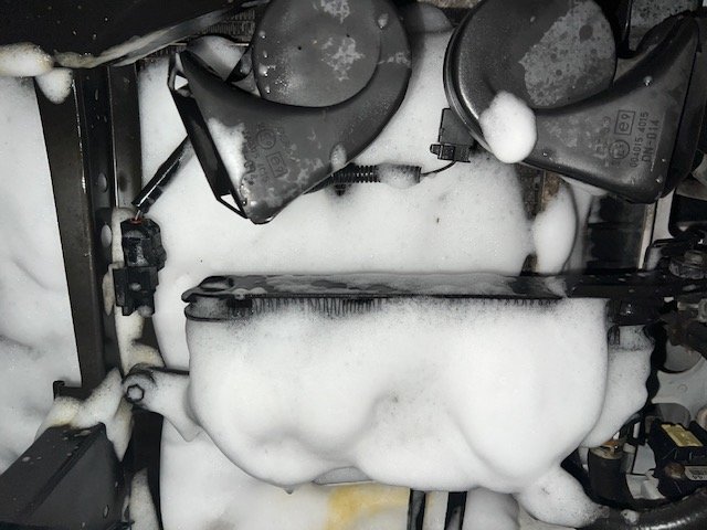

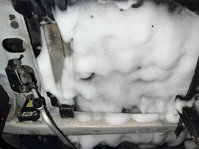

    early start today
