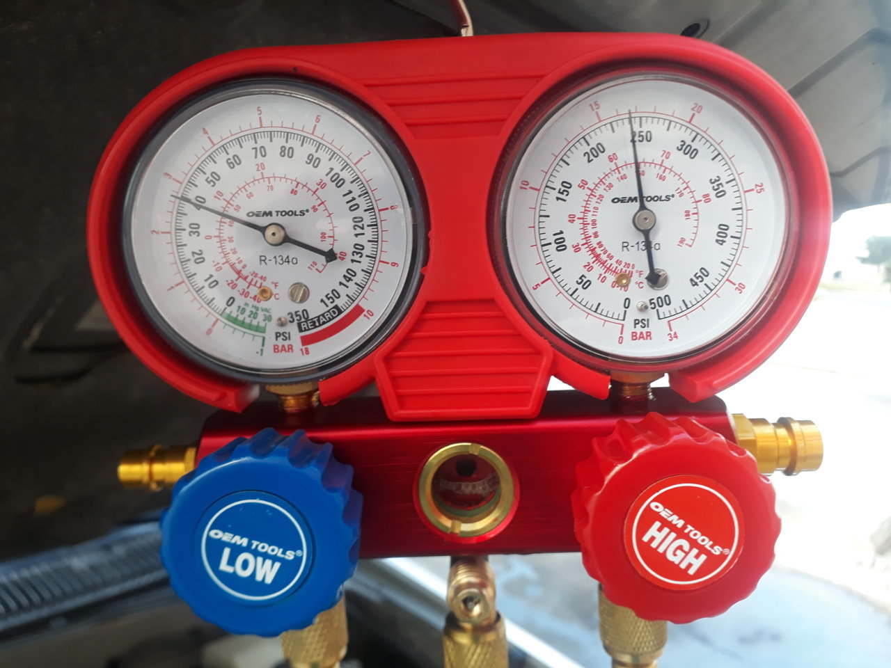

    Where should these be at i have a small leak in my 3rd gen 4 runner and need to refill it periodicly
    Im going to try a stop leak additive since thats what my tacoma had that blew ice cold ac for longer than i was alive without a single recharge
    The FSM I found online simply states to add refrigerant till the sight glass in the reciever drier doesnt have bubbles
    which it doesnt but, that doesnt seem very scientific, while it gets nice and cold now it still takes a short drive to get there wheras my tacoma had ice cold ac in less than a minute every time

    Depending on outside temperatures. But 220-250psi on the high side and 30-45psi on low side is average.

    Yes... but on my tacoma with my inferred thermometer it read 22 degrees
    I have the same thermometer still so if it was inaccurate than it will be inaccurate now

    What temps are you reading now?

    Low 50s high 40s

    Have you checked pressures?

    I only did what the fsm said and added till the sight glass was bubble free than returned the gauge set as i already had it for a week (never got around to it) and didnt want to own it
    Ill leave and borrow it in the parking lot

    Went back added a bit more and shes nice and cold

    Is that at an idle? Might have a touch to much in it.
