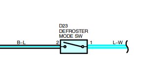

  6. Jan 12, 2025 at 7:42 PM
    Dm93
    Dm93 Test Don't Guess
    Mar 3, 2015
    #150066
    13,816
    Texas
    2014 DC OR 6spd 4x4
    Predator tube steps, Ranch Hand grill guard, Magnaflow CatBack exhaust, Toyota tool box & bed mat, 2LO Module by @Up2NoGood, Rearview Compass/Temp Mirror, Tune by @JustDSM.
    Just unplug the Defroster Mode Switch.

  7. Jan 12, 2025 at 8:37 PM
    taco2uesday
    taco2uesday [OP] Well-Known Member
    Jun 18, 2020
    #331856
    775
    1999 Tacoma SR5 TRD 5 Speed
    Map Lights, Grey Wire Mod,
    Thank you! Is this right behind the panel?
  8. Jan 12, 2025 at 8:39 PM
    Dm93
    Mar 3, 2015
    #150066
    13,816
    Texas
    2014 DC OR 6spd 4x4
    I believe so.
