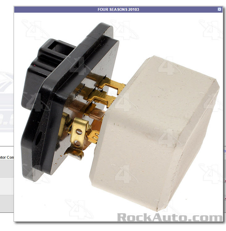

    Looks like this is the part... the clay/ceramic looking piece would be on the inside of a air pathway most likely.

    That's an odd looking thing. Just gotta find it now. I'll keep searching. Thanks.

    You're welcome! Looks like it is in or around the part that you would remove to pull the fan... the black part from the picture is what would be visible with a wiring harness coming out of it.
