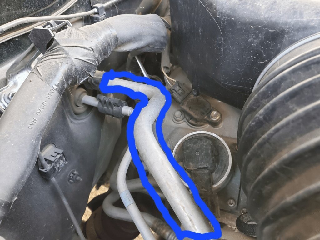

    That's a classic sign of low refrigerant or other problem in the refrigeration side of the system.
    You can check the suction line with it running, it should be pretty cold. If it's not you have an issue with the refrigerant side of the system and should have it checked.

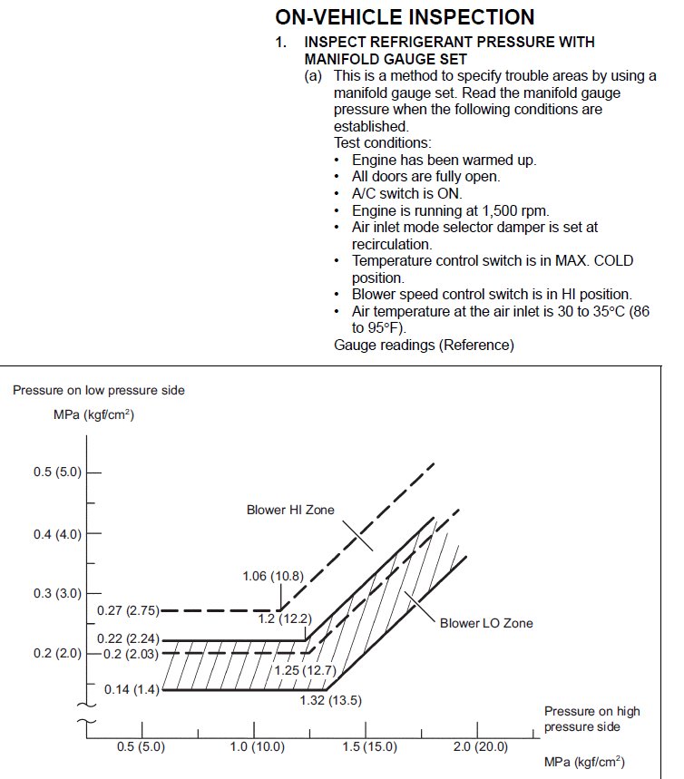

    in a repair shop, the minimum first step is to perform a recharge and determine what quantity came out.
    this is done automatically by the machine. You press a button and walk away. It takes about an hour.
    After that, you begin to evaluate.

    I suppose that is at least one way. I have always just approximately followed the guidance in the repair manual myself... I guess I didnt make that clear perhaps
