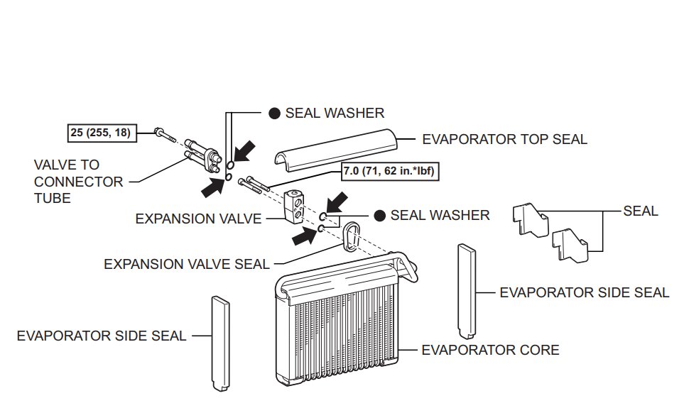

    You can replace the expansion valve without ripping out the dash etc.... See this post (#6) with pictures:
    https://www.tacomaworld.com/threads/ac-compressor.796628/#post-28547145
    gotoman1969 likes this.
