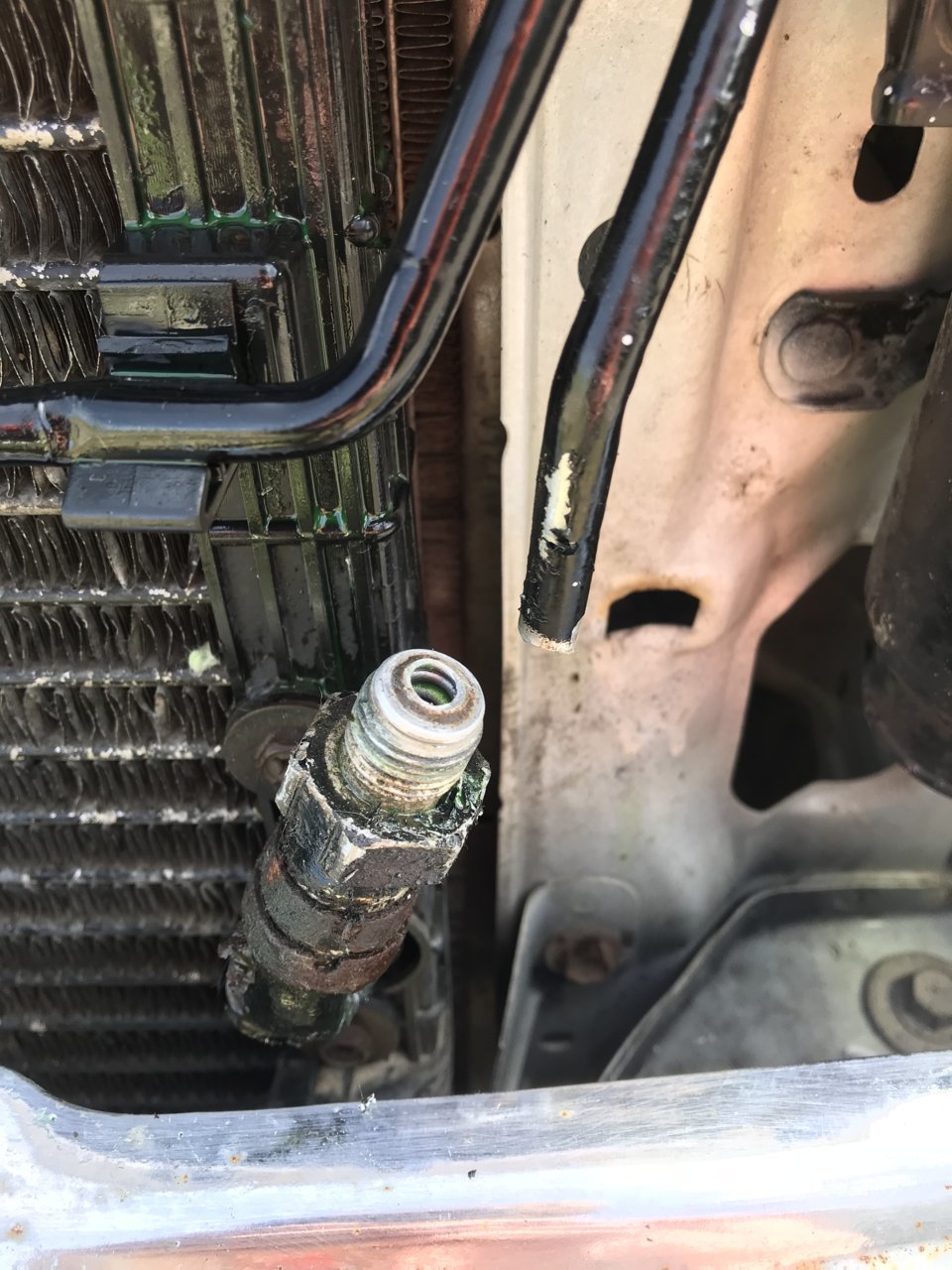

    Best thing you can do is remove your grill and check your AC lines that are the most accessible (the ones infront of the condenser) and see if you can hear or see any refrigerant coming out of those lines. I got lucky with my AC system because it was one of those lines up front and I was able to replace it with a line from the salvage yard. As you can see in the photo here, once I took the flange bolt off there was a crack right where the flange bolt goes over. That’s where I would start honestly.
