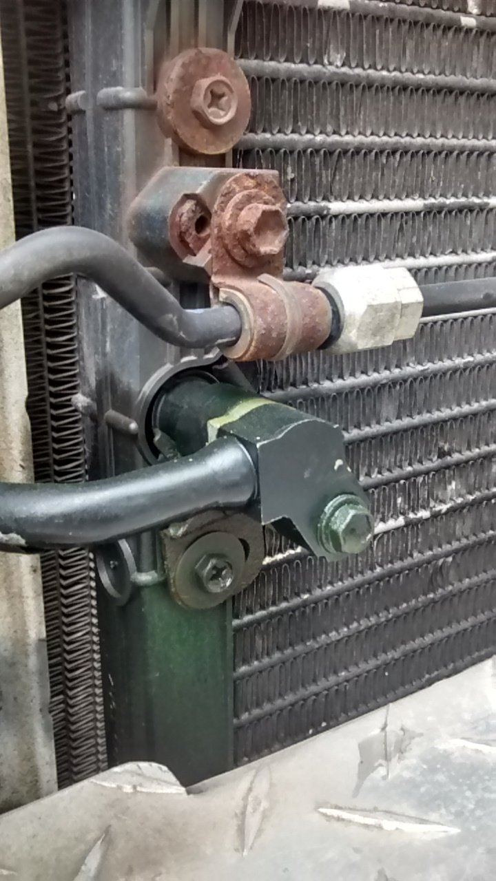

    The high (smaller) line is cold, but not to the point of getting condensation on it. As for the heater control valve, the mechanism is working good.
    I've removed my grille and I've found a leak right there:
    Seems to be coming from the square aluminum fitting.
    And for those who asked, no I didn't use a recharge kit. I had it refilled at a local shop (wasn't much expensive than the price of a kit). It's weird because should'nt they have seen it when refilling the truck? It is quite an obvious leak...

    Our laws are if you bring it to a Shop the first thing after testing pressures if the system is low is test for leaks.
    Just because you found one leak it does not mean that is the only one.
    Looks like they just put the gauges on Topped up the system called it good for what you paid .
    Since a few days later it no longer worked .
    Best of Luck.

    Like I said, tools and stuff aren’t always necessary to fix things. It’s amazing what a good visual inspection will reveal. All that green dye would be screaming at you under a black light, but is still clearly visible without one. Now I’m concerned about that high side line being cold. Is it the same line that’s leaking, but it looks like the leak is at the condenser? If so, I would expect to find a restriction in that line. The high side hoses should be hot, when the system is full, the high side hose between the compressor and condenser should be the hottest, then the hose from the condenser to evaporator should also be hot but technically not as hot as the compressor hose. The high side line from the condenser to the expansion valve at the evaporator, just beyond the fire wall, should remain hot all the way to the expansion valve. The expansion valve is what separates the high side from the low side. Only after the expansion valve should the lines turn cold. If a high side line is cold, with the system full, follow it back to the compressor. The point where the high side hose goes from hot to cold indicates the location of a restriction. In that case, the restriction in the line is acting like an orifice tube. Unless of course it is an orifice tube system, but I think our trucks are expansion valve systems, but I could be wrong. In an orifice tube system, this would be normal, and you just located the orifice tube, at the hot to cold point.
    If it is indeed an expansion valve system, like I’m assuming, a restriction would cause the high side pressures to be very high with the system full. This could be what in fact blew the o-ring at the connection in the photo. It appears to have a blown o-ring, but could be cracked. FYI there should also be a pressure relief valve on the compressor that will vent extremely high pressures to the atmosphere in the event of a restriction, it will do this to prevent an explosion, or rupture. If this valve looks like it has popped off, there will be green dye and oil everywhere around it, I would definitely be looking for a restriction. In either case, your next step is to fix the leak, charge the system and check pressures. Time to break out the tools.

    Bought a UV flashlight today and oh boy do I have a massive leak at the compressor gaskets, plus the one at the condenser fitting that I found ealier. Yep, there is my problem
    Again, weird that they didn't see it when filling the truck. As pointed out above, they probably just topped it off and called it good

    O-rings don’t just blow out in multiple places at once. I have 281k miles on my truck, and the a/c system has been opened to clean the airflow portion of the evaporator, I reused all o-rings and it doesn’t leak and works great. Do yourself a favor and while you have the system open, disconnect all the high side lines and blow compressed air through them. Even easier just unhook the small diameter high side hose at the fire wall and blow air through the complete high side all together, from the back of the compressor, through the condenser, to the evaporator. Air should flow through the open lines without any resistance. Put a towel on the side the air will be coming out to catch oil and mist. This will save you the cost of a shop pulling a vacuum then charging the system, it will also tell you if you have a restriction, or collapsed hose. O-rings that are not damaged can be reused. That is if you plan on fixing the truck yourself.
    Example, at work I had a truck in that had a melted compressor clutch. It’s just as easy and sometimes cheaper to replace the entire compressor and clutch rather than just the clutch. That is what we did. I removed the compressor and capped the lines so the system wouldn’t be open over the weekend. I was off the following Monday, and a different technician installed the new compressor. He saw the plastic plug in the low side hose and removed it, he didn’t notice the plug in the high side hose. He put it together and charged it. The air conditioning worked great, because initially the compressor just blew a hole in the plug. After a few days it came back with leaks in multiple places, including a ruptured line. The plug came un lodged, and was pushed through five foot of bending steel line. It jammed and dead head plugged the line where that steel line connected to a rubber hose. The truck then had multiple blown o-rings and a ruptured line, that was not like that when the compressor was replaced just a few days before.
    Just a scenario to show that anything can happen, hard to say if the leaks were there on your truck while it was in the shop.
