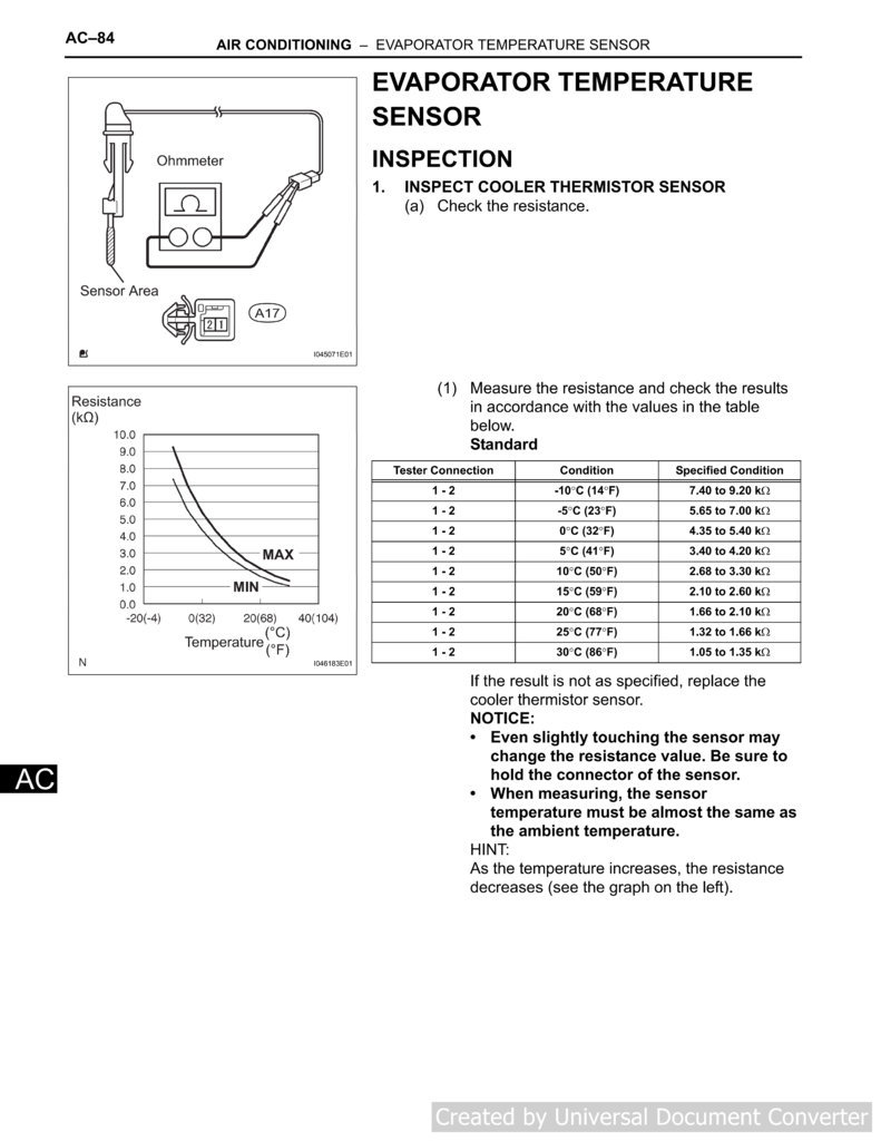

    Sounds like the A/C Amplifier is shutting down the A/C on purpose, if you had an issue on the clutch or Lock Sensor side you would get a flashing A/C light when it shuts off.
    My primary suspects to check would be the Evaporator Thermister and the Dual Pressure Switch.
    The Dual Pressure Switch should stay closed under normal conditions and only open if pressure on the liquid line drops below 28 psi or goes above 455 psi.

    Thanks, the pressures are well within the ranges listed and air is super cold when operating I will try the evap sensor and see what i find there.

    Intermittent issues are the worst to track down, like ai said I'd investigate the pressure switch and evaporator thermistor circuits first as those are probably the easiest to check.
    The A/C Amplifier is behind the glovebox in the middle looking straight up.
