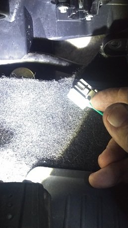

    Your fan could of just died. An easy but risky way to check is to pull your cabin filter and with the fan turned on, try to "kick start" it by flicking it to get it spinning. Be careful as the fan can move fast and cut you if it starts.
    The more scientific and proper way is to go to the connector for the fan under the glove box area. Should be a two wire connector and check from varying voltage with either an incandescent test light or voltmeter. If you can leave the fan plugged in and touch the metal terminals on back of the connector that is preferable to unplugging it and checking from the front.

    Interesting so with that information I have two ideas. Either the fan is dead or the thermostat for the A/c is dead and not disengaging the a/c compressor which is allowing the evaporator to freeze which is blocking your airflow. If it's the later then everything should be working fine for a bit since it would of thawed out

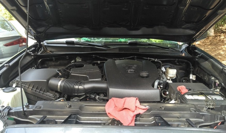

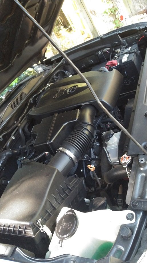

    here's some pics of the engine. Y'all can see what I mean by saying the dealership appears to have done all the fluids maintenance plus detailed the engine compartment.

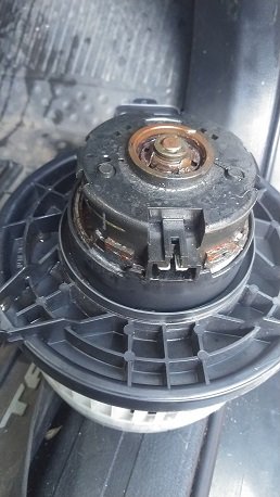

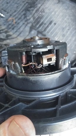

    Aug 11 PM: I just went out and removed the cabin air filter as well as the blower motor. Before I unbolted the three hexhead screws that hold the motor in place (5.5mm socket and lucky me I had one), I removed the pigtail from the motor and tested it with my deluxe Harbour Frate multimeter. Yep, it had full power to it. So that meant the culprit was the blower motor, the resistor assembly or the FluxCapacitor(tm)
    I removed the blower motor shroud and about 6 ozs of water came out. THen I removed the blower motor from the shroud and more water dribbled out. WTF!
    I came inside and immediately ordered from Scamazon the blower motor ($55) and a resistor assembly ($18) - I am not certain my Taco takes an oval resistor assembly but I ordered it anyway, figuring before I remove it from the box, I can first see if my Taco uses this part. If not I can return it - Prime gets both parts here two days from now by Wednesday. I first tried sourcing it at NAPA, Advance, AutoZone and OReillys but all of them were at least 2 days out or longer and all wanted $109-$129 just for the motor.
    DUMBASS QUESTION OF THE DAY: Where is the Blower Motor Resistor Assembly located and how do I determine if my model Taco needs this part? It's a Tacoma 2019 TRD OffRoad 2WD V6-3.5L ALSO - If I am getting power at the pigtail that clips onto the blower motor, does that mean the Resistor is okay?

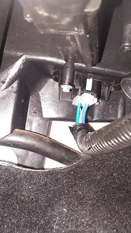

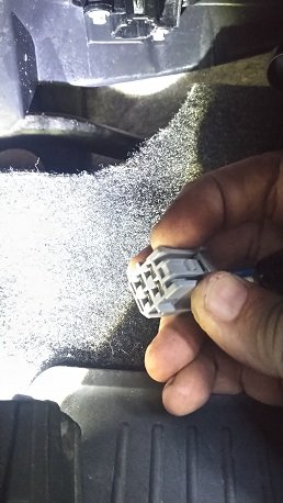

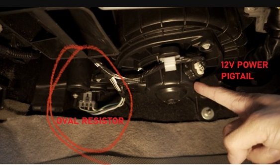

    Okay, I answered one of my questions - where is the resistor located?
    Here's a pic from another person's thread on here. Very helpful. You can see the oval-shaped resistor assembly that these repairs often refer to.

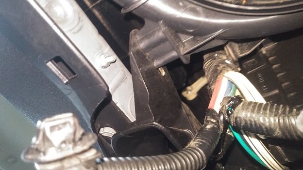

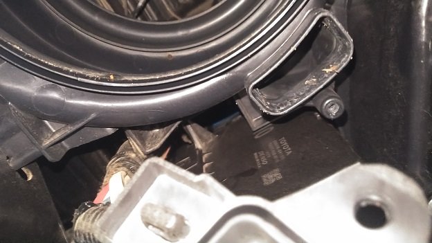

    But here are the pics from MY Taco - the best Birria Taco ever. As you can see, this Resistor Assembly is rectangular-squarish. It is in the same location as the Oval Resistor. Now I'm wondering what the heck P/N Part Number is this thing?

    Ideally you should check for power with a load. Meaning either backprobe the connector while on the motor or at the least use an incandescent test light. You're probably okay here but I almost got myself at work last year like that.
    Multimeter showed 27volts (Komatsu Wa600 loader so 24 volt system) at the compressor plug but when I ohm'd the compressor to verify I saw an okay reading there too. Jumping power to the compressor also showed that the compressor was fine. I backprobed the connector and plugged it in and immediately lost power. It wouldn't even light a peanut bulb for a license plate but the multimeter showed 27 volts. My actual problem was a bad relay with corrosion inside.
    If I only relied on the meter's voltage reading at the plug I would of wasted alot of money and time replacing an a/c compressor that wasn't needed.
